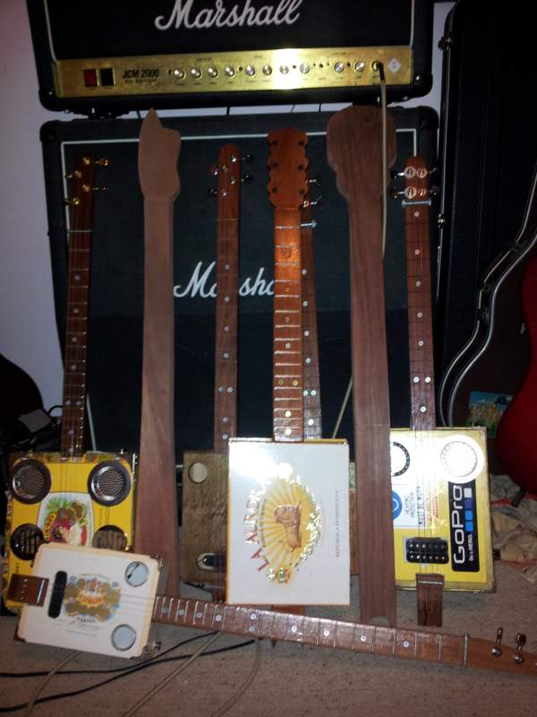

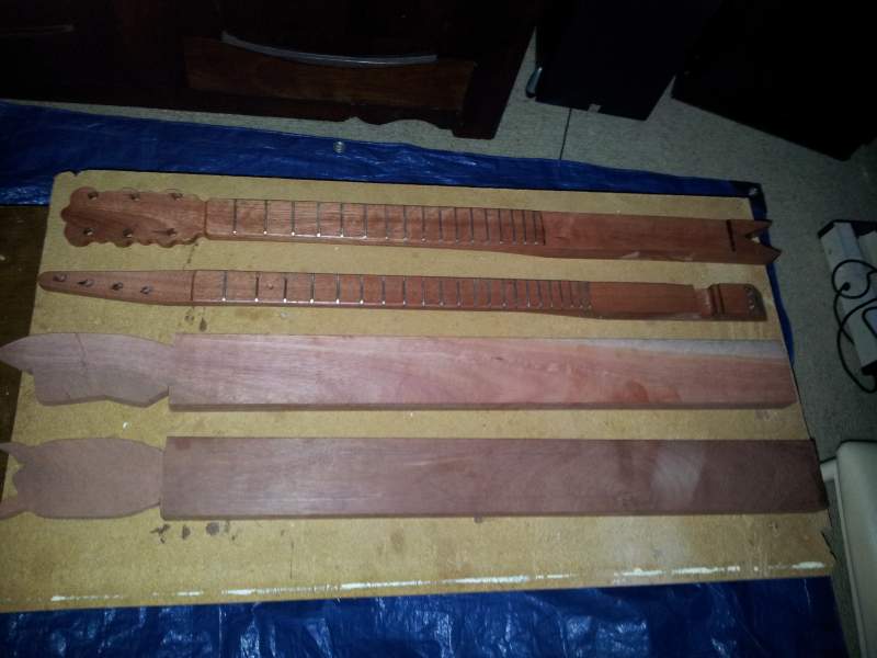

    I've made a dozen or more CBG's and used jarrah from the big green shed, think I bought a 1200 x 40 x 30 piece and that is strong enough for a 4 string CBG, make the neck a bit thicker if you intend using heavier gauge strings ie usual E A D G strings from a 6 string guitar. There was enough width to cut a fall in the headstock.
    Attached are some of the necks/CBG's I've built and some are 80mm wide pieces of jarrah for a wider headstock and 6 string CBG's.
    I have many more pictures if you require them.
    These were built almost 3 years ago. Cut the box to fit the neck flush with the cigar box top and you just need to route part of the neck to fit the pickup
