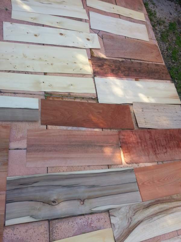

    Hey Robin,
    we got a few mixed bags of veneers from Huon Pine Furniture http://www.huonpinefurniture.com.au
    They are based in Tasmania.
    They were at the Perth wood show in August. There was about 8 different varieties but they should be able to supply veneer for the size of a tele top.
    I just use tightbond glue but you will need a heap of clamps when gluing it on so it stays flat. I'd suggest putting a sheet of wood over the veneer when you glue it.
    Sure some of the Bris Vegas boys have suggested some local or Qld veneer suppliers but can't remember them.
    Can't go past the grain in the blackheart sassafras, the sheet front left of the attached photo and same slab my scratch tele is made of. Looks sensational on headstocks too ! Front right is camphor. Spotted one 6th on right is red myrtle
    Good luck mate
