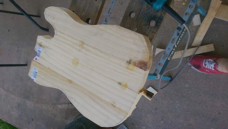

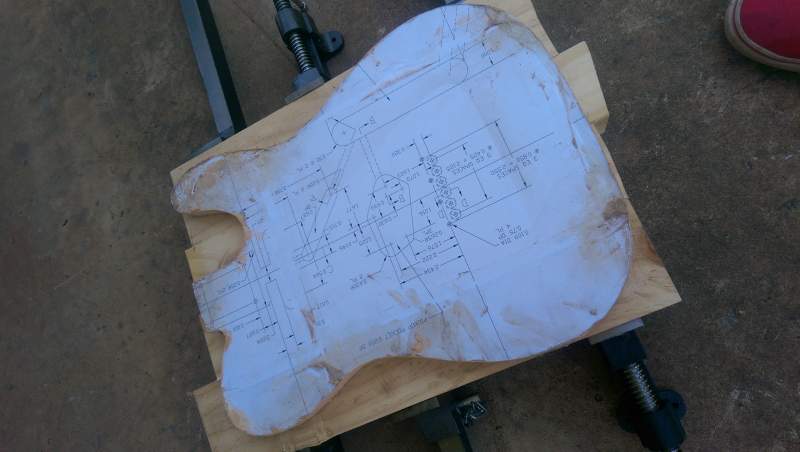

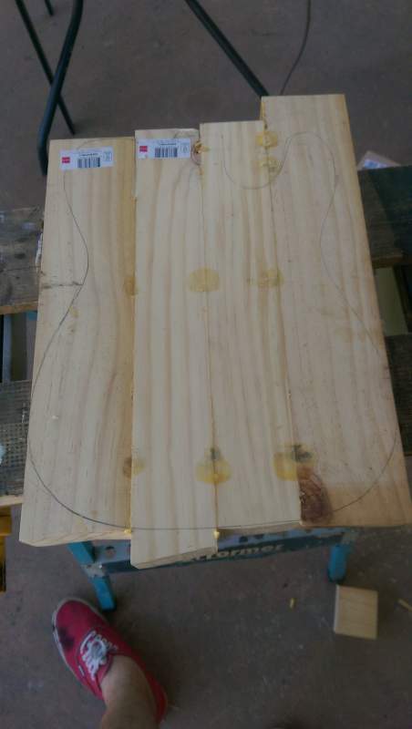

    Templates made and blank glued.

    nice one Andrew, oh that brings back memories. Template looks good, so will it be a string through ?
    That knot bottom right might have been better on the outside ie the waste side, but will give it character.
    Looks like the 2 pieces in the middle are narrower, next time go 4 x 90mm wide and it won't be so tight

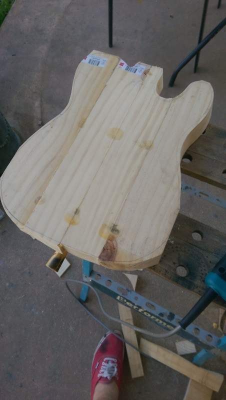

    Body cut out, then routed. Looks kind of like a guitar. I didn't get a pic of the next bit but I broke it already haha. Using a powered plane to flatten her out, the blade dug in on the edges in a few spots. The middle of the body was sweet though so what to do with a concave edge? Carved top Tele!

    looking great Andrew, hope the planer didn't take out too larger chunks !

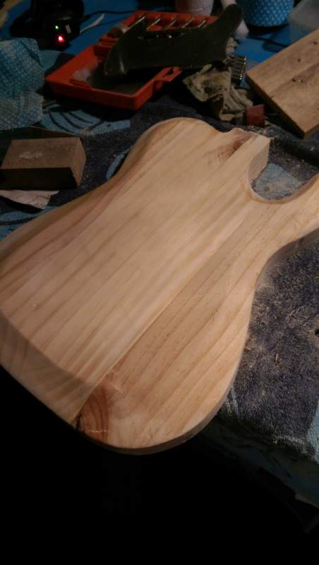

    The carve starting to take shape. Roughed in with the plane, rasps, surforms, files and a spokesshave. It's pretty flat here so to get the arch contour I used a sanding bobbin on a drill to bevel it a bit. So far it's arched all the way around with a deeper cut for your elbow like a strat, and a prs treble horn cut out.

    nice one Andrew arched top looks way cool. A tip get your neck pocket, control cavity and pup cavities routed, this is typically done before any body shaping so the router template has more 'meat' to sit on

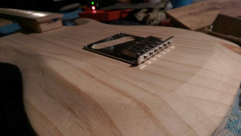

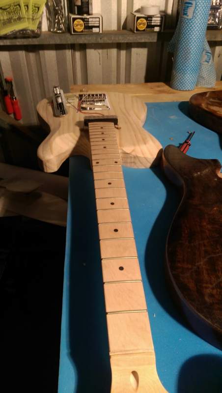

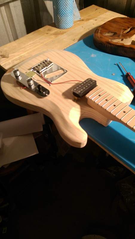

    And this is where we are as of last night. For the hardware I'm thinking single coil bridge, hb neck, Tele style bridge and control plate and no pick guard.
ID:	107   Click image for larger version.
ID:	108   Click image for larger version.
    Looking good man. This thread will serve as a kick in the ass for me to get started.
