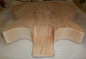

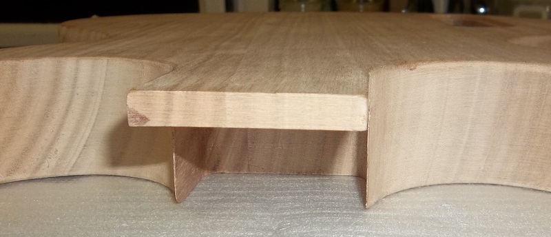

    It's a mahogany body/neck double cut JR with a wraparound bridge, set neck, and a very thin tongue on the neck pocket. The shape of the pocket means that you'll want a good fit around the base of the neck heel so it can carry most of the load rather than overloading the thin tongue.

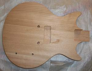

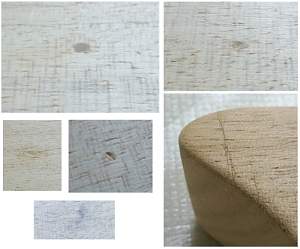

    The body has a few 'features' that I could have done without, seems like it's taken a couple of wacks, stabbings and slices, some of which have been filled others not. Most look fine and I expect will either clean up or steam out pretty easily.

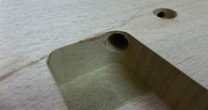

    The crack seems to reappear on the inside edge of the pup rout and then creep towards the treble post hole.

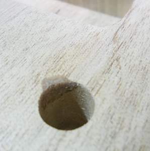

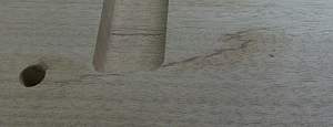

    Possibly unrelated, but they've also used the glue-o-matic 3000 to fill a tear-out/chunk on the edge of the treble post hole.

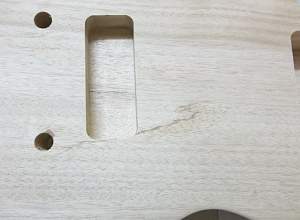

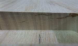

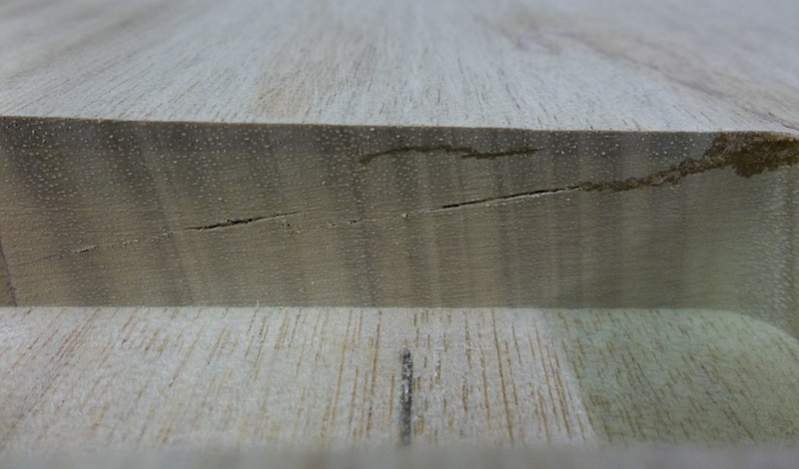

    For me, the more worrying cracks are inside the pup rout, but I think they'll be ok. At the moment I'm planning on supergluing them or, if necessary, glue in some dowel pegs just in case.
    Rear of the pup rout, looking toward the bridge:
    Front of the pup rout, looking toward the neck:

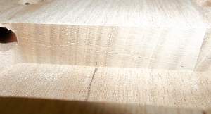

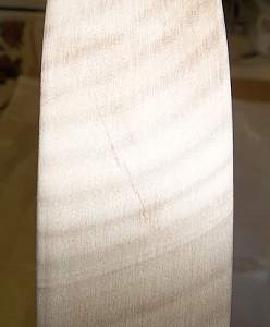

    Just for good measure there's another minor crack on the butt edge of the body on the curve towards the output jack.

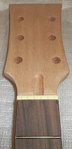

    The headstock looks ok, but the truss rod access is slightly offset towards the treble side. The rod is still accessible and the truss rod cover will hide it, so no biggy.

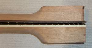

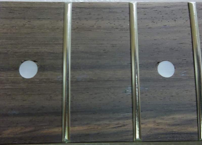

    Fretboard dots are a touch rough with tear-outs on almost half of them, but I'll probably replace them… maybe, depending on finish.

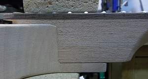

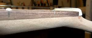

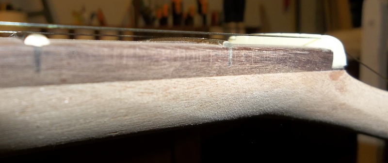

    The headstock transition is quite thin and the neck has the factory's signature lip of rosewood under the nut.

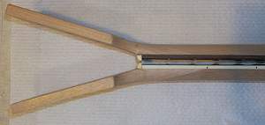

    As the neck pocket tongue is so thin the neck angle is actually on the neck heel, and the angle is there… although it has some slight doming which I'll need to take care of to get the neck angle correct and ensure a good bond when I glue it in. Here it is (top) compared to the LP-1SS (bottom) and you can see the angle on the heel and the bit of doming in the middle.

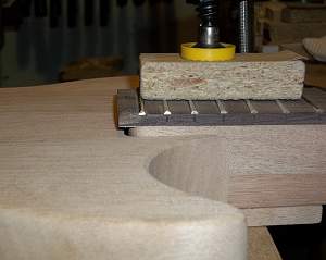

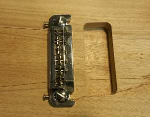

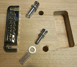

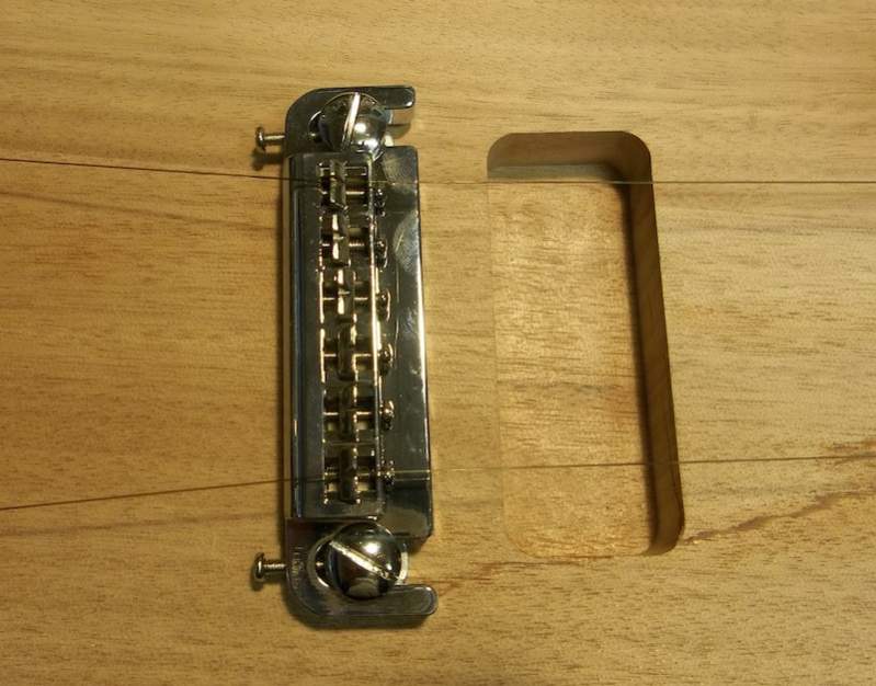

    As the neck pocket fit, break angle and action are the main points of interest I decided to do a test fit to get an idea of the action straight out of the box with no mods, sanding, neck tweaks etc. to see just where we stand. The neck has a slight touch of back bow, as expected without string tension, the nut is a touch too high and there's the slight doming issue on the base of the neck heel… so it wasn't going to be perfect.

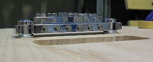

    My test fit tubing and washers allows me to have the bridge sit in place with minimal movement (at its lowest setting), without having to install/extract the post bushes (the washers account for the lip on the bushes).
    I set the bridge intonation screws at around halfway (guess), clamped the neck in place and ran fishing line as e-strings.

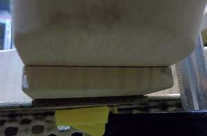

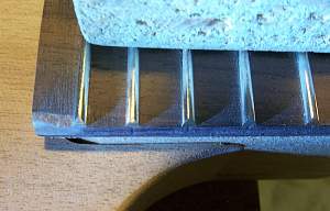

    The action is slightly high, as I expected, but it won't take much to deal with the issues listed above to get it where it needs to be. Ideally, it should just about be kissing that last fret. If needed, you could even recess the post holes for the lip on the bridge post bushes to gain another 1-1.5mm.
    Action at nut:

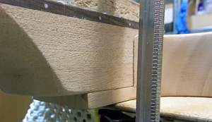

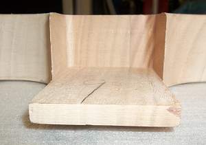

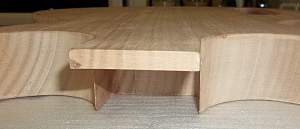

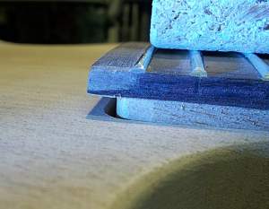

    The neck fit in the pocket is pretty good, although the angle means there's a bit of a gap at the top of the pocket. Options would be to slightly angle the butt of the neck heel so it sits flush against the pocket (but this would mess with intonation), or maybe glue a small angled shim at the top of the pocket (or on the neck heel itself). Need to tweak the neck angle first before deciding if it's necessary.

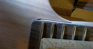

    And, the expected slight gap from the doming on the base of the neck heel:
