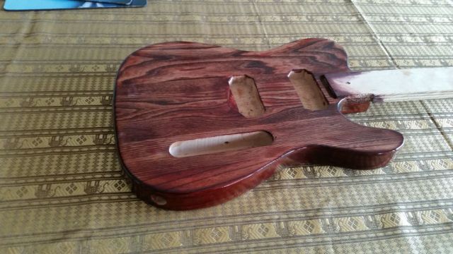

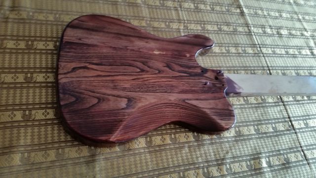

    Here's a front and rear pic with the first coat of stain, it's making the grain pop nicely but unfortunately also highlights the fact that there's more than one piece of wood and it's not book matched.
    I do have a cunning plan to hide this and also the infill I had to make for the bridge pup cavity
    looks great Dave, over 4.5 years to get to this stage, wow we say don't rush the build but .......
    Nice ash grain, wouldn't worry about the non bookmatching but look forward to your cunning plan !

    Finally got around to doing some more on the Tele.
    Many coats of Wattyl Dark Mahogany stain, then wet sanded with 1000 grit on the front and back only leaving the sides dark red/brown, the face of the headstock is getting similar treatment.
    The pics show it with the first coat of clear, there are very small brush marks to rub out and also a couple of spots on the back that refused to take stain.
    The kit supplier advertised this as alder and I have two PBG kits one is a basswood PBH4 and the other and Ash STA1 and the grain on both of these is very similar although the ST doesn't feel or sand like it's made of balsa which the PBH did until I put the sanding sealer on

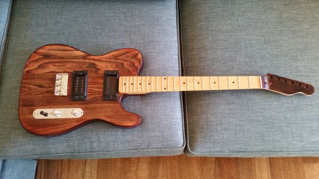

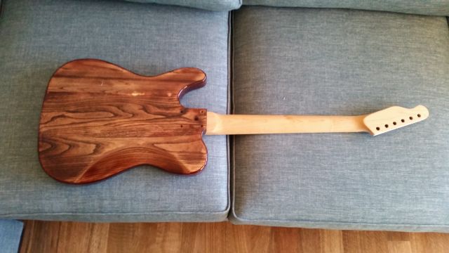

    Just thought I'd bang it together with the pups, bridge & switch plate resting in place to see how it was coming along.
    Not too bad but I'm not happy with the motley shading on the headstock, it was a very dark mahogany colour the same as the sides so I hit with some 1000 grit wet to tame it a bit and stuffed it.
    Still needs to be polished & buffed and the frets looked at before final assembly.
