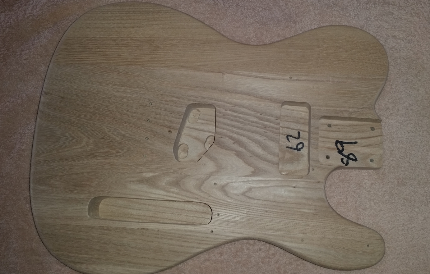

    Body sanded to 400 grit
Name:	P7 400 Grit front-1.jpg

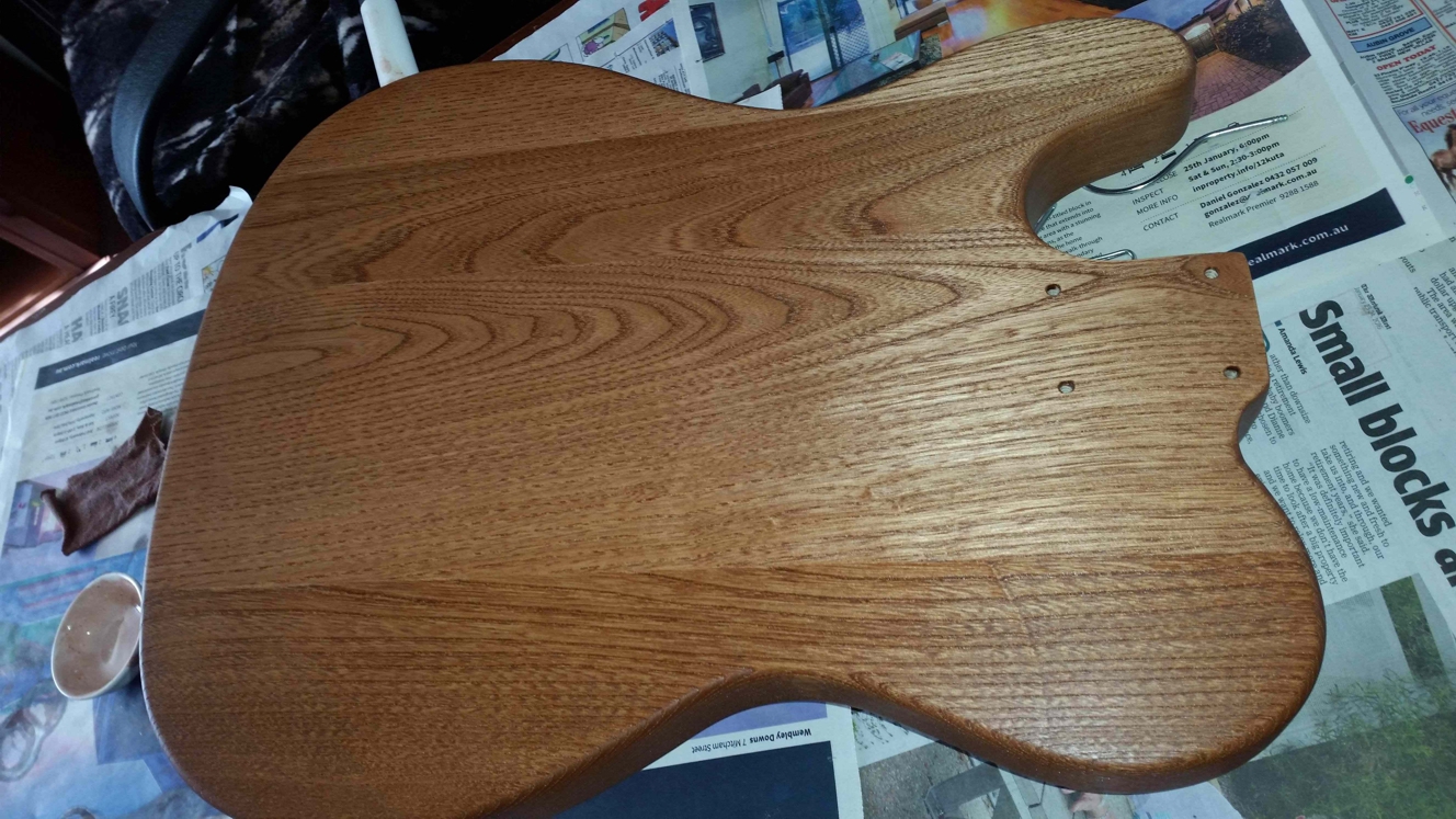

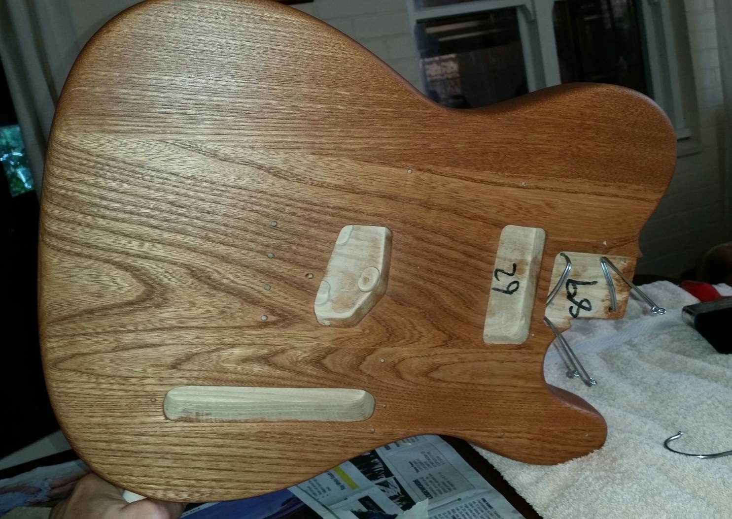

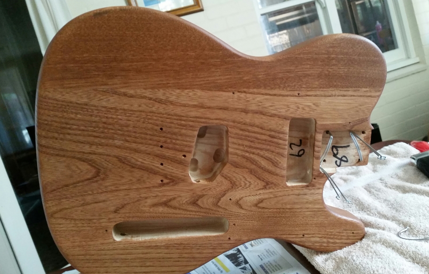

    BODY STAINED - Dingotone Nullabor Ochre
    Here are photos of the front (flash and no flash) and rear of the stained guitar body.
    Initially the stained top edge was very dark - almost obscuring the grain, however after 4 days the color has now mellowed and the stain on the top edge also looks just fine. Am very pleased indeed with the colour.

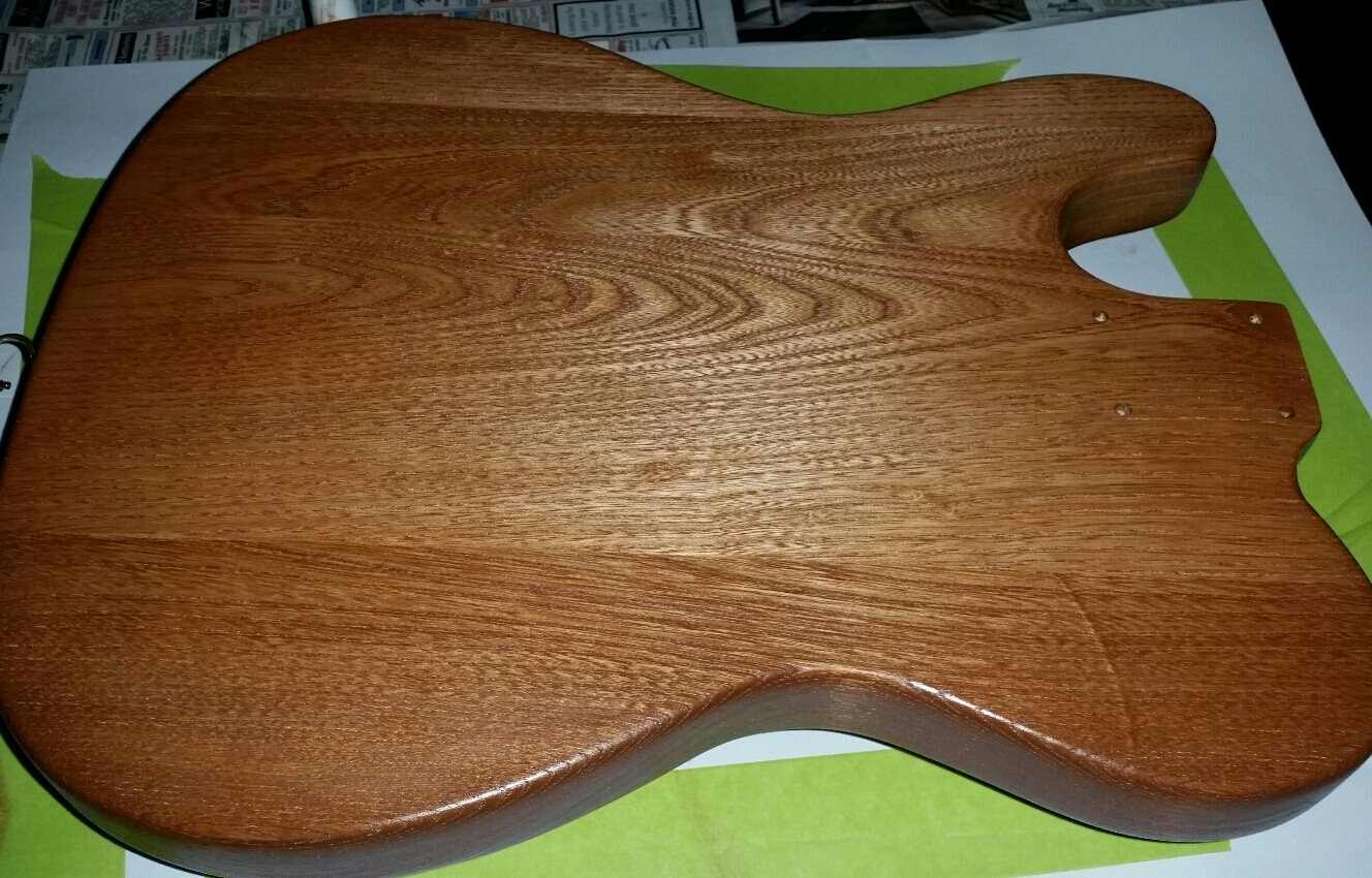

    Wow - the intensifier coat really ..... intensified the grain contrast ! Click image for larger version.
Name:	P10 intense small-1.jpg
ID:	8260 It has covered really well and I think I will probably stop after applying this one coat, and move on to the first top coat next week.
