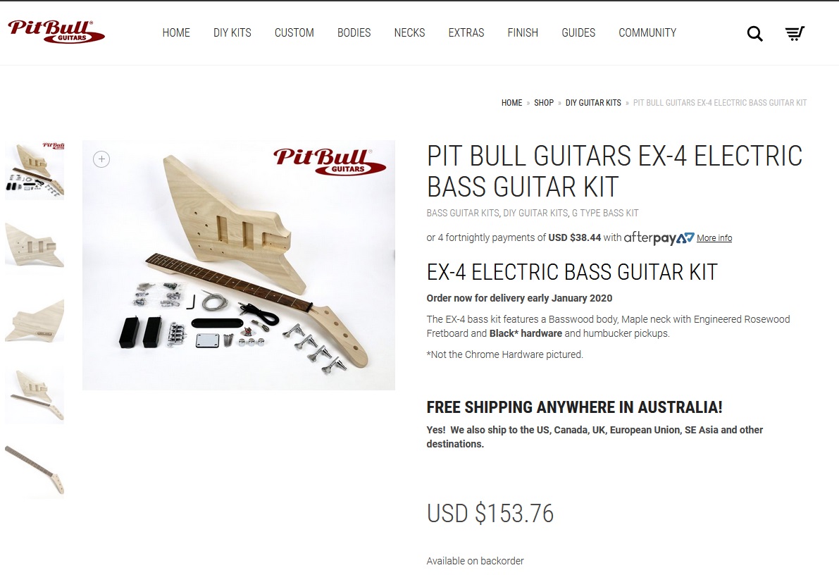

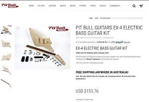

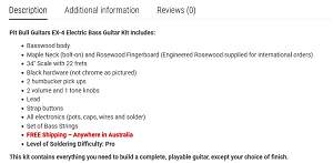

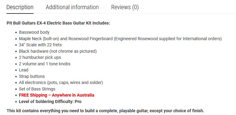

    What PitBull Guitars offered back then:
Name:	screenshot pitbull ex-4.jpg
Name:	screenshot pitbull ex-4-II.jpg

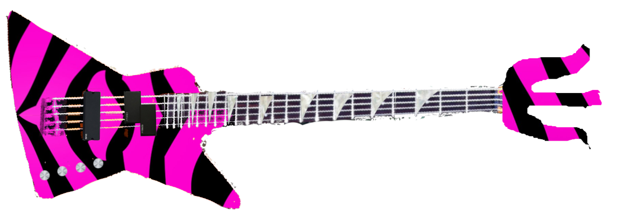

    And my very first sketch after finding out there are customizeable bass kits without any further research
    sooo.... with these information and idea I started to plan what to order....

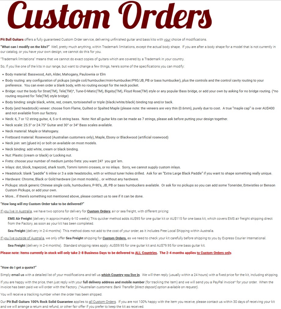

    Modification 7: If possible: controls /control cavities parallel to the lower edge of the body instead of the strings.
    Back then, Pit Bull Guitars offered the posibilitie to customize a lot of the kits:
Name:	screenshot pitbull custom order.jpg

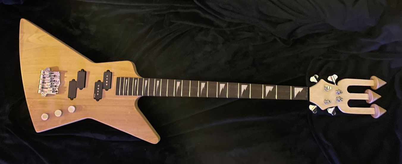

    EX-4: Bridge Position / Scale length problem
    Member MoSch's Avatar
    May 2023
    Germany
    19

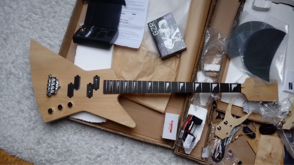

    Cool the kit arrived (Nov 2019)
    in the end of November 2019 I could collect my kit from customs.
    Here with the aforementioned parts:

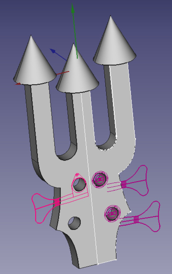

    First CAD-drawing of my preferred design:

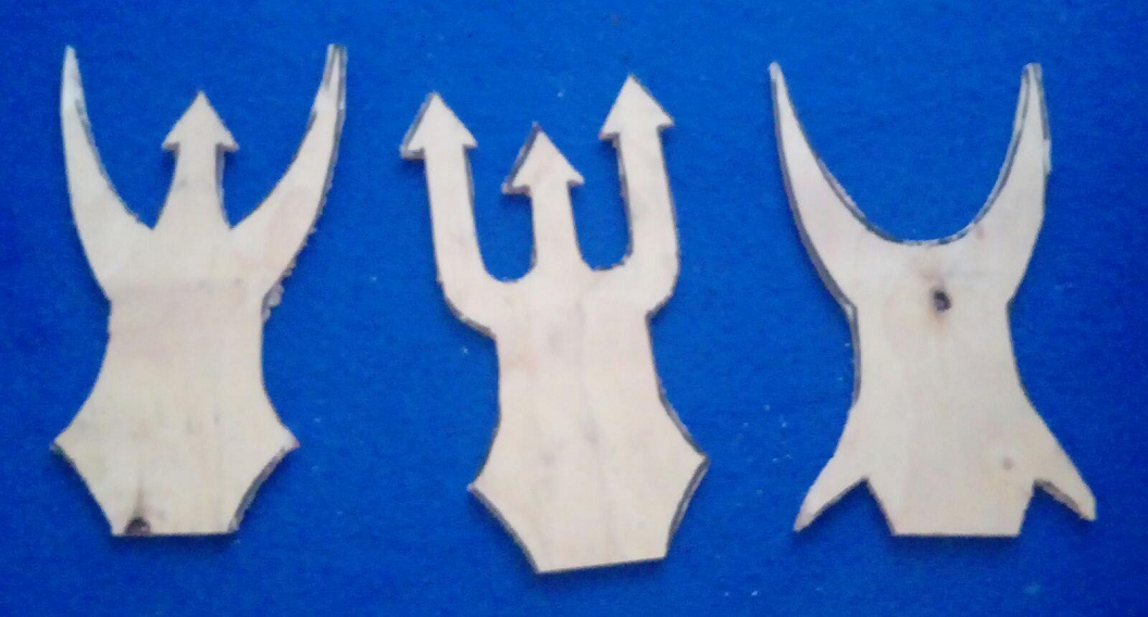

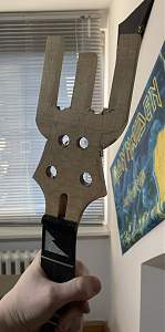

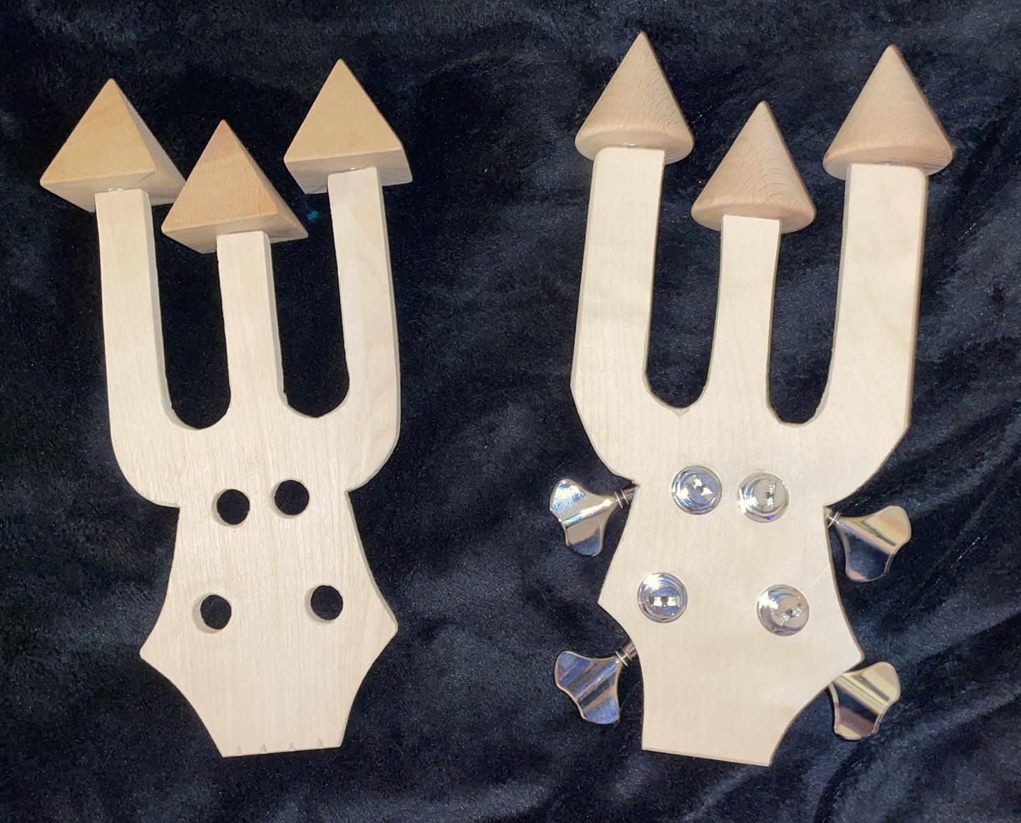

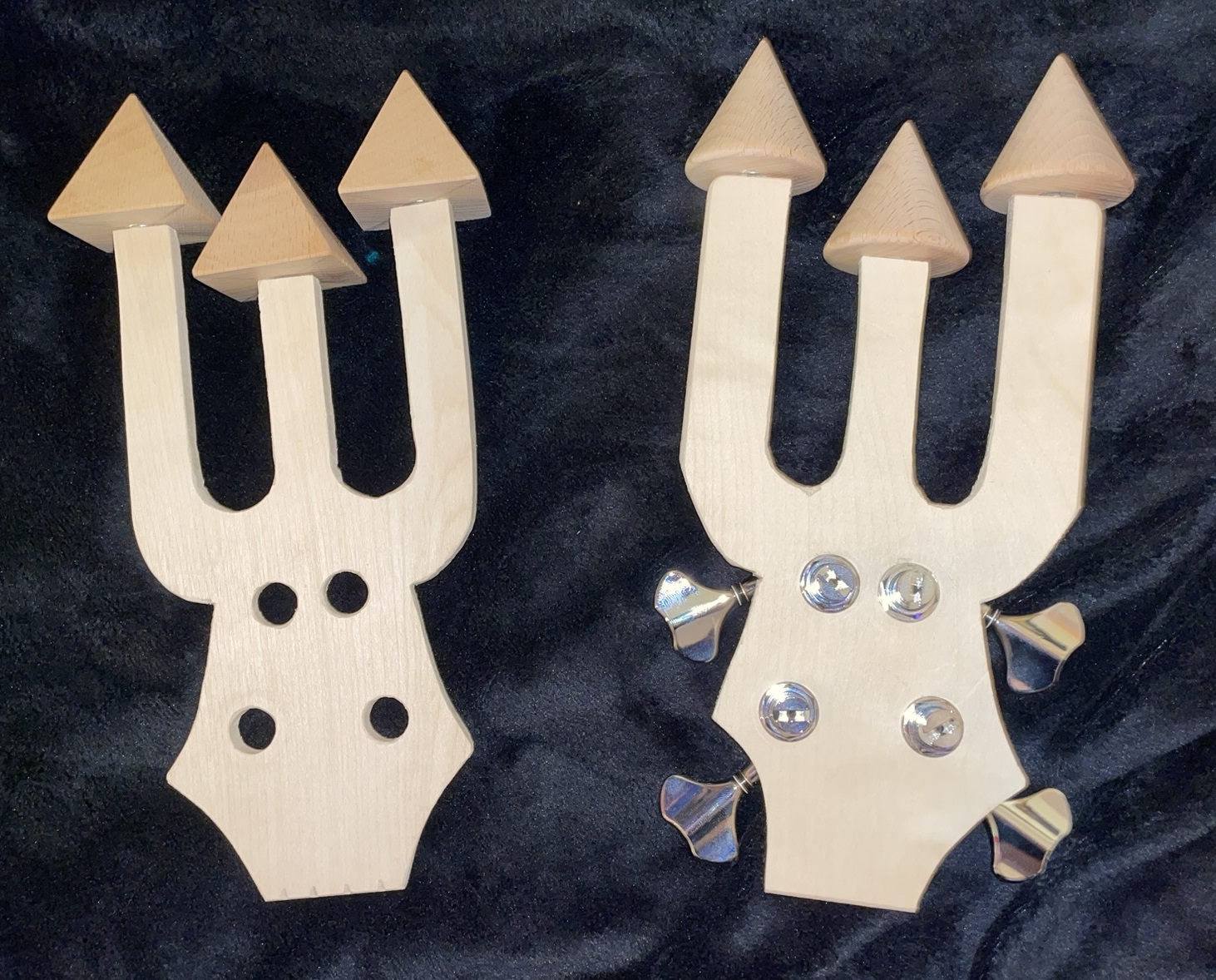

    Then I started practicing... I bought cutting boards ("Frühstücksbrettchen", something obvously not existing in the rest of the world.. dictionary suggests "the wooden boards Germans eat their breakfast from") from the same wood as the neck and practiced cutting, drilling, mounting the spikes,...
    The spikes have a thread, the tip they are screwed on a threaded bolt. Getting them there was... challenging
    This way they can be exchanged, removed to fit into my case, and potentially be abused to mount all other kind of funny stuff
    I put one of those dummies in position for a first impression how it might look like:
    I liked it, and wanted to go for it!

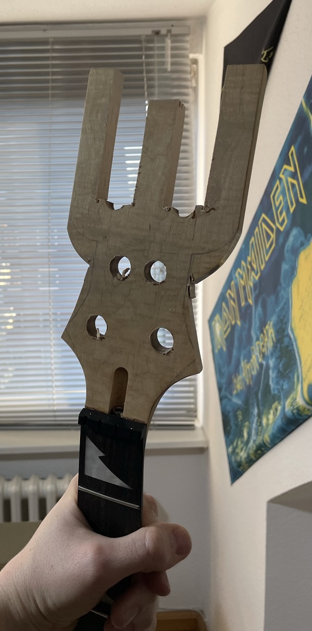

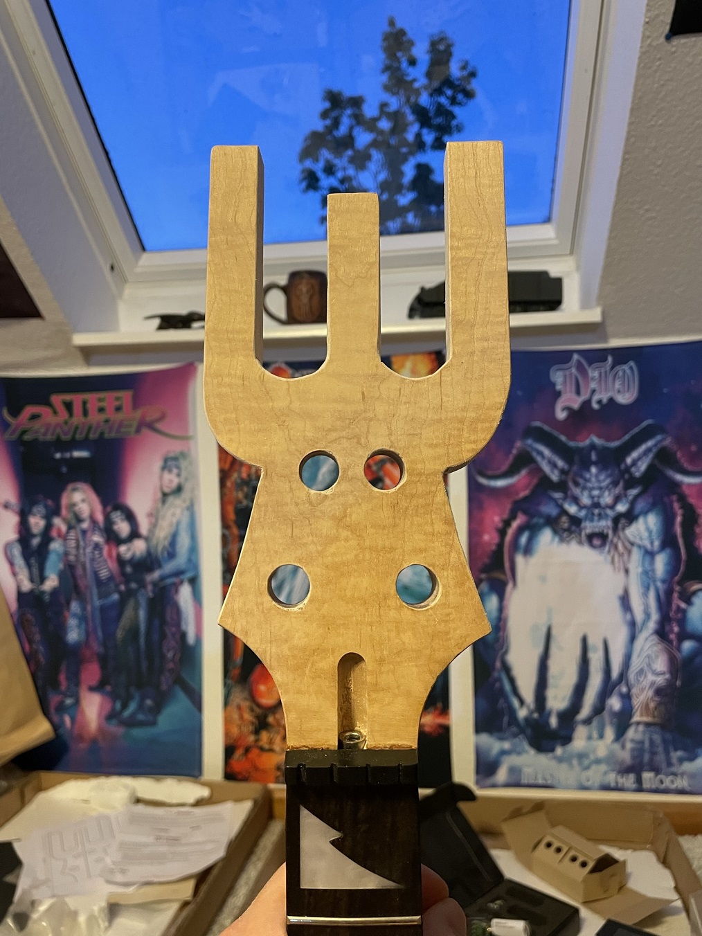

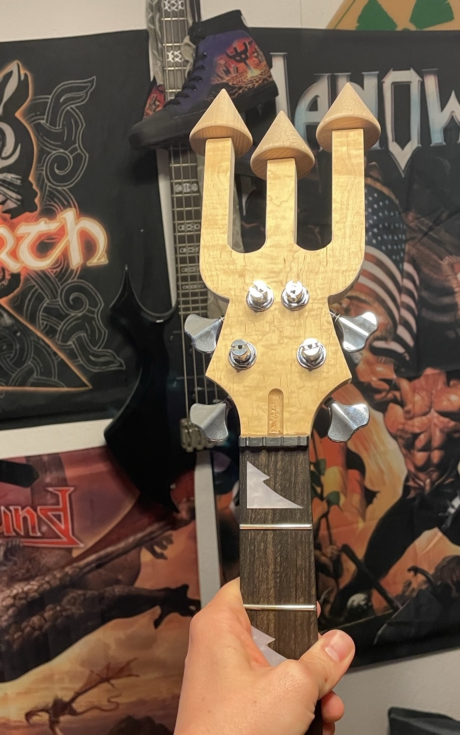

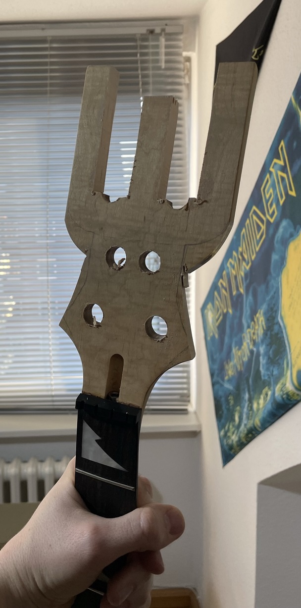

    Exclamation Cutting the real headstock
    so... around Mai 2023 I summoned up the courage to finally work on the real headstock.
    Work in progress... not tooo nice yet
    getting better

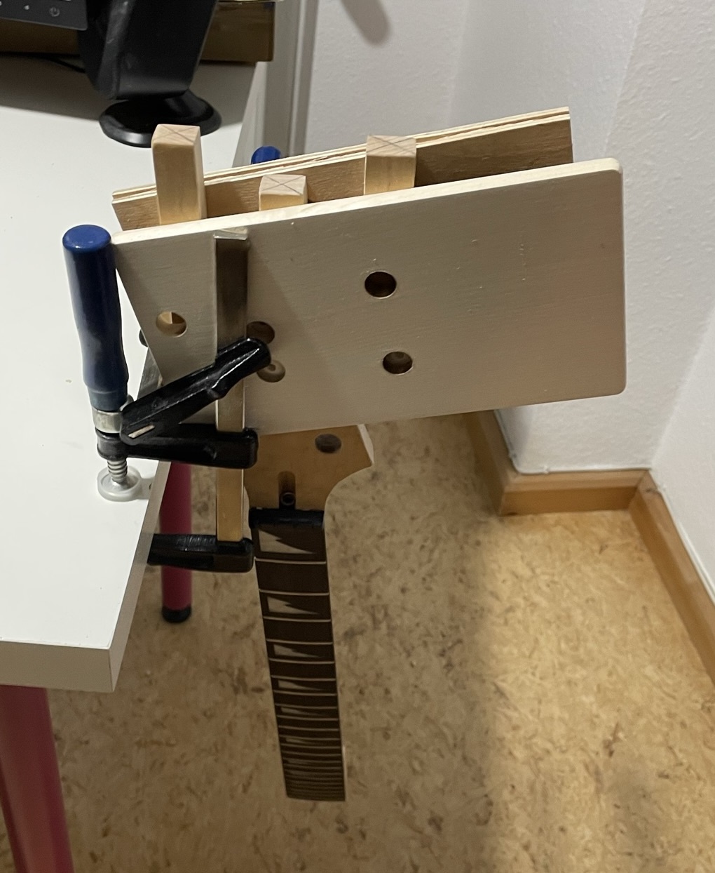

    highly professional mount to drill the holes for mounting the spikes...
    (I also only drilled or cut into the table once. So far...)

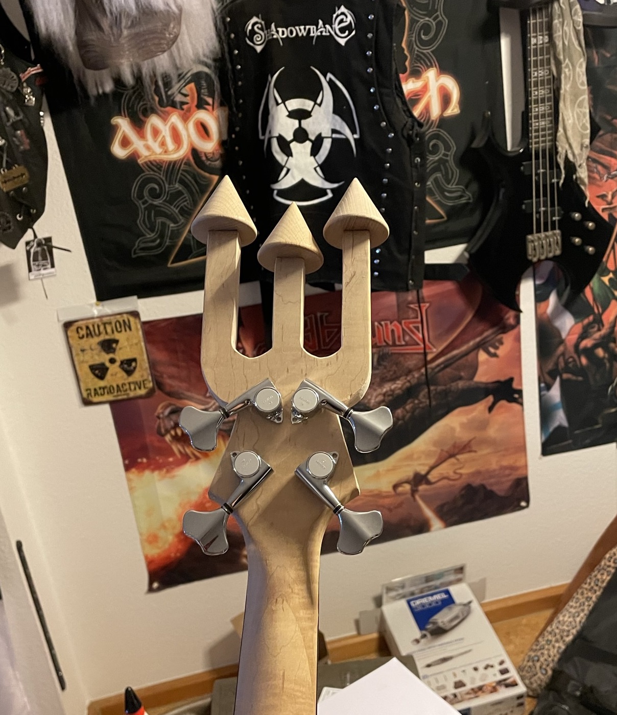

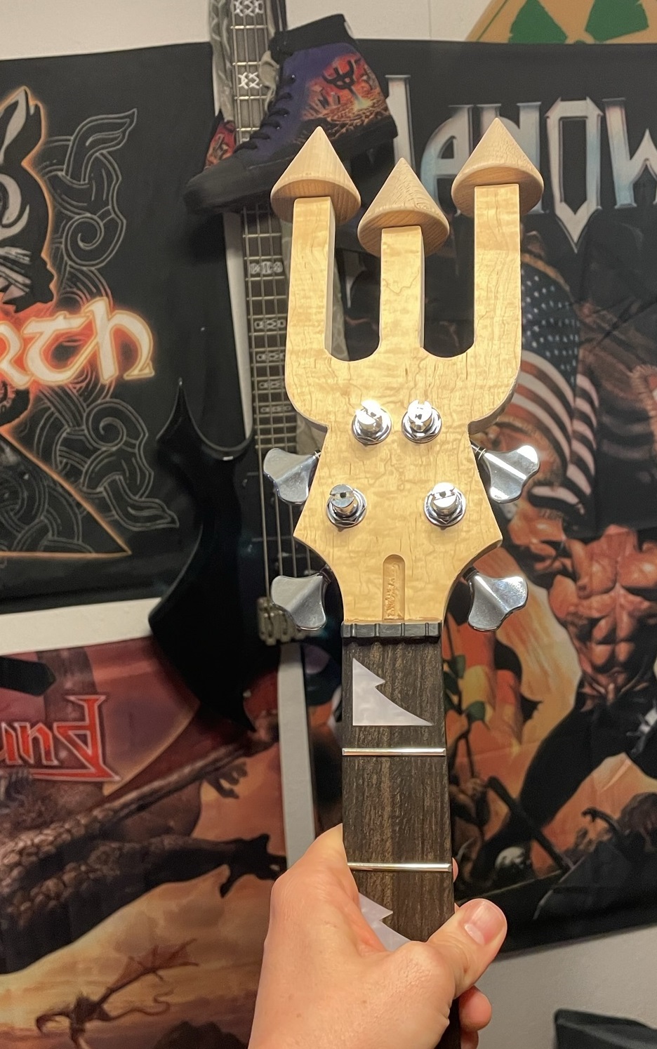

    Final result:
    yes, the tuners fit that way. Glad I did the CAD-design to check.

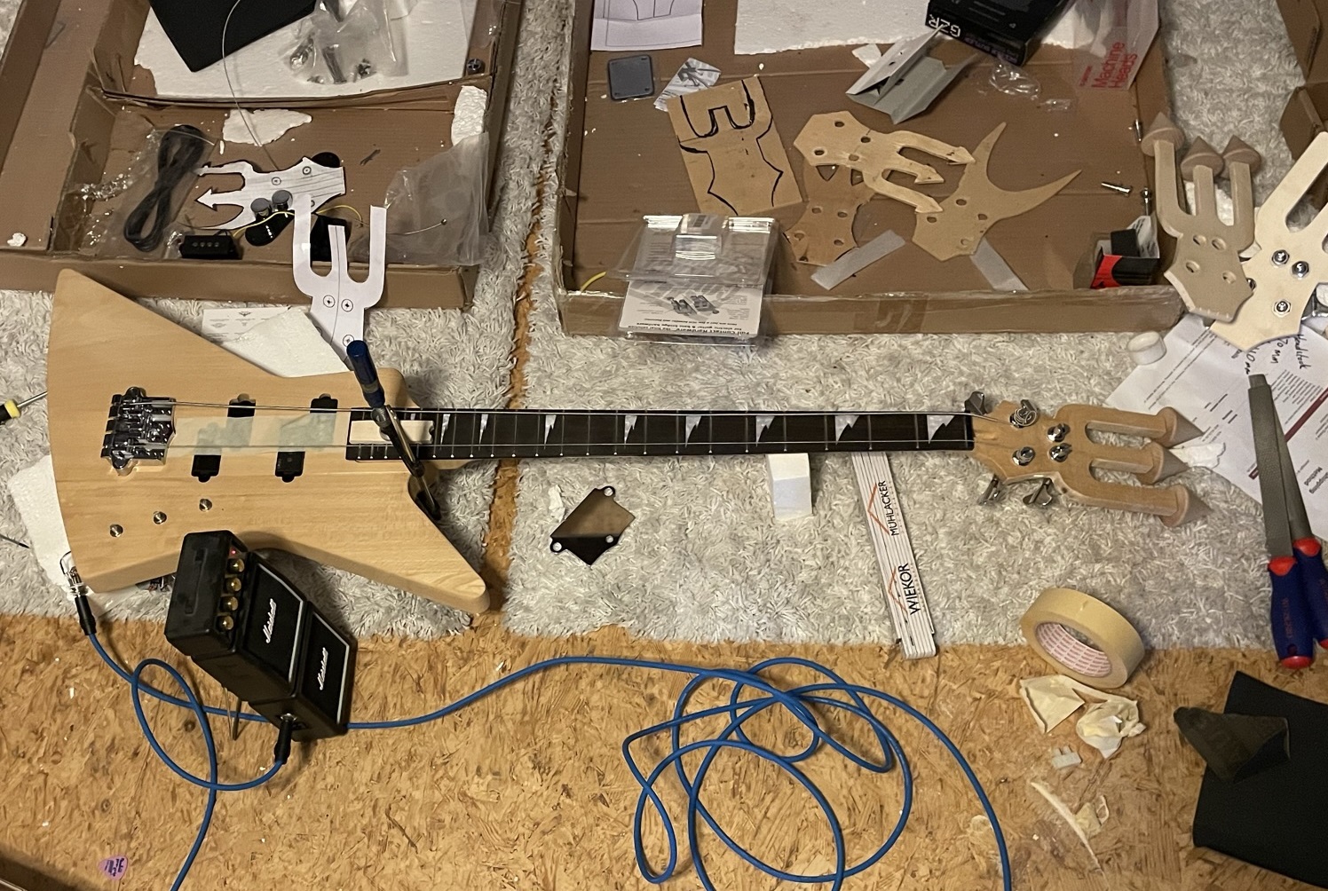

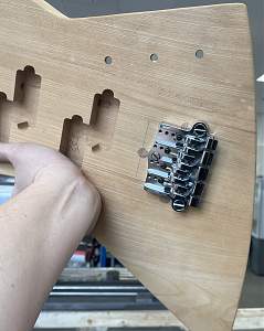

    Unhappy First "mock build" attempt and new challenges...

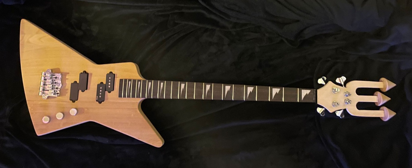

    First time it makes noise

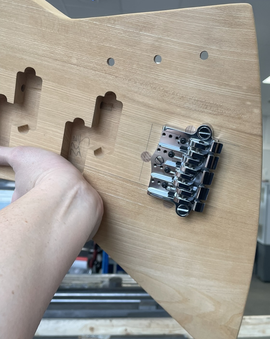

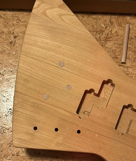

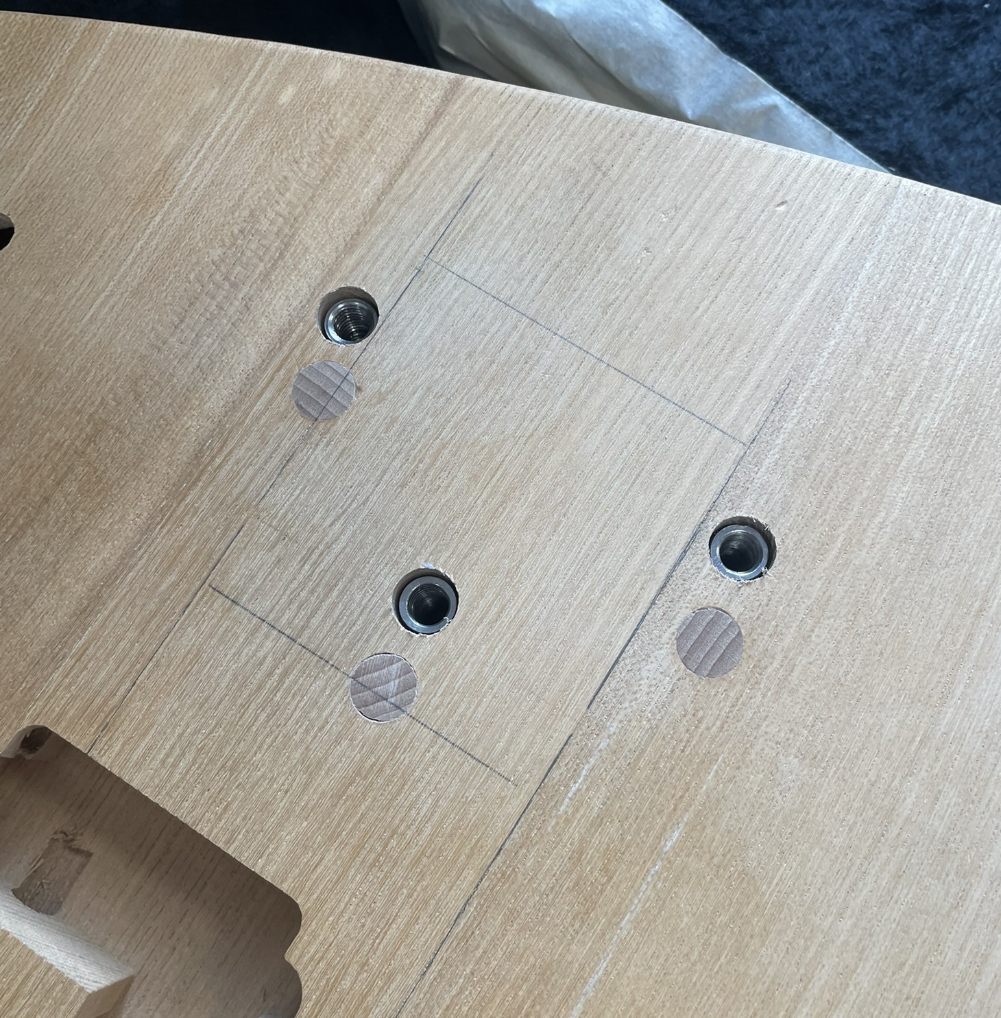

    but... the bridge holes are at the wrong positions. Maybe due to my customizations with pickup-holes and tilted control cavity...
    The whole story can be found in this thread.
    Summary: The nice folks here in the community encouraged me to fill the holes and redrill...
    So I practiced that on my breakfast boards again, learnt what a japanese saw is,...
Name:	WhatsApp Image 2024-04-23 at 21.43.38b.jpg
    and filled the holes.
    Of course that took me another year, so spring 2024 saw the bass with no more wrong holes - but also no correct ones.

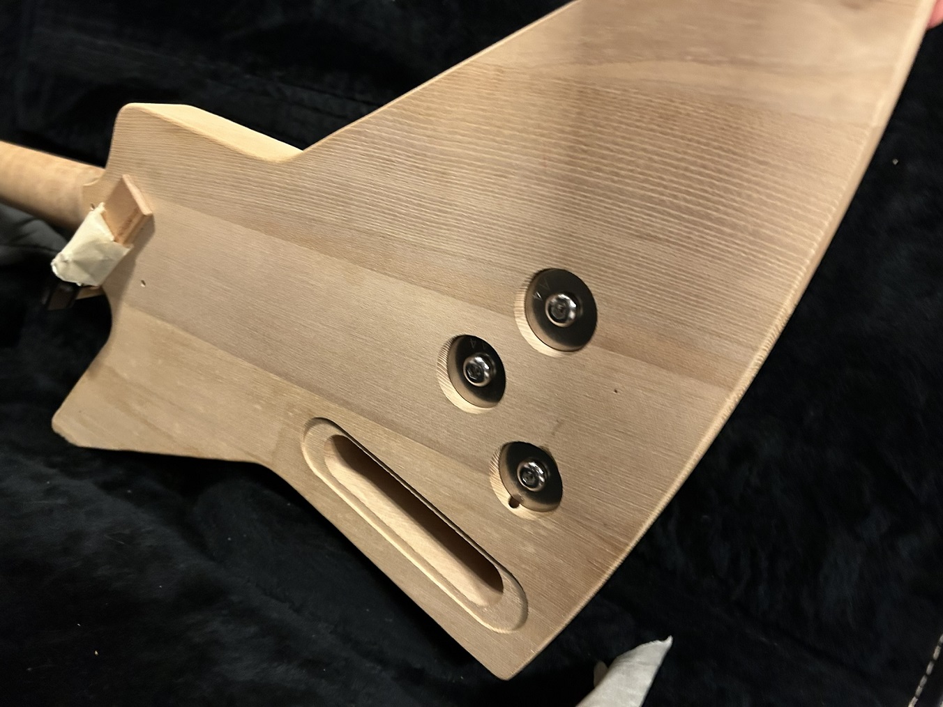

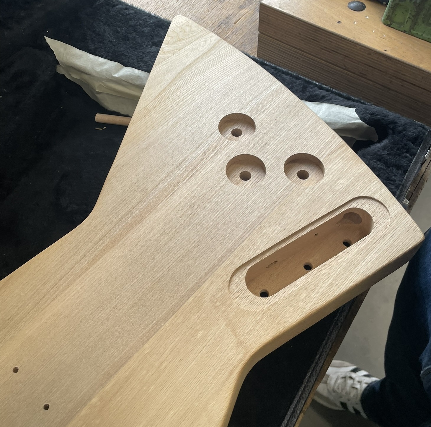

    Lightbulb Change of bridge mounting concept

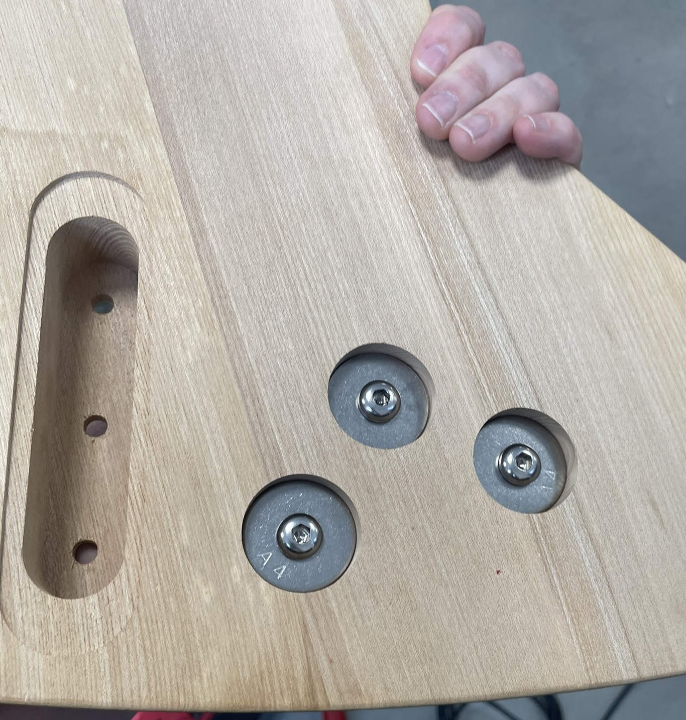

    the original bridge mount with press-fitted ferrules seemed rather archaic to me... also... with that approach I only had one chance... I dont like this idea...
    encouraged - AGAIN - in this community as well as by the bridge manufacturer who responded nicely to my email, I decided to try a different concept.
    So to say... a MoSch-mount
    Of course, I neither had know-how nor tools to make it happen... I hunted for the neccessary parts, then I learned what a Forstnerbohrer (Forstner drill?) is, bought one, and got help from a friend with drill press access.
    And figured out already now the bass doesn't fit any of my cases...
    So... after adapting the Charvel Star Bass Case with a knife and violent force - I was able to carry it to a drill press in the end of 2025, get new holes in its body and finally mount the bridge
Name:	IMG_4563 - Kopie.JPEG
Name:	IMG_4566 - Kopie.JPEG
Name:	IMG_4564 - Kopie.JPEG
Name:	IMG_4568 - Kopie.JPEG
    The grounding of the bridge is now done with hole between the control cavity and the closest huge bridge mount hole.
    So the next step could be a new "Mock build"... but I have to wait for the suitable drill to be delivered first. Of course that one was missing in my collection.
    So... lets see how many years it takes me this time to make a next step
