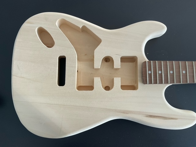

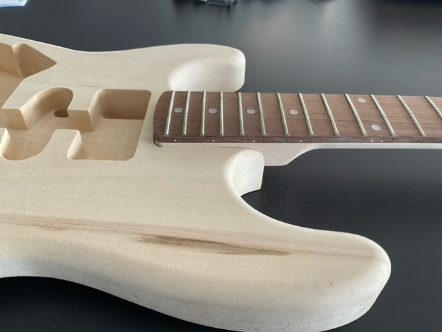

    We got given the above as a gift and I am not sure where to start. Should we paint it first after the test build? We have sanded the neck to fit and now not sure where we go from here. I have hopefully attached photos of where we are at. Thank you.

    Quote Originally Posted by willgard View Post
    First is to always do a mock build to see if all components are fitting and if you are good to go. Also you need to string up high E and Low E string to see if the neck is aligned properly and also that the scale length is set right for your build

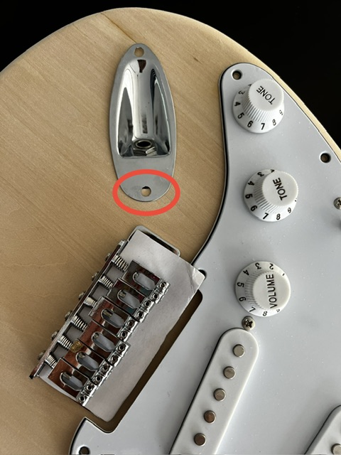

    1st and 6th strings are high and low E. You need to string us as in below picture
    To see if they are equal spaced from ends of fret board. Also scale length is measured from inside of nut to top of saddle. It needs to be perfect for guitar to have proper intonation.

    That gap is normal U can push up the Jack cover a bit up
