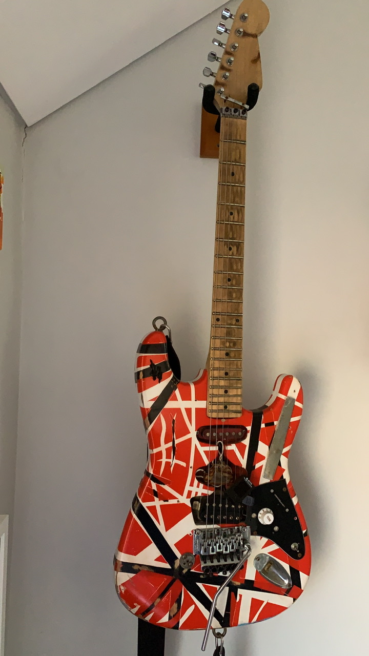

    Nice! On mine I used the 71 quarter
    The Floyd is quite easy to set up, the problem is it sits flat on the body so to adjust the action you need to shim the neck. Apparently EVH used a fender heavy pick, I used that and a little foil to get it just right.
    The Floyd rose special is a great trem to use, cheaper than the German one but much better than the licensed ones. All steel except the string locks on the bridge.
    I filled the HSH body I had to get the correct profile of the holes, I also put 2 dummy screws in the back of the neck to look like the nut attachment
    The pickup is an Artist Bullbucker, absolutely awesome hot wound for a steal.
    They stock the correct oval reflectors at Bunnings, but not the round ones.
    I really enjoyed the time taken to age it correctly (or best I could)
    This is one of my most played guitars, I hope you enjoy yours

    Mentor Andyxlh's Avatar
    1,206
    It doesn’t have to be very expensive, the FR was about $100, the pickup $40 or so, did you request a black scratch plate from Pitbull? The eyelets are 25mm from Bunnings, about $4
    I found the best paint to use was Dunlop dura max gloss white/black, and Hot Lips for the Schwin bike paint is very close, about $45
    You will need a Floyd string retainer fir the headstock, eBay.
    Use one of the kit pickups for the front and the annoying thing is buying a really nice 5 way switch and ruining it for the centre position! They are about $30
    Apart from the white knob, your PB kit should have everything else you need, use their machine heads, socket, screws and so on.
    I made a saltwater slurry to age non electric bits, and used acrylic paint to dirty stuff up too
    Immense fun!

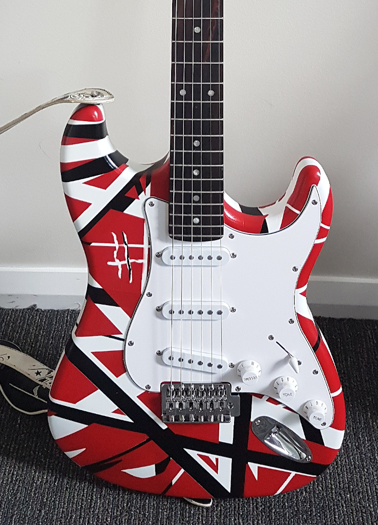

    I didn't get a black scratch plate as it wasn't an option with that kit and I didn't think to ask. Can grab one on eBay for about $13 anyway. Thanks for the tip on the neck shim - that would probably have tripped me up and I would have taken many wrong options trying to work out how to fix it. I like the sound of the FR. The only options I'd seen in my limited search was genuine (quite expensive) and cheap eBay options (likely plain rubbish). I like the sound of a middle ground.
    I'd already checked out your build diary a while back on this and you were already going to be my go-to guy with all my questions. As for the paint, my previous version of this I used SCA auto paints and was quite happy with the colours and how it turned out. Was probably the only good thing about the whole build given the cheapness of the kit and the lack of upgrades.
    1,206
    That looks pretty good!
    You could develop that one further… it’s close!
    At least your kit will come with the white tone knob!!!
    The neck needs to not fit in the pocket, it is a Tele style neck end in a strat body. I took the sander to the end of the neck to square it off
