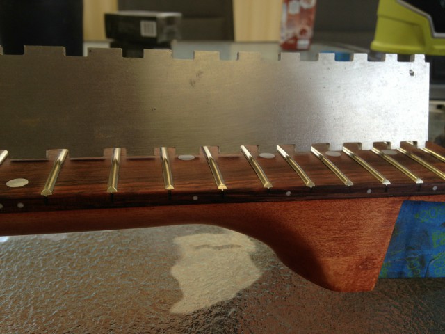

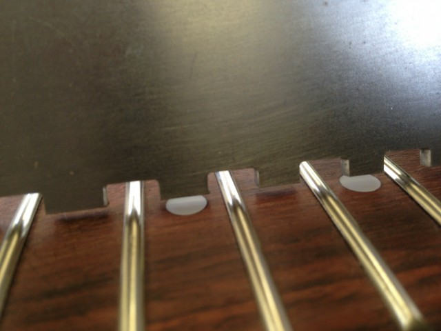

    I have a problem with the neck I checked it with a notched straight edge and it's a strange slope. If I put the straight edge on the first two frets there is a large gap at the joint end. Some pictures.

    I haven't tried the truss rod yet. Do you think it will correct this or is it a manufacture defect.

    Try getting it flat at both ends - don't worry too much about how flat it is between individual frets - what you're looking for is - is the neck overall straight - or is there a dip / bulge in the middle.

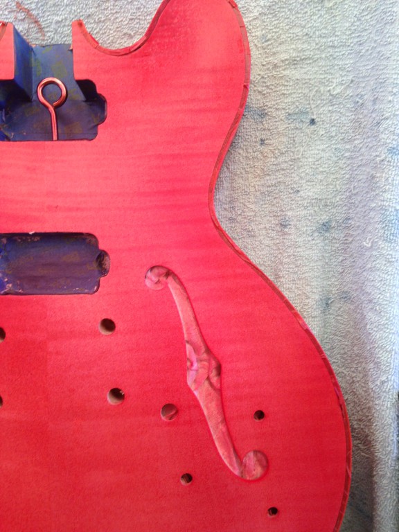

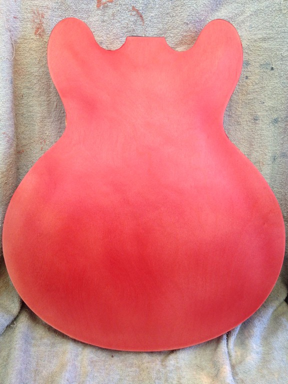

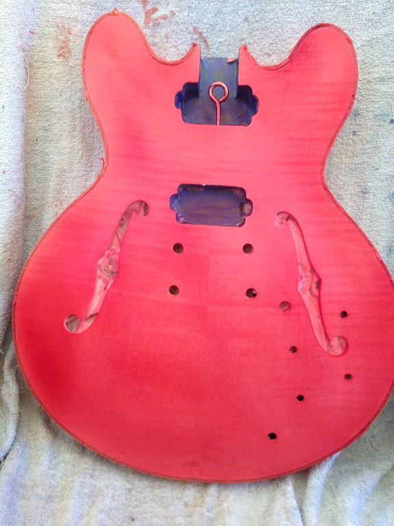

    Thanks Brendan, I've sorted the neck. Have highlighted the grain with timbermate and sanded to 320. I gave the body it's first coat of colour yesterday and this how it came out. It's not as pink in the flesh.

    looks good Salo, what sort of paint have you used ? looks like you shot it from a spray gun ? Any more coats and you will hide the flame maple and nice grain on the back
