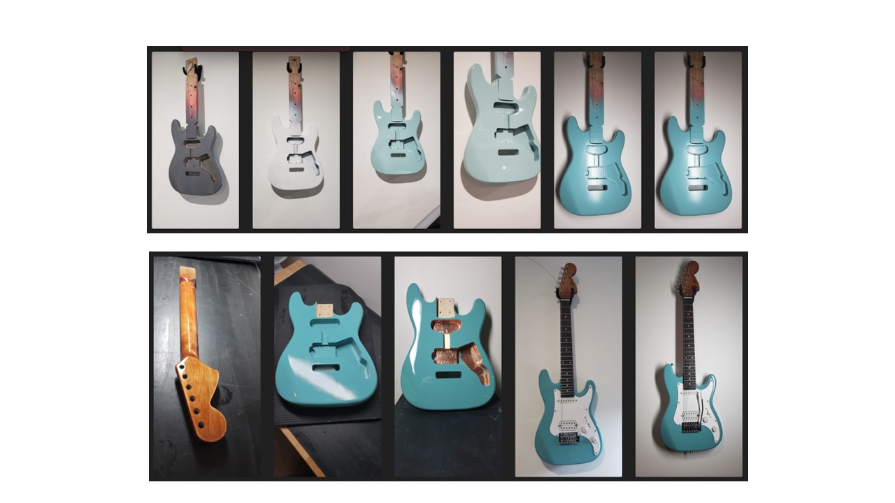

    Pitbull Build #1 ST1-JR
    MARCH 2022
    Pore fill and sand for primer.
    May 7- May 16
    1x coat Primer Grey enamel body, neck and headstock.
    3x coat Primer Grey
    May 19
    3x coats White Gloss enamel
    May 25 - May 27
    9x coats Creation Blue gloss enamel
    June 22
    Level sanding for clear coats
    June 23
    Creation Blue fails coming off in chips after wet sanding
    Stripped all paint back to pore fill
    June 30
    3x coats of Sea Foam Green nitrocellulose
    1 July
    2x coats Sea Foam Green nitrocellulose
    4 July
    Sanding prep for clear coats
    8 & 9 July
    5x coats clear nitrocellulose body and neck
    11 July
    Sanding 1000 - 1800 grit
    15 July
    2x coats clear nitrocellulose body and neck
    15 July
    Hung for curing
    25 August
    Final wet sand
    Copper tape install
    10 September
    Cut and polish
    20 September
    Fit neck
    Electricals
    1 October
    Fixing bridge and Tremelo
    Stringing, bridge & action adjustment
    8 October
    Intonation & re-tuning
