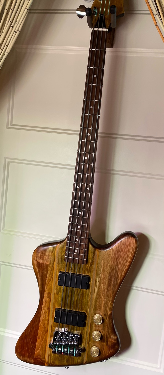

    Added pics of completed TB and IB-4’s
    Here they go. What fun and I am having a blast with the dying and my self entrance into a meditation program using the rubbing of Gun oil on my guitar!
