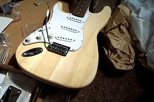

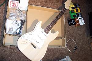

    Well my stuff showed up and I fooled around with it for a minute. I'll get some work done then post better pics but ya have to start someplace. Click image for larger version.
ID:	43042 Click image for larger version.
ID:	43043 Click image for larger version.

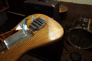

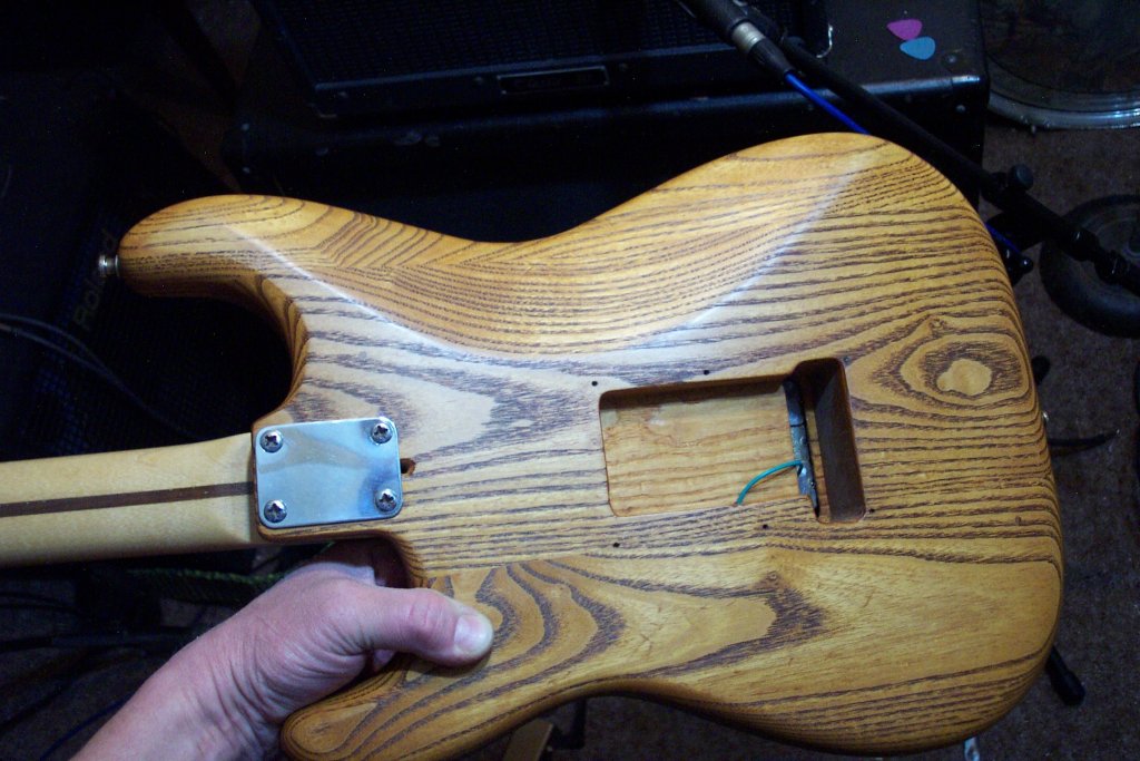

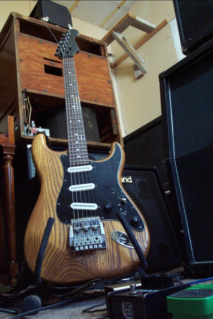

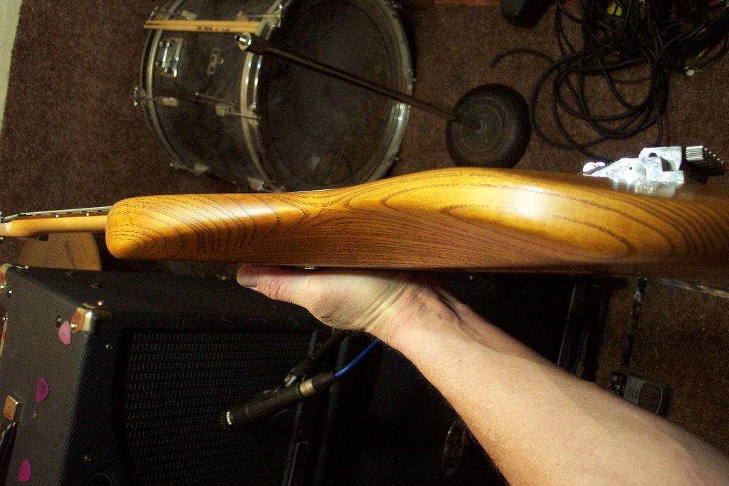

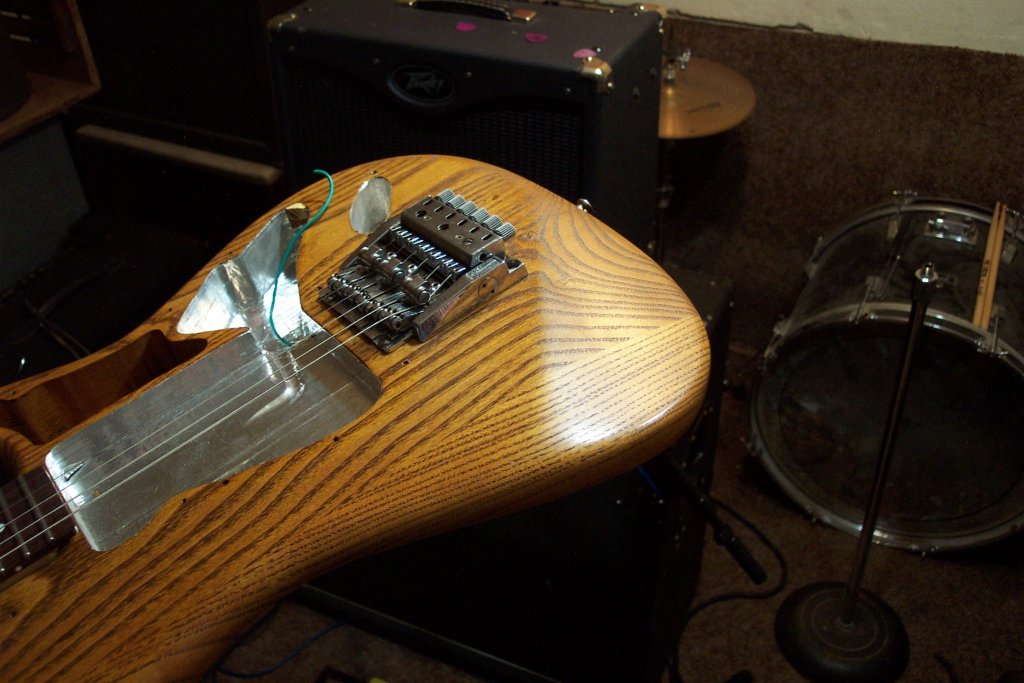

    Well Ive been busy so have not jumped in on the build yet although I have located some drill bits that I think will work. It appears that the nut is cut the proper way for a lefty but I will replace that with a Tusq for sure. I had to tell myself, "just build it and make a useable guitar so I can trying learning lefty". (and not tear out the frets and redoo it in stainless jumbos hahah). One of the first things will be to walk up to the drum end of a belt sander and fix the body contours. Here are a few pics of my old strat (i think about a 73). I have had since the late 80s, It has a old charvel neck, (before they were serial numbered or called boogie parts). It developed quite a twist over the years and I spent several years untwisting it then refretted it and reshaped the body like the 50s belly/forearm cut. Click image for larger version.
ID:	43075 Click image for larger version.
ID:	43076 Click image for larger version.
ID:	43077 Click image for larger version.
