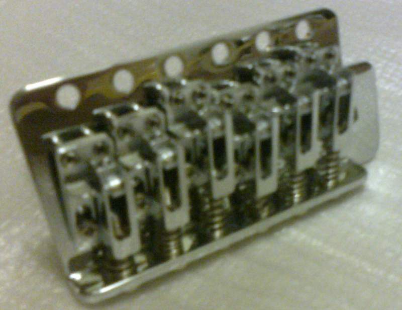

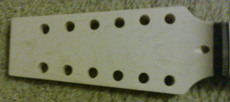

    Time to start my next adventure. This baby arrived direct from China on my birthday! This will probably be the last guitar I get to make for a while, so I plan to go all out and make sure this is special. Pretty standard ST-1 kit, except for the neck and the 12 string whammy bridge (I didn't even know they made those). I'll be blocking that as I can't imagine ever wanting to use a whammy on a 12-string. The headstock will need to be evened up.

    Some of the tuner holes look off a bit as you said !

    Yet the bridge is a bit full on, but is similar to the Gotoh 12 string bridges except this is, inexplicably, a whammy bridge. So I will have to make some small wedges to block the bridge. And I think I will definitely have to replace the nut as it has been cut for the incorrect Rickenbacker stringing (octave string below standard string) instead of the correct 12 string configuration (octave string above standard string).

    dont know what the string tension effect from twelve strings would be, but on my old strats I used 5 springs with a cheap 5 string claw screwed all the way onto the body and you couldn't budge the bridge from hard down on the body.
