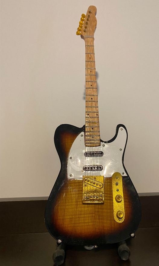

    Here is a photo of a replica that he has sitting on his desk guys. Many thanks already
    Wow! Apart from being a lefty, there's a striking similarity between RocknRolf's and the desk-sized one!
    As for videos, there's an American guy that does a number of stain bursts on YT. I think he is Big D Guitars or something like that.
    It does ay! This one has a sprayed black, perhaps even red underneath the black burst, I think.
    Regarding the smooth transitions Simon is talking about, I used a damp clean rag to feather from light to dark. I did practice on about 10 pieces of headstock veneer before I was happy with my technique and colours. Those pcs of veneer can be bought on ebay or alie for under 10$ for a 5 pack I think. To me more than worth it when you want to nail a look.
