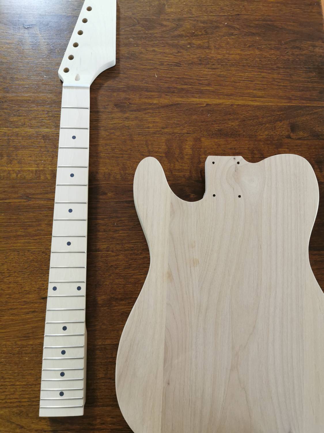

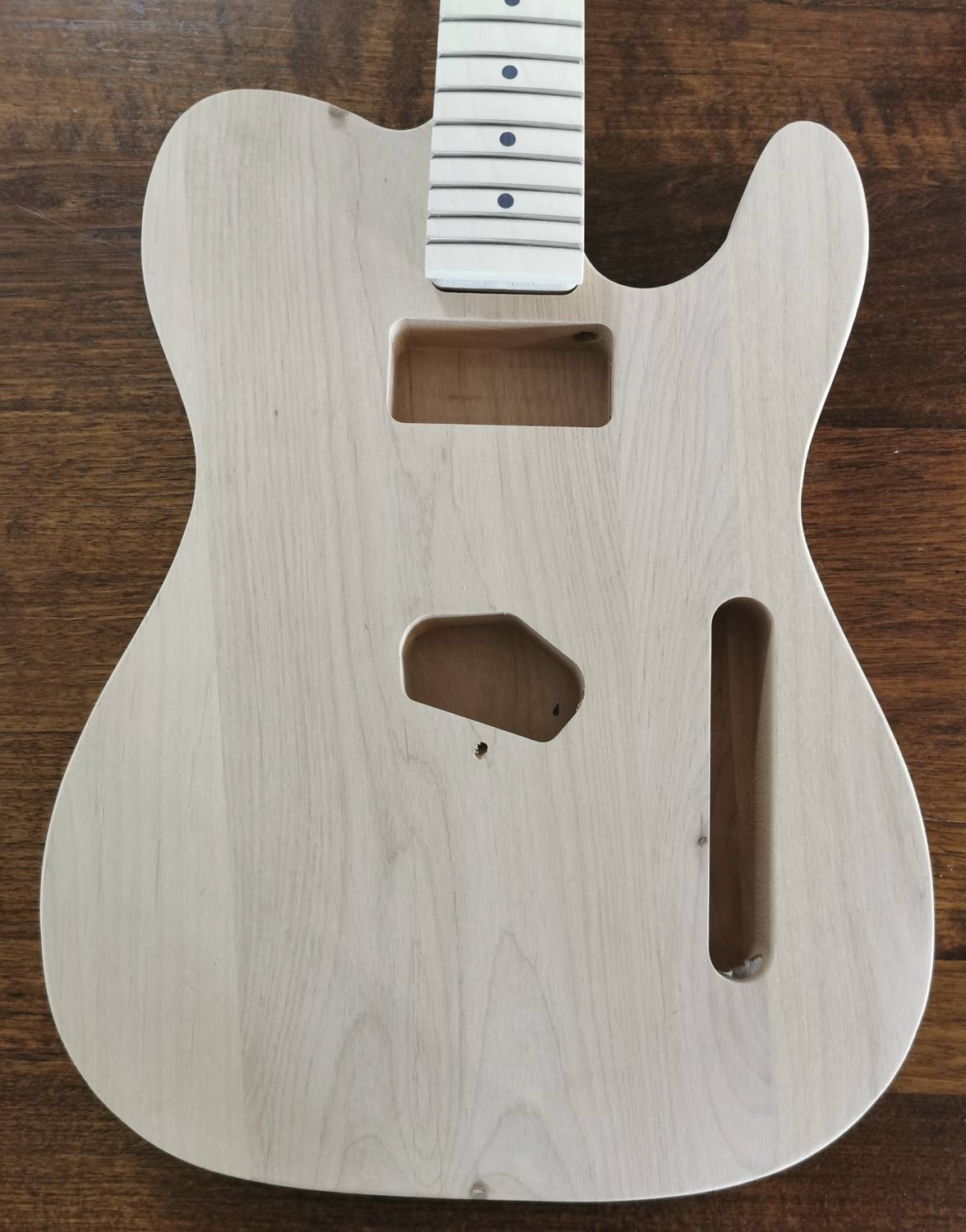

    Hi everyone,
    So my Christmas present arrived a few weeks early and everything is looking good. A few minor dings, and a rather unfortunately located knot. Looking forward to the build, I'm sure I'll learn a huge amount.
    Only just looked through everything and the first observation is that the neck is an incredibly tight fit. I don't suppose that's too big of an issue as long as everything lines up properly.
    Still undecided about what to do with finish. Have to come to some sort of conclusion soon, but I'll get to the test build first, and keep running around in circles trying to decide.

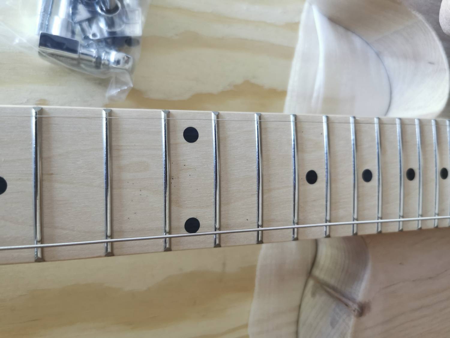

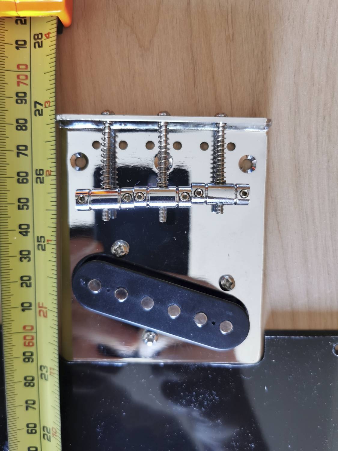

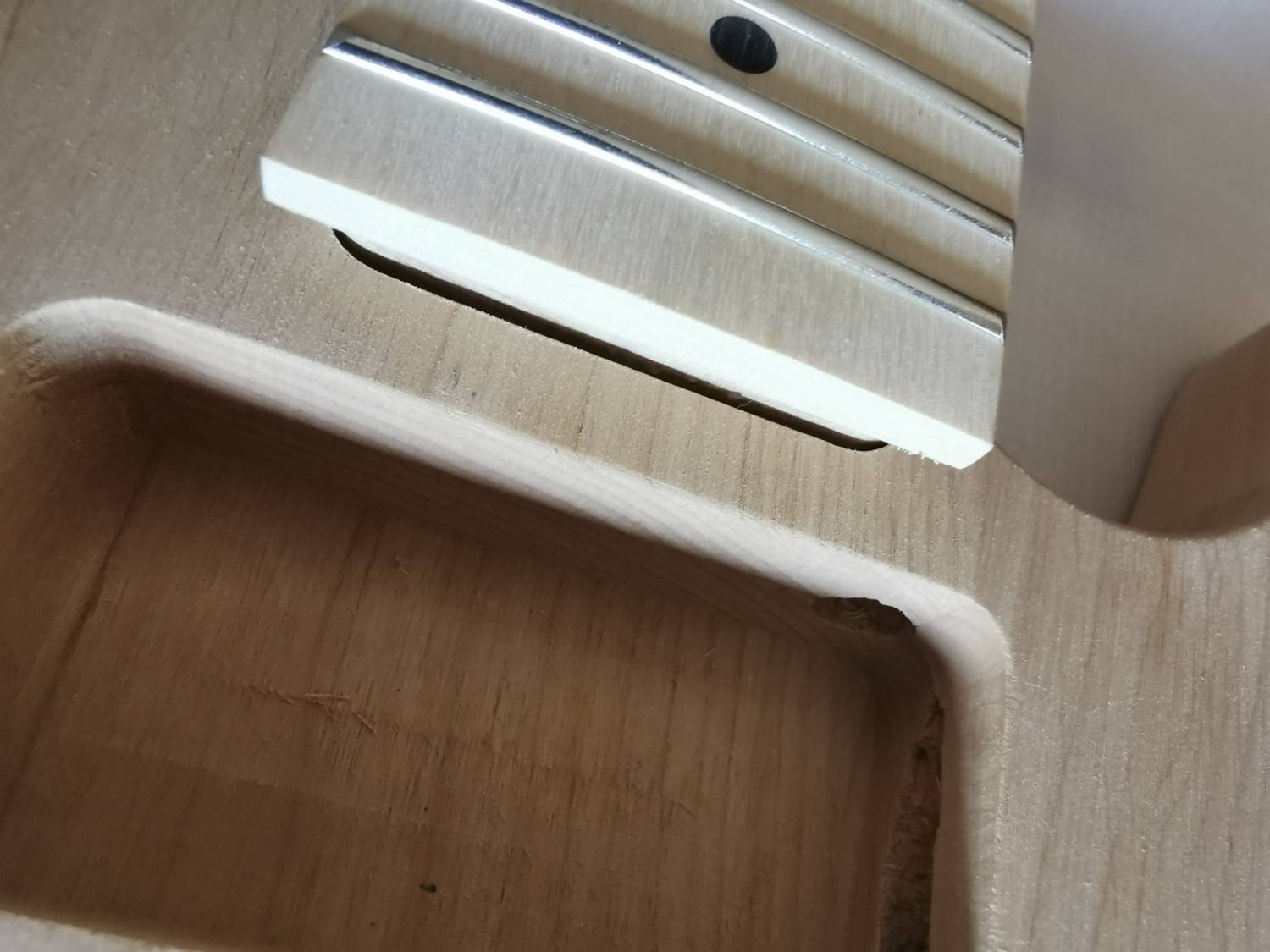

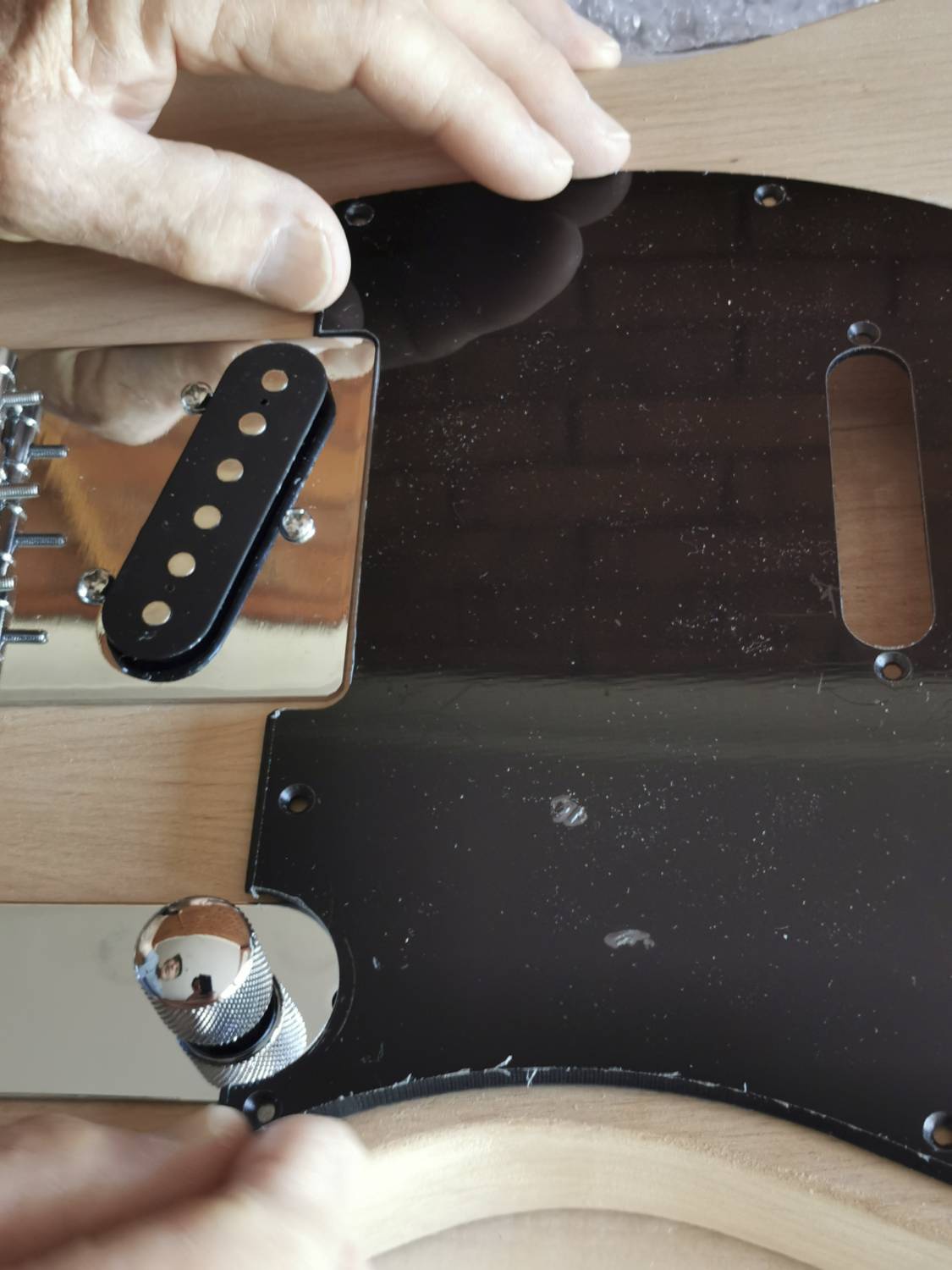

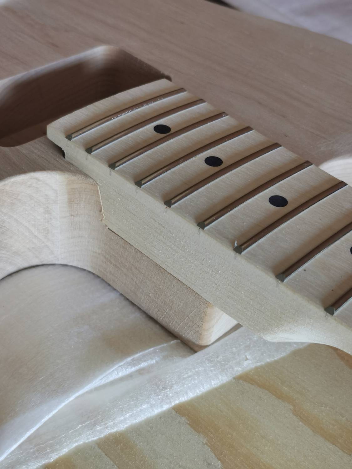

    Ok. Fun day test fitting and measuring.
    First observation - the tonerider bridge pickup doesn't fit. From what I've read here that's not unusual. So I'll need to make a bit of room. Looks like it'll only be a mm or so on the sides.
    Neck seems to fit nice and snug, although there's maybe 1-2mm of room at the end which I could recover if I sanded out the edges a bit. Given the scale length question, is that something I need to worry about? (see photo)
    Pickguard doesn't fit the neck properly. It's a bit too narrow. I'll have to file that out a bit. I'm looking at a few alternative options there, but for the moment opening that up a bit will help.
    Bridge position seems out if my measurements are correct. Looks to me like the scale length is a little bit too long although I think it's close. Interested in your thoughts given the measurement in the photo.
    Neck itself with strings installed looks ok. That was a bit of a rush job - probably have to do that part again. Still, doesn't look like the strings are too close to the edge on either side.
