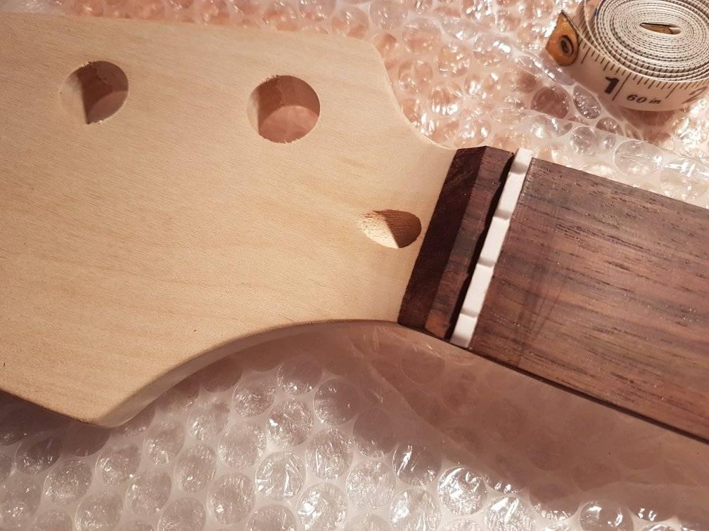

    So after a few years of saying I would build my own guitar form a kit, I've finally gotten round to doing it. And as I dont currently own a bass, I thoguht a bass kit would be a good place to start.
    I'm a lefty based in the UK and finding a supplier of lefty kits here is not easy. Pit Bull to the rescue. Kit came in 5 days, so I'm well impressed with that. However, although its a lefty kit the neck had a right handed nut in it - ie it was upside down - so my first job has been to flip the nut!
    As you can see, lefty neck, righty nut.

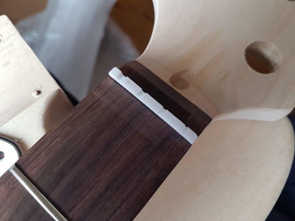

    And now the nut flipped. It was stuck in pretty well tbh. Wasn't sure it would come out without having to saw it and get a new one. But we got there!

    TBH, you'd probably benefit from replacing the nut anyway as the kit nuts are plastic. A bone, graphtech or even synthetic bone will be a big improvement.
    If you choose to use the kit nut, after you've flipped it be sure to check that the string slots aren't sloped the wrong way (I can't tell from the photos). If they are sloped toward the fretboard (instead of toward the headstock) they will need to be filed appropriately. However, there may not be enough material after filing the slots to provide clearance for the strings at the first fret.
    You may be fine with the kit nut, but some things to be aware of.

    Hi and welcome.
