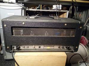

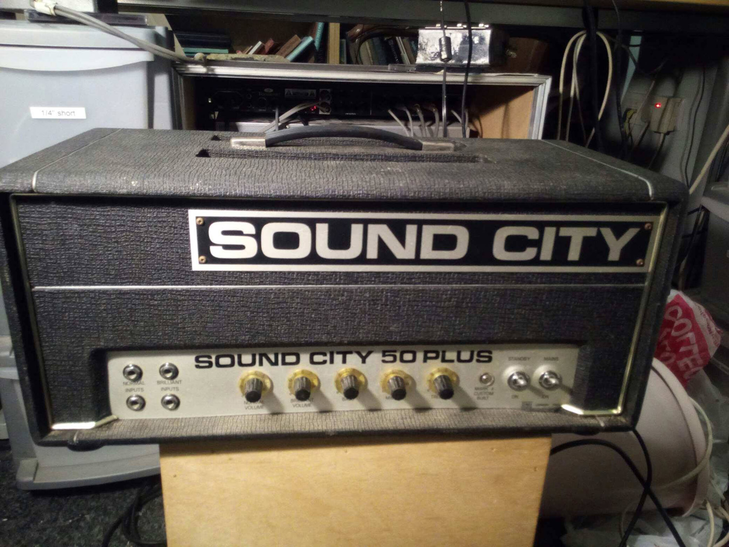

    A friend of mine has unearthed a Sound City 50 Plus valve amp that has been in his loft for at least 10 years. It's a non-master volume amp with normal and bright channels. I'm interested in it, but he's scared of powering it up as he can never remember it being used. It was his partner's son's amp (he moved out 10 years ago), and he knows that the son never had a cab for it, so he may never have used it.
    He's had a look inside and there are no signs of leaky or damaged caps. He's vacuumed it out but there wasn't a lot of dust in there.
    I've told him to take the valves out first, check the fuses are OK, then fire it up with no valves in and make sure no fuses pop or smoke appears. Then stick the pre-amp valves in and run it again. If still OK, put the power valves in. (All done with the volume off and a cab connected).
    I know some people recommend using a variac to increase the voltage slowly, but there is none handy.
    Is my start-up suggestion OK? Anything else to consider.

    What you've suggested Simon is pretty much what I would do if I didn't have access to a variac.
    An alternative is to wire a mains voltage 100W incandescent bulb in series with the amplifiers mains, which if there is any short in the amp will cause the lamp to light up brightly, and will only glow dimly and reduce the voltage slightly to the amp if the amp is okay. The best way of doing this is to make a jig with a lamp holder and a suitable power outlet both securely and safely mounted to a small wooden board. Some may choose to include a switch to bypass the lamp to allow full voltage checks without having to re-plug things.
    Something to consider... Short of going over the entire amp with all the appropriate meters my usual practice when powering up old devices like this is to leave the amp on for a few minutes during the test... Caps are often a little slow to react to being put back to work.... Applying full voltage for 5 to 15 minutes once all the tubes are back in while maintaining a comfortable distance will inspire confidence that all is okay. Often it may take 5 or 10 minutes for a bad cap to build enough internal pressure inside before horribly and loudly detonating in one of those few moments while you are otherwise distracted..
