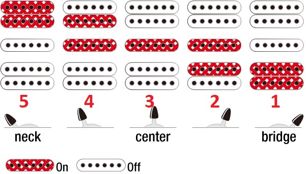

    Does the Ibanez make 2 and 4 positions effectively the same as having the middle and neck/bridge as single coils? So then only 1 and 5 give you the full humbucker, is that what you mean?

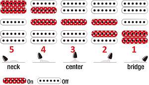

    Yes, it's called "auto split". No push-pull pot required. Standard 5-way lever switch.
    Position 2 gives one coil of the bridge HB and the middle SC. Position 4 gives one coil of the neck HB plus the middle SC.
    The HB's coils are split so that they are RWRP to the middle SC thus still being hum-cancelling.

    Ibanez gives you
    1) Bridge humbucker
    2) Split Bridge + middle
    3) Middle
    4) Middle + split neck
    5) Neck humbucker
    So positions 2, 3 and 4 are all quite Strat like
    The wiring on a Jem will also add in a switched pot to always bring in one of the humbucker outputs in addition to what else is selected, so unlike the standard wiring, you can also get the two humbuckers in parallel, (like the mid position on a Les Paul), as well as an 'all three pickups on' selection (plus three duplicated positions).
