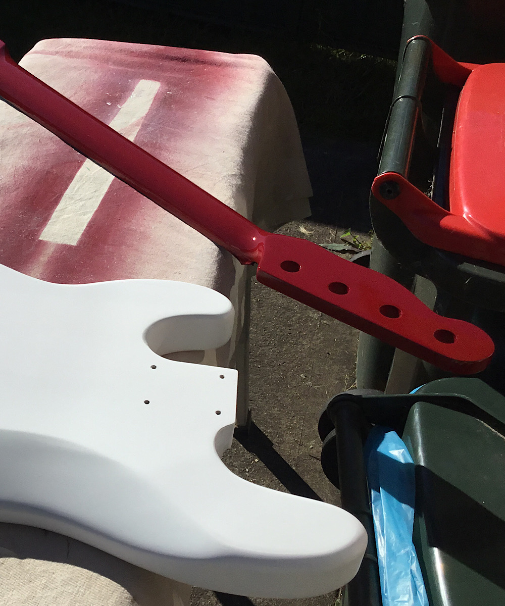

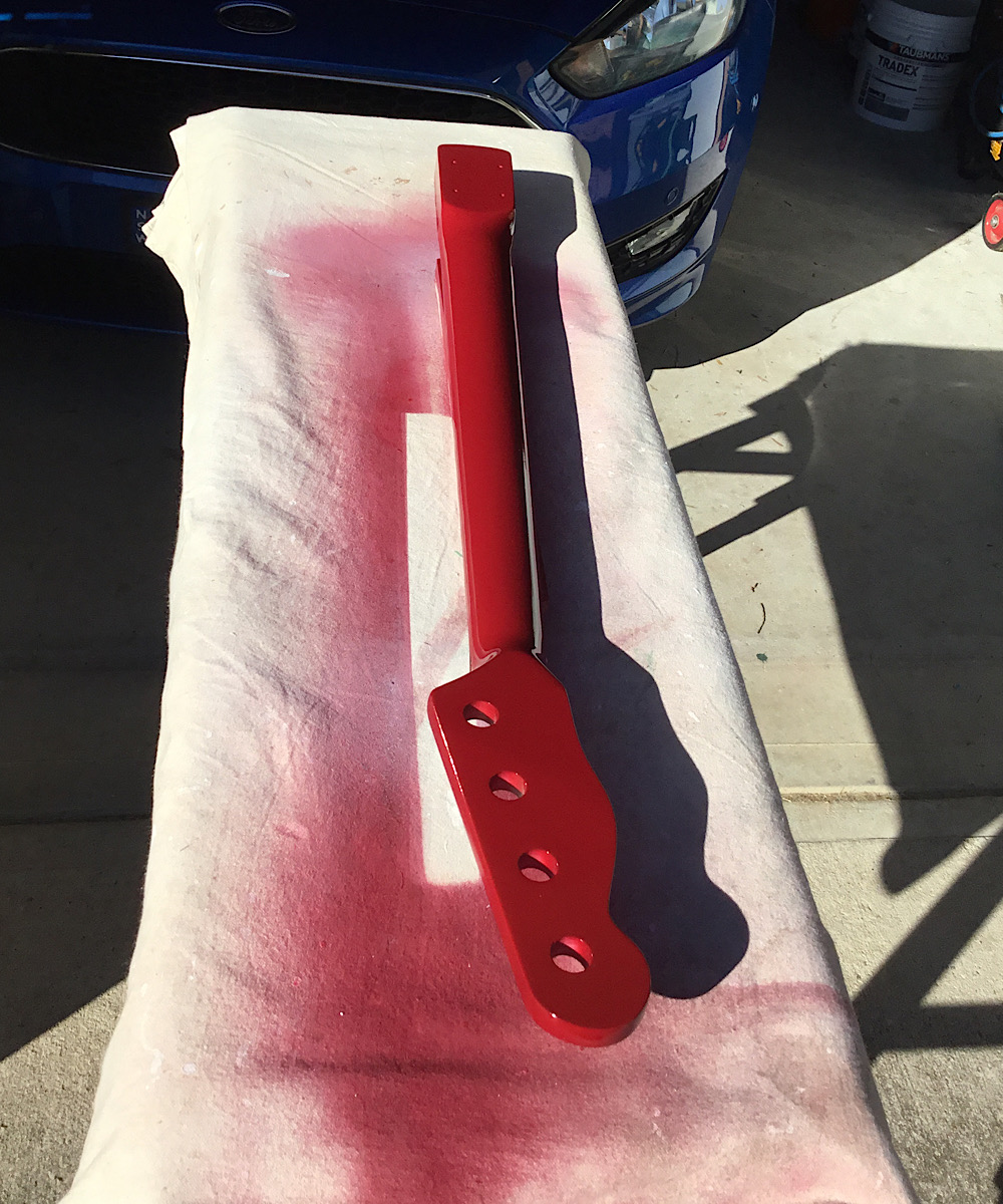

    O.k. I have decided to use Duramax primer/undercoat by Dulux, I have used it before on my axe bass. The only problem with that is that they don’t have a corresponding red colour I need. So I got some Duplicolor “Hermitage” which is pretty close. I have tried a small test swatch and it seems to be fine over that primer. Two coats of primer and it’s looking good. Pics to come, too dark out to get pics now.
ID:	40765Click image for larger version.
    Some Pictures of my progress, I am really liking this Duramax primer, goes on well and sands easy.
    Build-1 ES-3 June 2016 GOTM.
    Build-2 IB-1S
    Looks good. The colour match looks pretty dang close (from what I can tell from the original photo). It has a nice gloss to it's on it own too.
