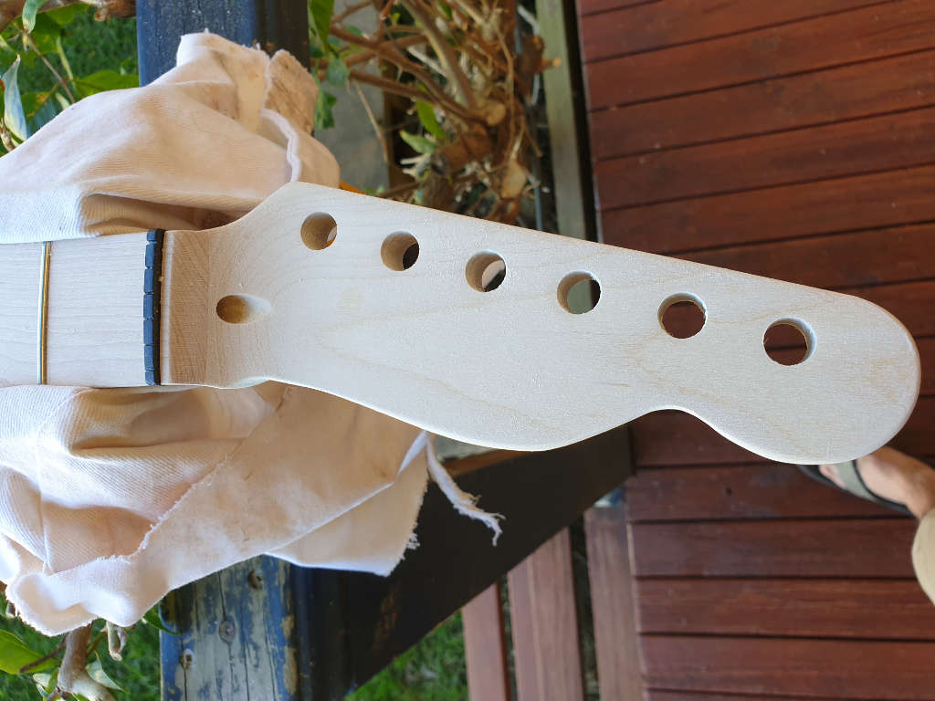

    My second question is in regards to the head stock pattern as I have done a rough sketch by hand and like the slim look but not to sure if it will be to close to the tuning holes?
    From what I can tell teles have a bit more distance especially near the second to last hole

    I did a real slim headstock on my tele and it's fine. Not sure of the distance to the B tuner but I could measure it.

    Do the mock build first, measure your scale length as all guitars have slight variations, better to do as much drilling and preparation before doing the finishing. Measure twice, cut once.
    Hmmmm.....Headstocks, probably the second most controversial topic in the BYOG world. Is it too big, is it too small, will the girls like it? There is a train of thought that says the bigger the headstock, the more sustain you have. Design wise, this is where you can really make it your own piece of work. Take your time, look at other designs and develop your own style. Seems a shame to do all the other work and just copy Leo on the headstock. Patience is the key to building. Be happy with your design before you cut anything. Good luck mate. Love the colour so far.
    FYI, my headstock is 34mm from one side to the other at the narrowest point. Easier than measuring to the hole with the tuner installed.
    Hi Jackson. Welcome.
    In regard to setting out the bridge, measuring the full scale length from the fretboard-side of the nut is better than 12th fret x 2.
    I would say your headstock design would be fine. The only point I would check is the distance from E & B tuner holes to the narrowest part of that upward curve (IYKWIM).
    My teles range between 16-18mm from the bottom edge of the holes perpendicular to the apex of the curve, if that makes sense.

    FYI: if using those templates, don't worry too much about matching the tuner holes exactly. The kit tuner holes are not the same spacing, start/end positions as genuine Fender headstocks. However you can still extrapolate the shape from the template to get what you're after.

    I think your headstock looks wide enough, similar to mine. I tend to like the traditional shape as it’s hard to make it match the body otherwise, although there have been some amazing custom shapes used.

    I checked my measurements for the headstock and I got 15mm from b tuner and 35mm from top to the apex of the curve (The IYKWIM is a little over my head)

    Seeing yours though m0j0 reassures that I want that slim look to mine and I didn't know about the size relating to the sustain that's cool!
    I'm going to have a look at the templates and will probably allow 10mm in my cut and work it back untill I'm happy

    This is what I meant, and how I measured my teles:
Name:	tl hdstk.jpg
    Same, same. Yours should be fine.
