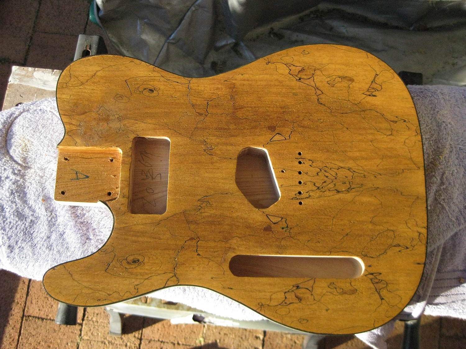

    Progressing slowly on this one.
    Still thinking about the electrics but I have started on the body.
    Sanded the body smooth but only lightly rubed the maple cap. Too thin to sand very much. But the surface coating will smooth it out.
    Had some nice yellow ash stain left over from the strat build so applied a couple of coats to the maple cap.
    I am quite happy with the colour and the grain of the maple cap still shows through nicely.

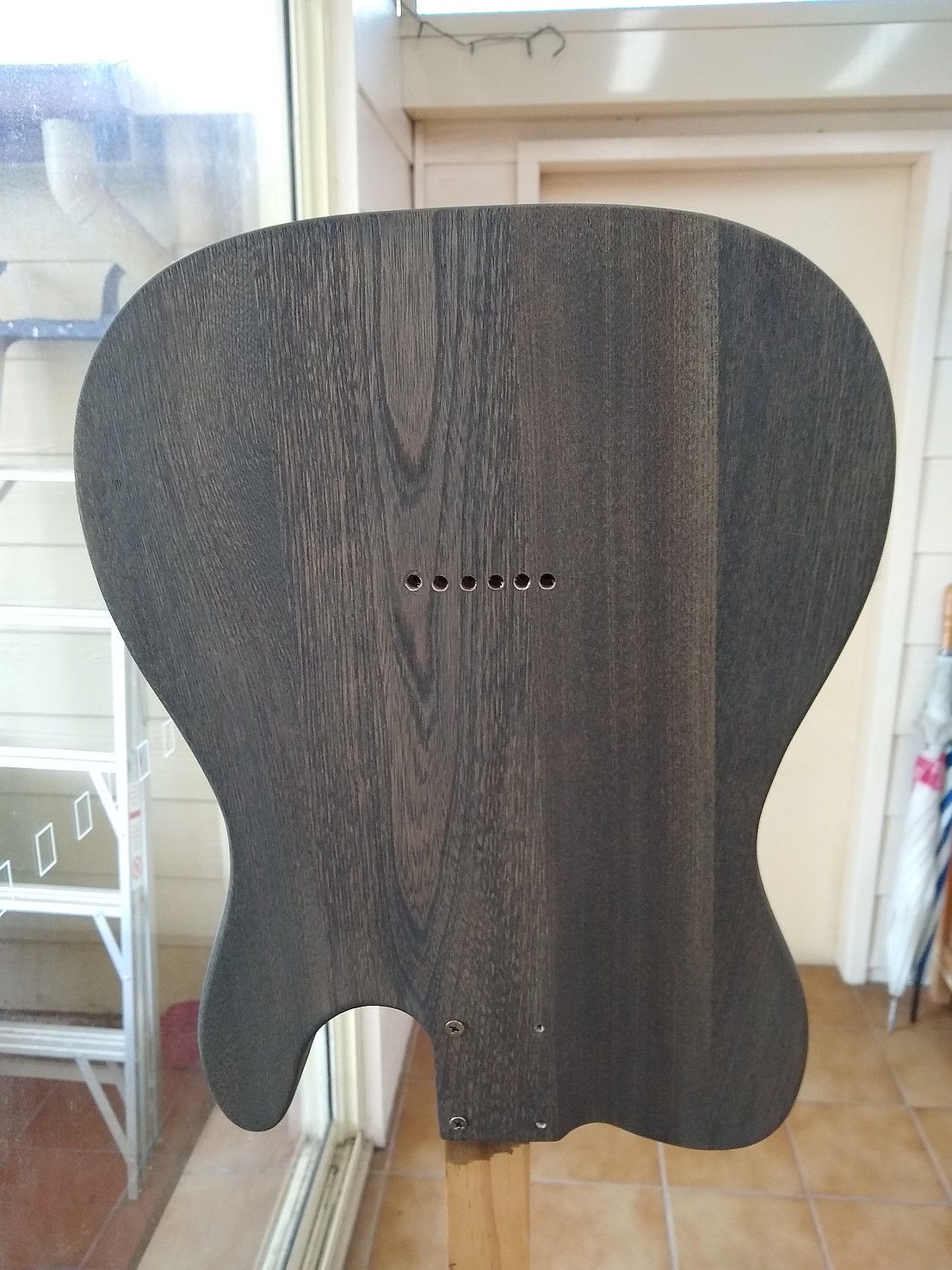

    This is the last build I will be doing so thought I might go for something different.
    Some charcoal coloured stain for the back to contrast the yellow ash stain on the cap.
    I do like the way it brings up the grain in the basswood.
