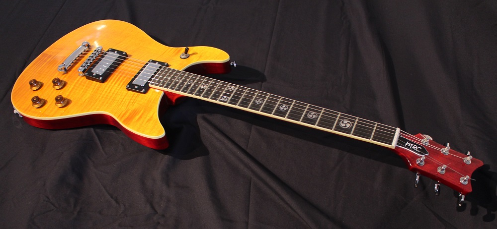

    If you're doing a red based colour similar to the photo in your OP, I don't think you have much of an issue with Tru Oil.
    This is my PRS1-TS which has kind of a cherry colour on the neck & back. It didn't really go noticeably darker IMO.

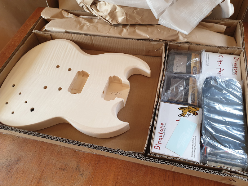

    Happy days - shipment arrived today. Expecting two boxes and only one arrived. Delivery guy said it's a short shipment and I'll probably get the other box tomorrow, however the tracking now has the whole shipment with a status of delivered which is a little concerning (already logged a ticket with Aus Post).
