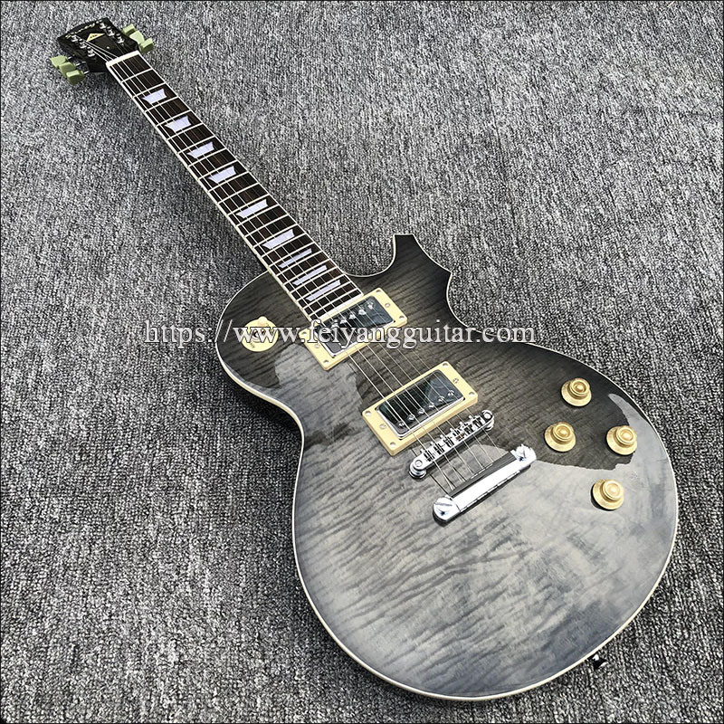

    The spalted maple veneer on the kit looks amazing, but I want to stain it silvery-grey.. has anyone had any experience with how maple accepts that kind of colour? I've googled around quite a bit, but it's really hit-n-miss what's out there.

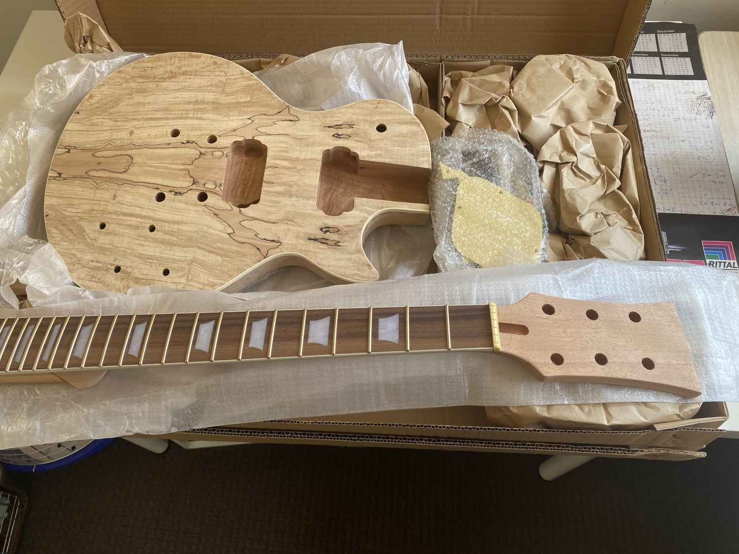

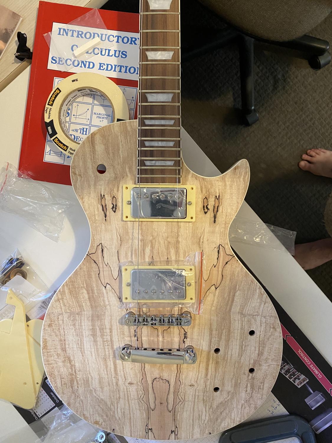

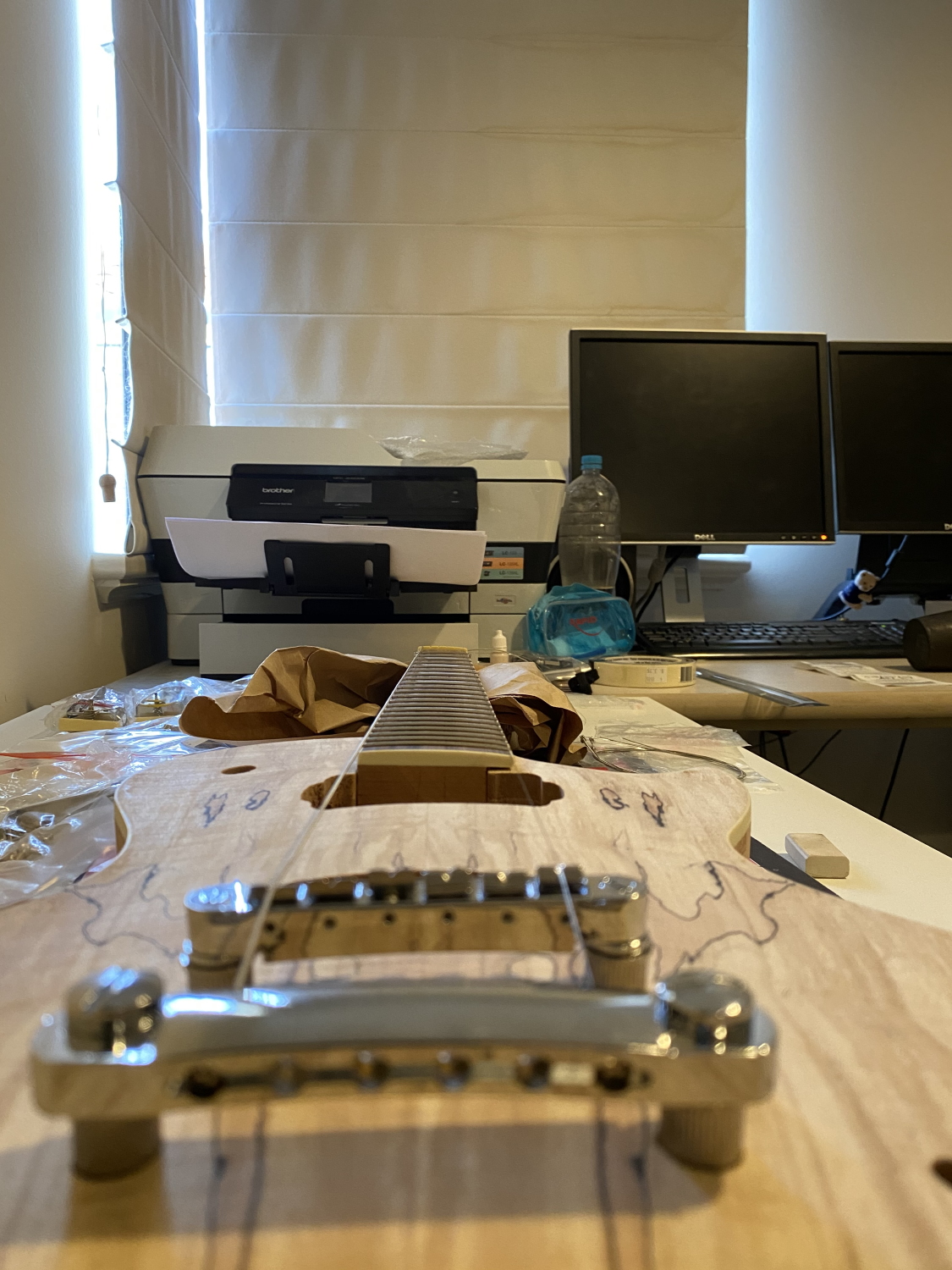

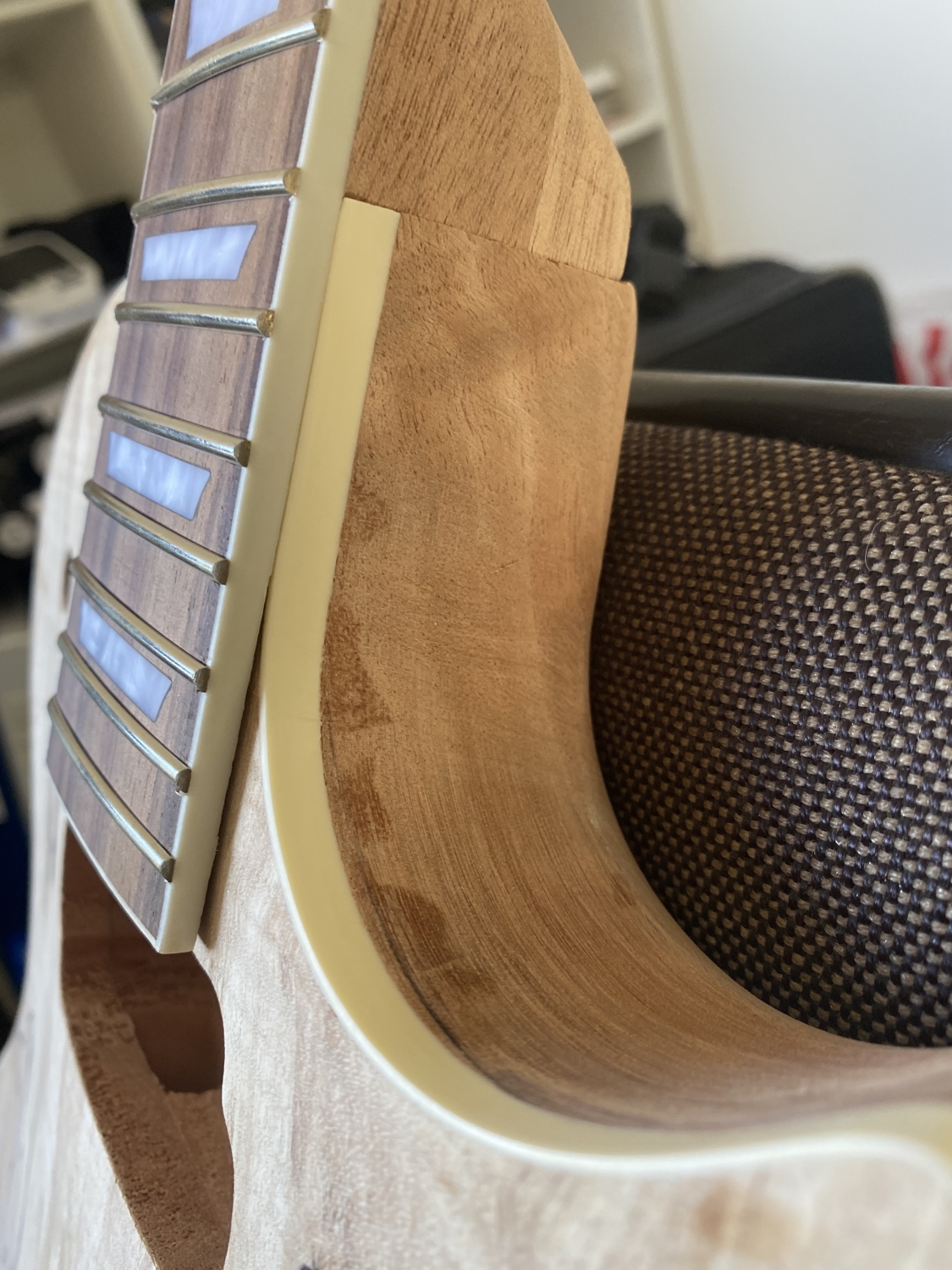

    I've attached a concept photo of something similar to what I'm trying to achieve, and a couple of intro shots of the guitar kit.
    My first real question tho, how hard should the bridge/saddle anchors need to be banged in? I mean, I get it that they have to be tight, but I'm worried that the pre-drilled holes are actually a little too snug, and I really don't want to have to smash the anchors down and potentially damage the wood. Obviously I haven't hit them all the way into place for the test fit, but is it common to need to sand out the holes slightly to get them to fit a little easier?

    In my experience it is not necessary to expand the holes for the bridge and the anchor bushes just tap them in with a piece of timber and a hammer. It may feel tight but you should not damage the mahogany below the veneer. Of course it will be one of the last things you do after the finish is completed but it is good for them to be tight.

    I don’t know for sure, but it looks to me that the flame maple guitar in the picture was first lightly stained black, to pop the grain, then sanded back so most of the non-flame wood was back to natural. It’s then been sprayed with a tinted grey or black lacquer. There appears to be a very slight burst around the edges to me. Then there will have been several costs of clear sprayed on top.

    I find that the kit holes are a bit on the tight side. There's normally a small solid section on the bottom of the inserts before the splines start and you want the hole to be the same size or only just smaller. Measure the width of this section to check the size hole you need. If you haven't got any digital callipers, get some. I use mine all the time on my kits. The cheap digital callipers from Amazon/eBay are certainly accurate enough for this sort of work. I normally run a 12mm (IIRC) drill into the holes to widen them slightly to what I find makes for a good fit where they can be easily tapped in but are still firmly held. But don't go larger than that un-splined centre section.
    And don't tap them in at this stage of the build or it will be very difficult to put your finish on the top. Wrap electrical or masking tape around the screw-in posts so that they sit in the holes well enough without the inserts.
    And certainly don't forget to fit the bridge ground wire before you tap in the treble side bridge post insert.
