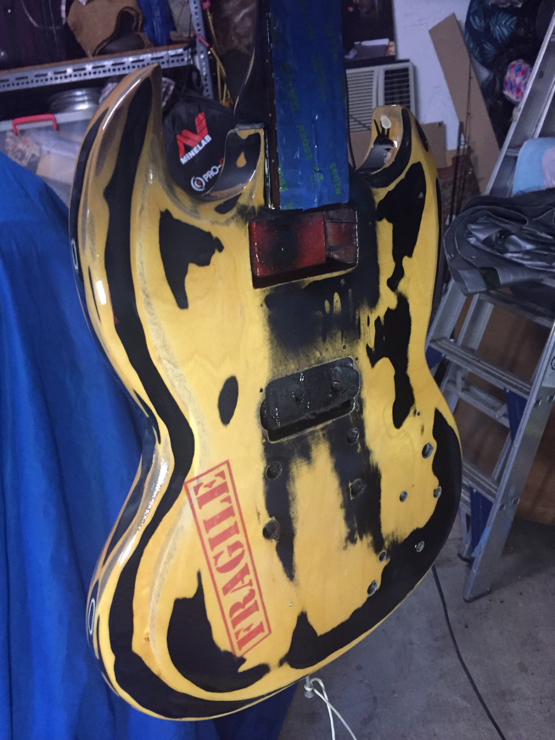

    Yes Simon, SG copy. Yes HarmonIser, I routed the front cavity out with a Dremel and added some 3mm ply to fill the side in.
    I actually swapped the idea over to a SG copy guitar I had sitting around for a few years. I battled with it for weeks with the paint I had and got sick of sanding it and painted in gloss black and left it at that. Yesterday I sanded it and thought, that's it, a clear coat and it's done! Haven't seen you around here for a while Simon. Good to see you back again..
