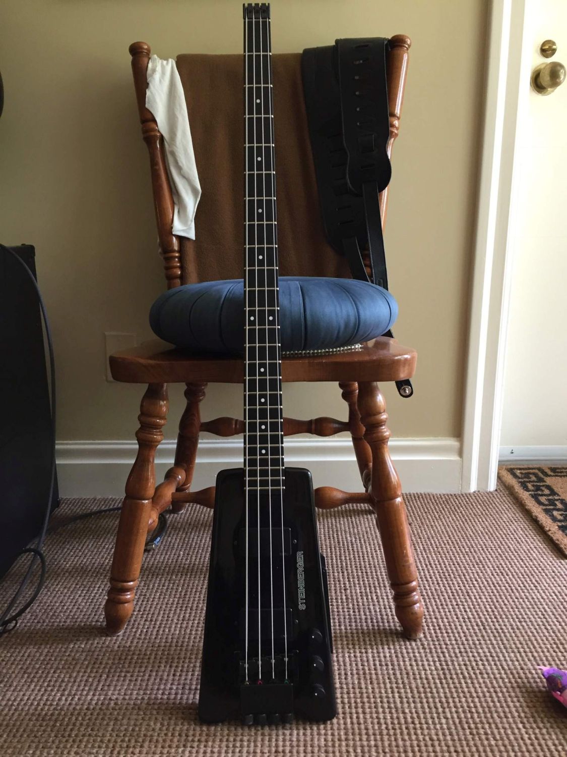

    I am seriously contemplating a Steinberger XL headless bass and will upload some photos over the weekend to see what you might be able to do.
    Typical 34" Bass scale and may even contemplate neck through too.

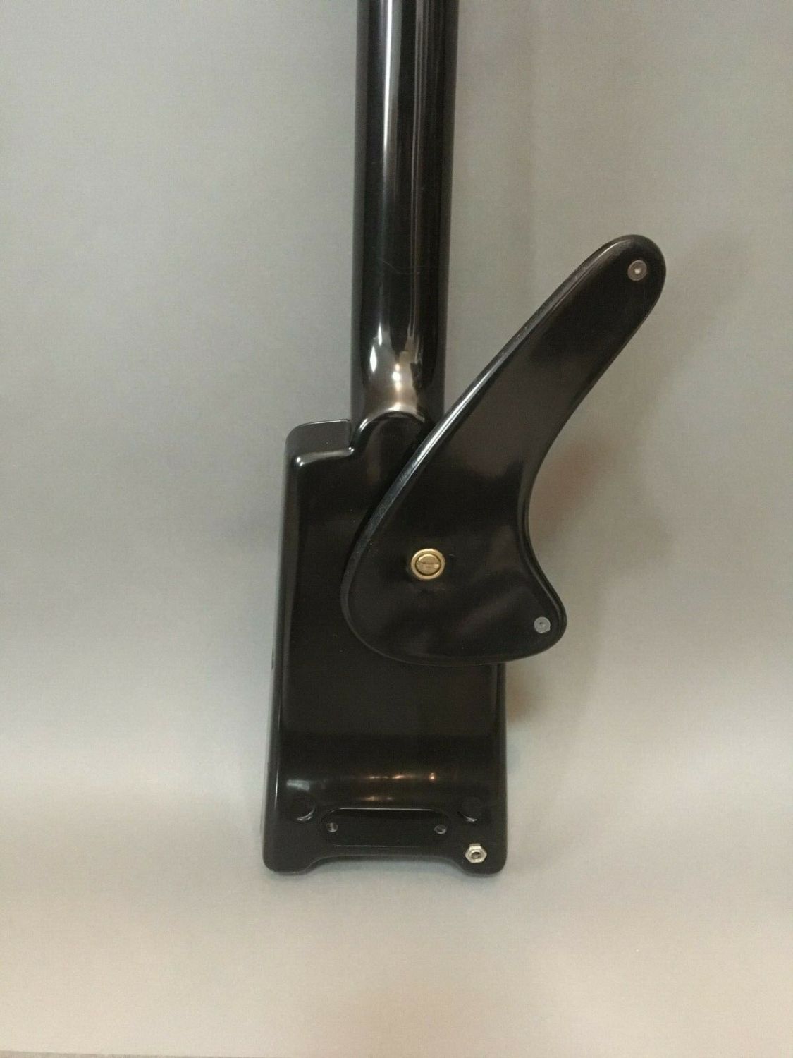

    Hi Woltz, here are some Steinberger images to work with....they originally started out with the more rectangular brick shape that over time tapered out a bit, and at one stage they also did a small V shape too. That weird boomerang shaped thing was the original strap connection setup and could be a bit too hard to replicate and on subsequent models it was left off (ie. the Spirit models in recent times).
    Thanking you in advance, Waz.
