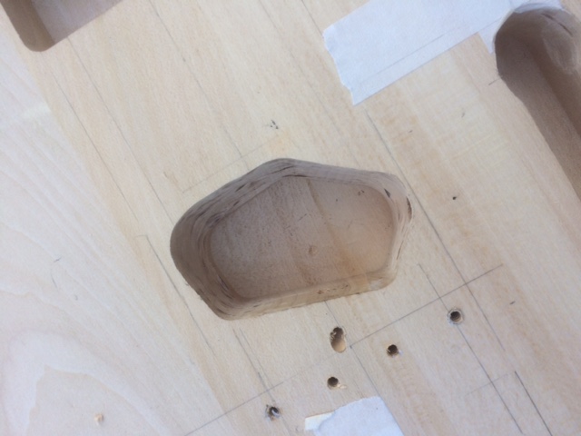

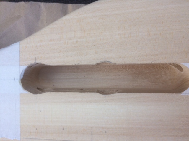

    Lots of measuring, thinking, measuring, thinking, reading online etc etc. Just to add a bit of excitement to my first build the ToneRider Bridge pickup base plate is slightly bigger than the routed cavity. The upgraded pots are also a tiny bit wider than the cavity and the 4 way switch is very close to the bottom.
    Act of bravery - out with the dremel. Put the dremel away and measure, think, measure etc etc.
    Before
    After
    and
    I'm installing the controls the wrong way around to personalise it a bit. I may have to take out a bit more under the switch to allow for shielding. Need to be accurate as there's not that much room for error.

    Well done so far, looking good mate.
    4 way switches are quite deep and need a bit more depth to allow for attached wires too.

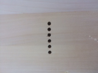

    Drilled the through string holes
    My portable drill press would only reach the outer holes. Had to make a jig - lots of test holes and here we are:
ID:	31203 Click image for larger version.
    Bit of tear around the ferrule holes - will be tidied up when filling for painting but a good lesson if I do a natural finish on another project
