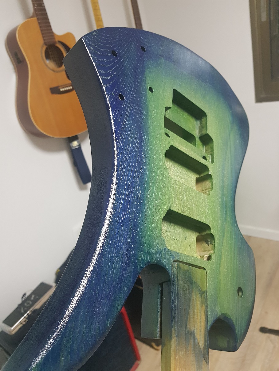

    i'm building an MBM-1 with a floyd
    i have pre drilled holes in the body, as i understand i need to mark the holes with the neck "mounted" with a clamp and with 2 strings so i can measure - how much of the floyd rose do i need to install for that to happen?
    do i need to put up the mounting posts for it?
    do i need the springs or can i rest it on something?
