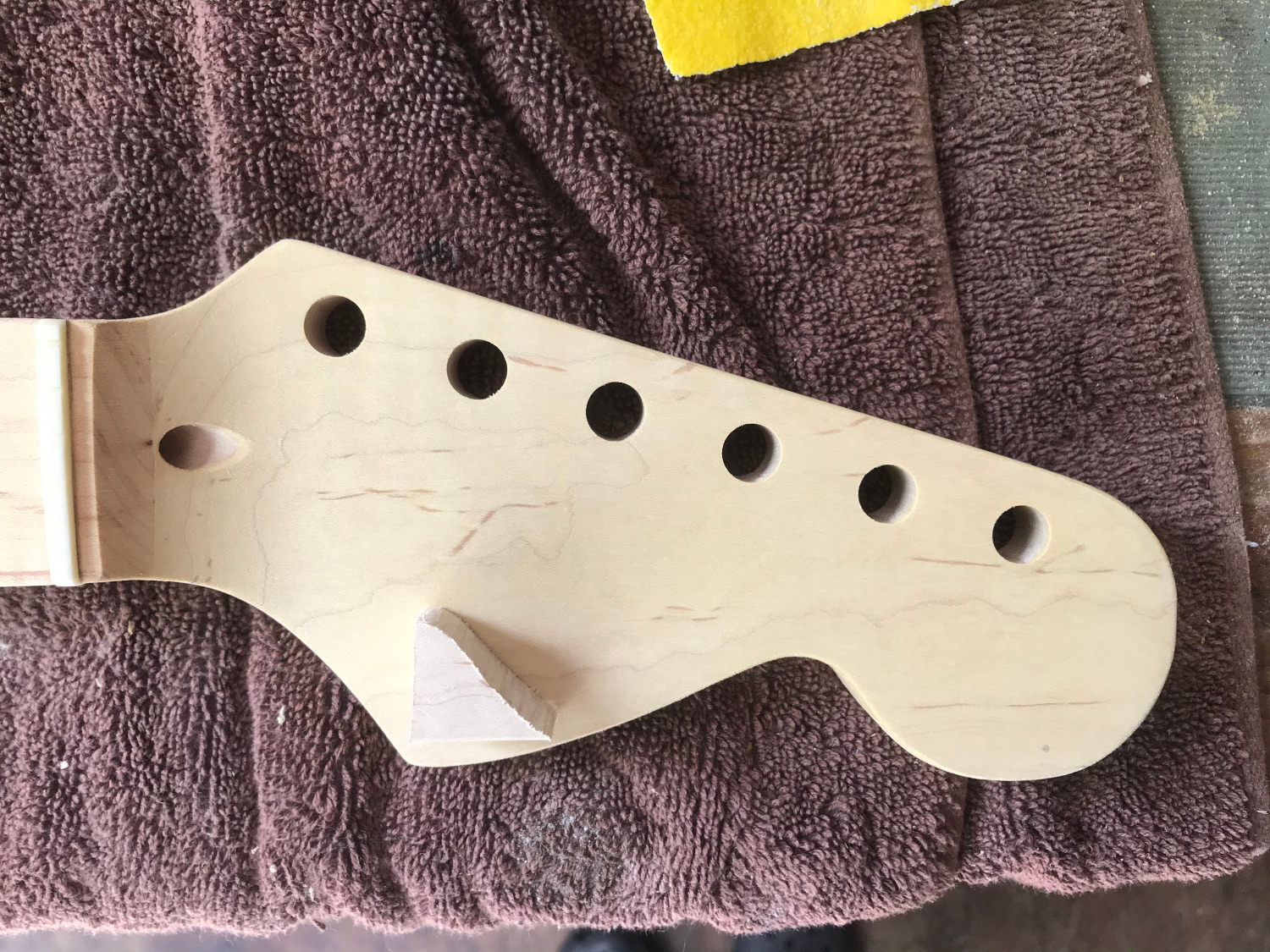

    Here's my current build. I was thinking of adding a few drops of FW Prooftint to Tru Oil, but everything I read about doing so made it sound like a bad idea. In the end, I have diluted the stain - 2 teaspoons (~10ml) of FW Colour Reducer to 5 drops of FW Golden Teak Prooftint. Here's the headstock after a couple of coats. It's very subtle - I haven't decided whether I'll put any more stain on. I haven't put any TO yet.
    Unfortunately I don't have any maple to test this on, and my other test pieces (some ply, for example) didn't really reflect the end result.

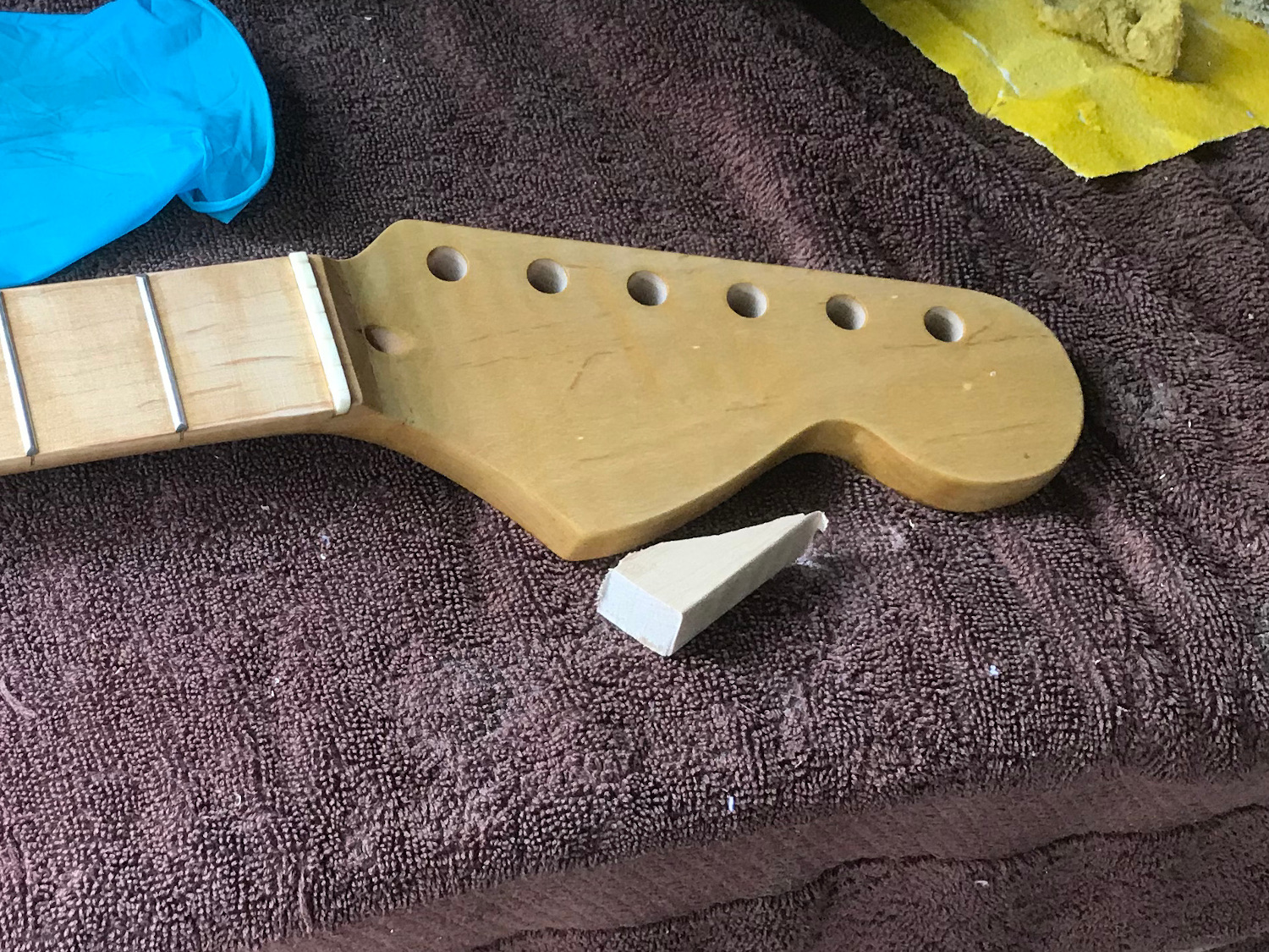

    I've got a couple of coats of Tru Oil on mine now - here's how it looks. I'm pleased with the colour - what was a very subtle shade after only the stain has got much deeper with the Tru Oil.

    How many coats of Tru Oil have you put on? The colour definitely is starting to get deeper, did you add colour to the Tru Oil?
    Member jonwhitear's Avatar
    Sydney, Australia
    262
    I didn't add any colour to the Tru Oil - this is with the diluted stain on first, and then two coats of TO.
