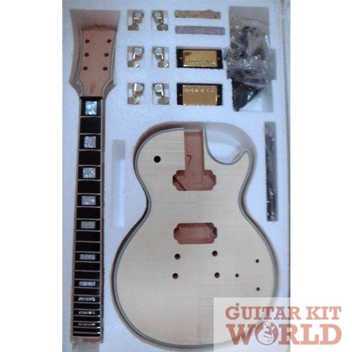

    I was excited when I came across a LP custom kit that had the full on 7 ply body binding and 5 ply headstock binding with legally questionable shaping.

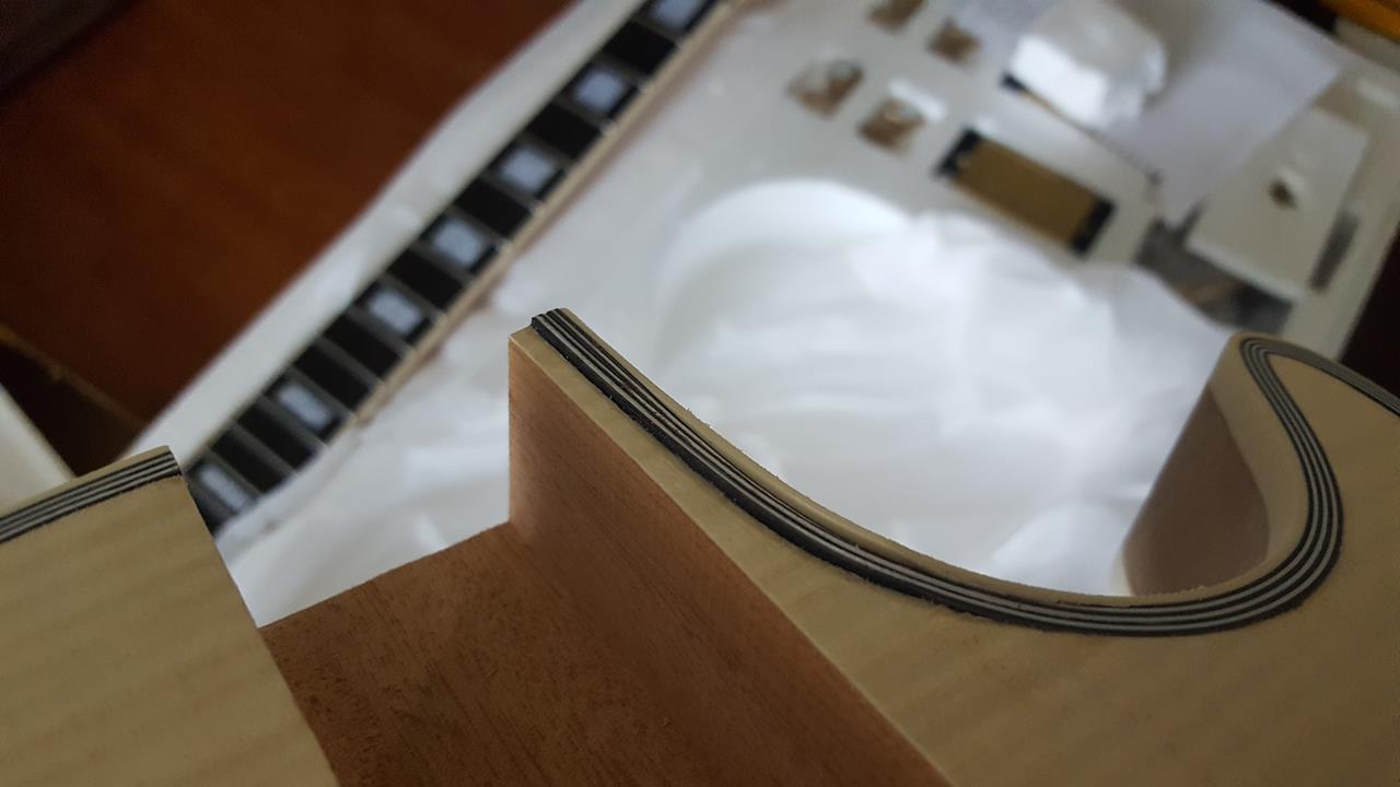

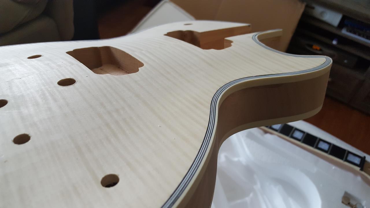

    When the kit arrived I gave it a once over and noticed a few issues. Luckily they weren't going to affect the finished product. The flame maple veneer had the joint line skewed and off center, but I'll have a solid black finish so no big deal there. The binding work was rough around the cutaway. This was easily scraped down though.
ID:	19042 Click image for larger version.
ID:	19043 Click image for larger version.

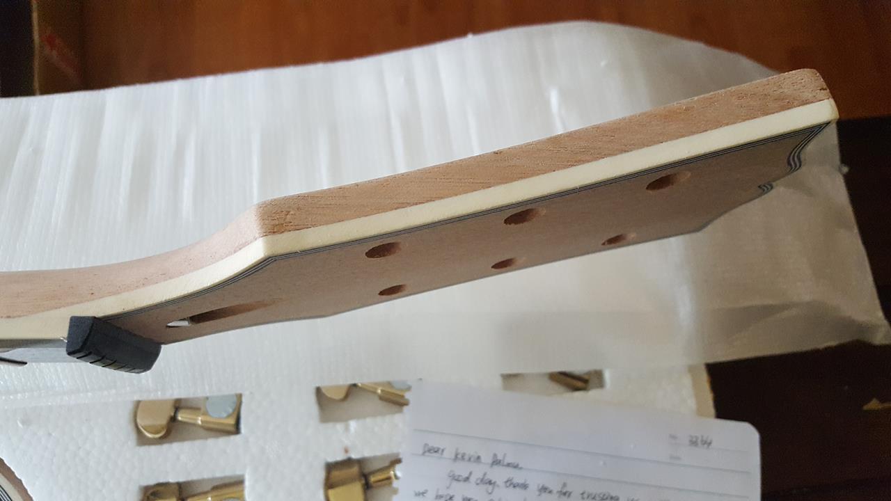

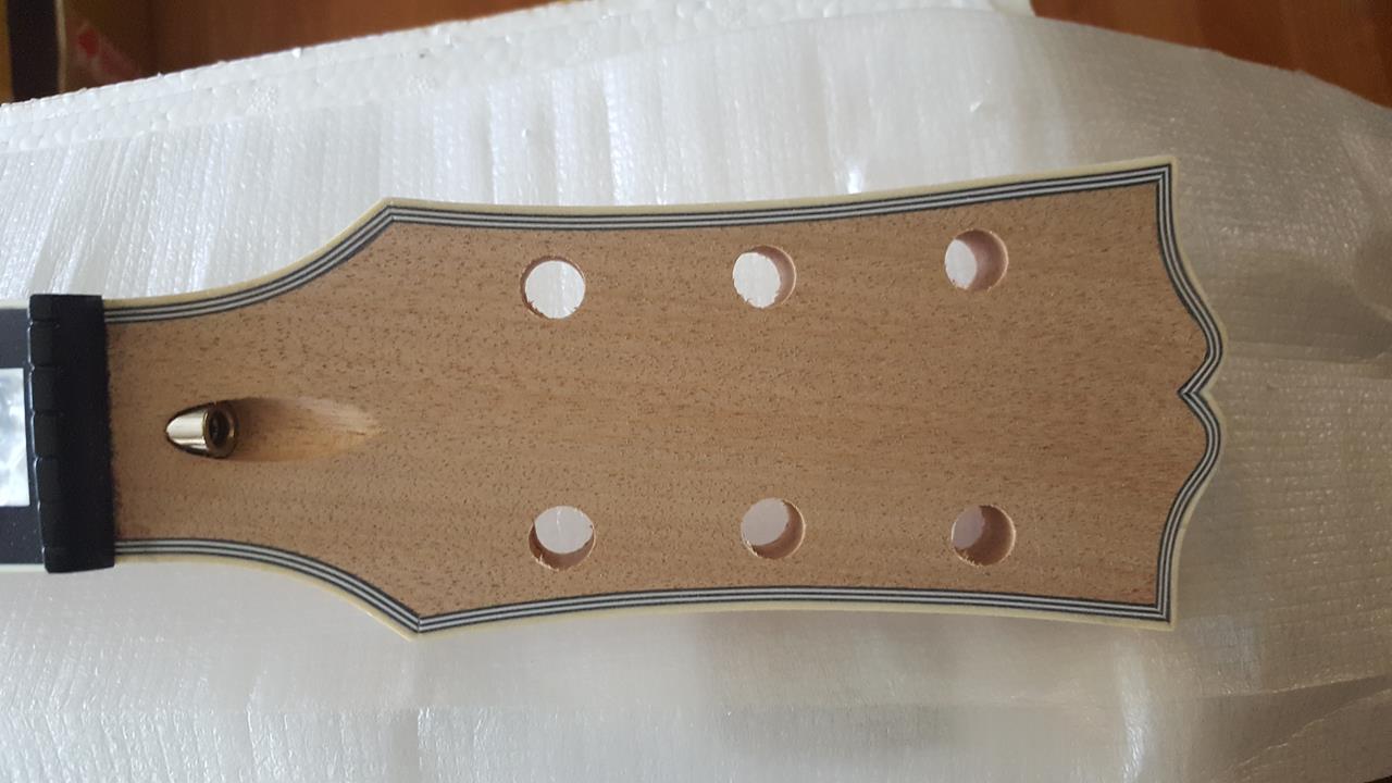

    The shape and binding on the headstock looks pretty good. I straightened the neck and checked the frets, which were pretty level. That was a relief since my last LP kit took a whole lot of work to get playable, and even still has to have high action.

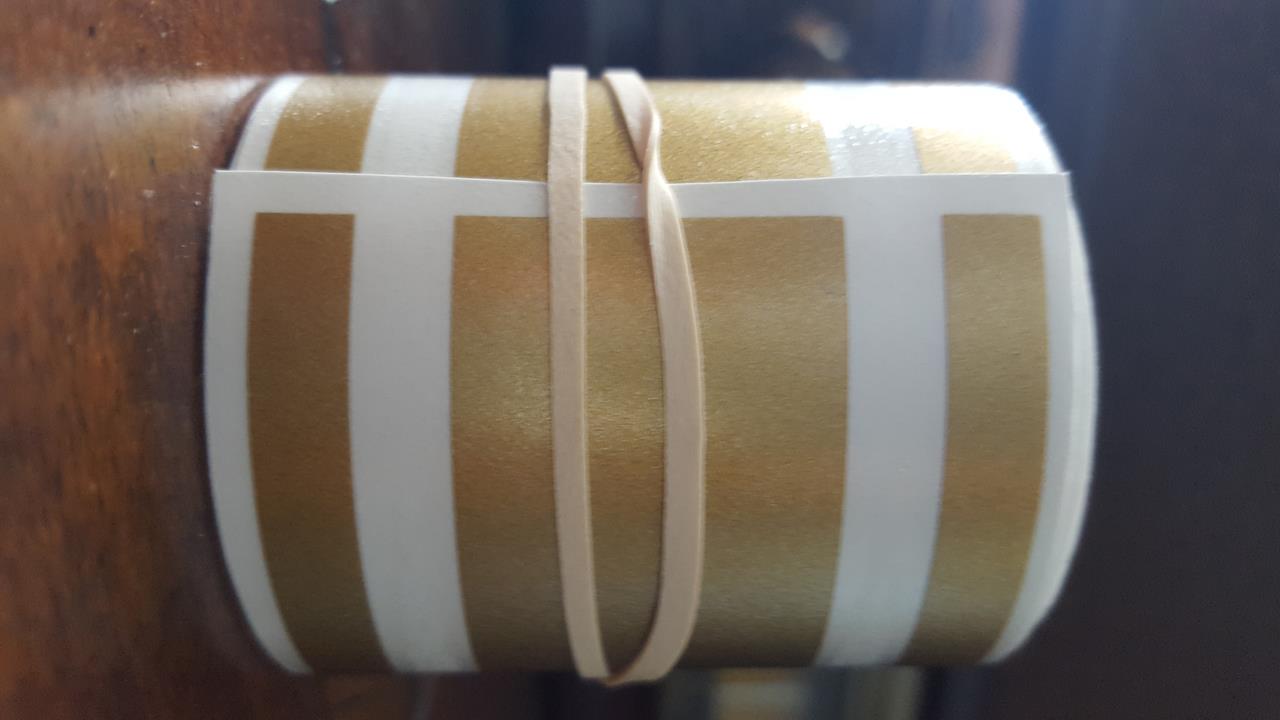

    So I needed to get a few additional parts to supplement the kit for this build. I found some gold vinyl racing stripes that looked to be about the right size that will go on after the finish is applied. I'll be replacing the stock tuners with satin gold Sperzel locking ones as per Mr. Hetfield's preferences (and mine too, now that I've used locking I don't think I can go back!). Not pictured below is the 'Custom' headstock decal that will go unnamed for now.
ID:	19055 Click image for larger version.
