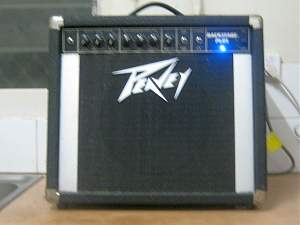

    Thought that I would start a thread about re-visiting my old Peavey Backstage plus guitar amp, since I'm doing some work on it at the moment, I need to re-connect the speaker ( a Jensen C10Q 8 Ohm 35Watt Speaker I bought for it a couple of years ago) up to the amp chassis, re-attach four metal corner-protectors, and put some knobs on the pots.
    As far as I know the amp is in working condition, I'll post some pics in this thread for you guys soon.
    I also need to make a new footswitch for it too, yet another fun-filled project.
    Update:

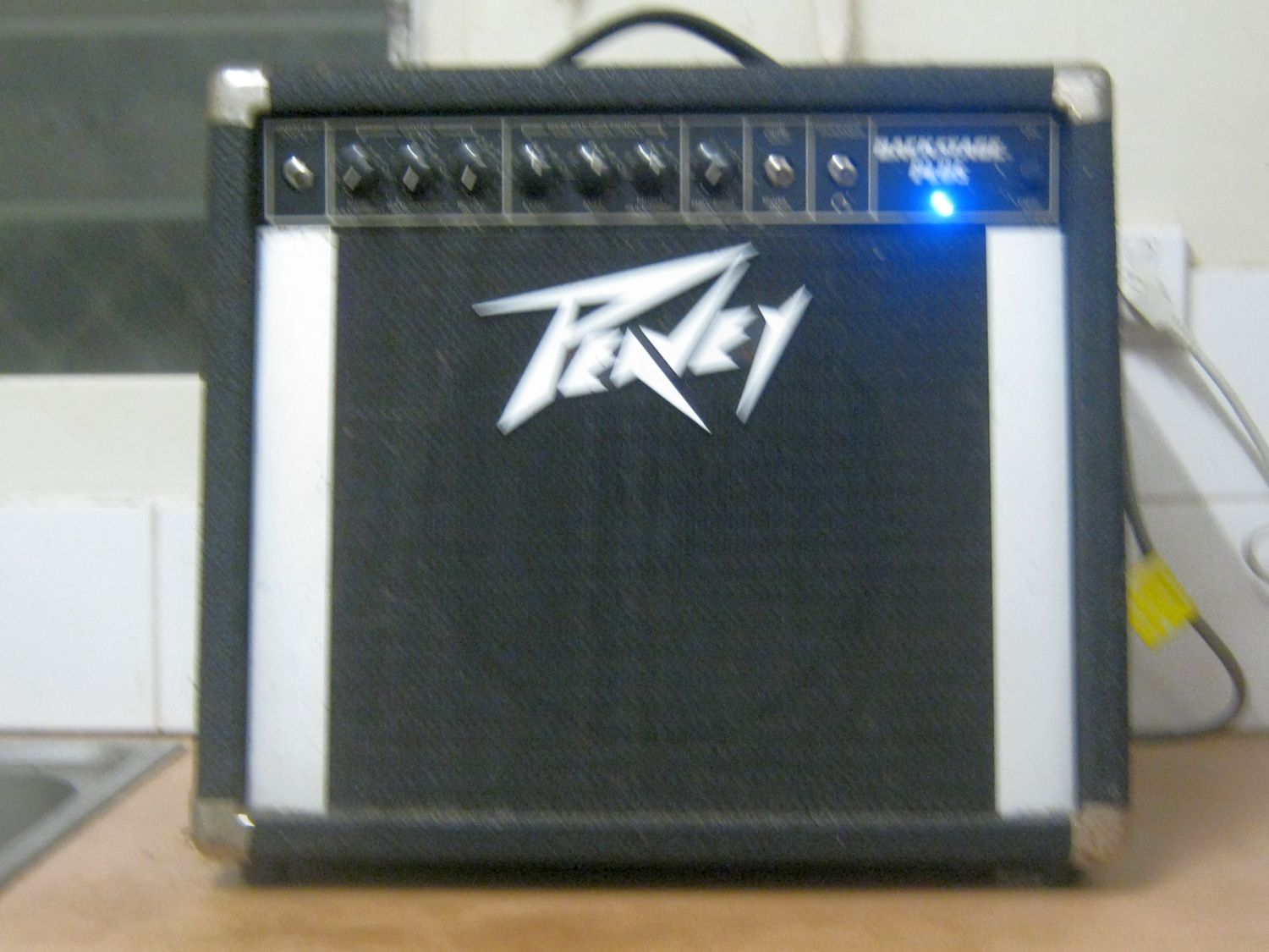

    A quick test-out confirms that the amp is indeed still working.
    And here's a pic of the amp set up on my kitchen bench, powered up(check out the blue power led):
Name:	New Backstage Plus_resized.jpg
    This amp features footswitchable distortion and reverb, as well as a built-in FX loop.

    Today, I got inspired to do some restoration-work on my Peavey Backstage Plus amp after seeing it sitting un-loved in a corner in my little studio room, so this week and next week, I'm going to be working on restoring it to a giggable state, not much needs to be done to it though, and I'm going to be making a new footswitch for it that will include indicator leds, something that the original one I made didn't have, once I have the design worked-out I'll post a hand-drawn schematic here for other Backstage Plus owners, together with a write-up.
    I'm also going to look at what I can do to tame the blue indicator led brightness down a bit, since I really want to keep the blue led for it's coolness, I have a good idea of what needs to be done, I just need to change the value of one resistor and that should fix it.
