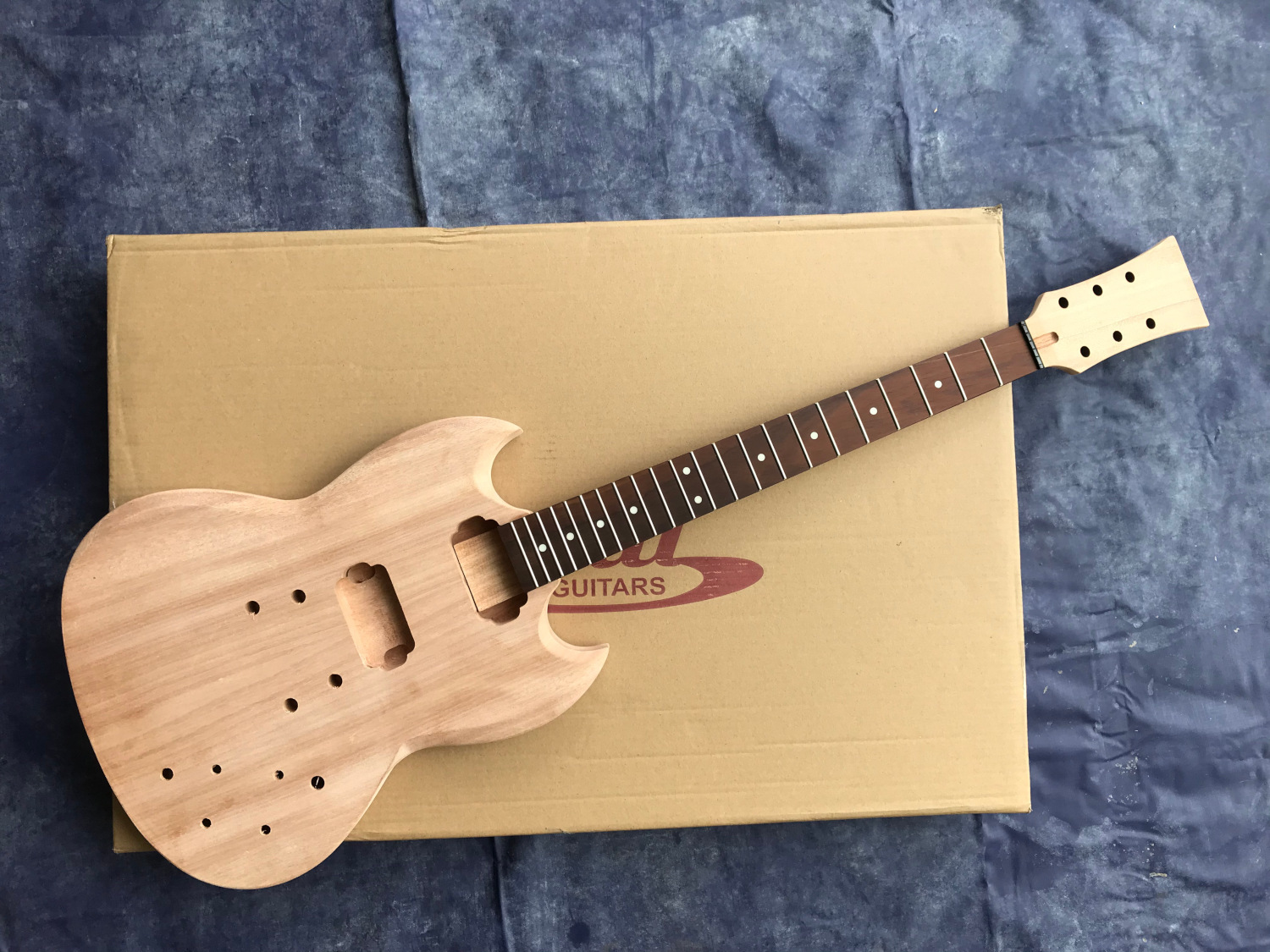

    Hello all,
    Having (nearly) finished my 335, it's time to start my next build, a GSM-1.
    I received the kit this week, and I'm very happy with it. It's a two-piece mahogany body, and the pieces are nicely matched. The neck is a very snug fit. I haven't made any measurements yet, but the neck pocket will require some sanding to allow the fretboard to clear the neck pickup route.

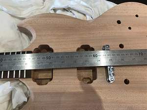

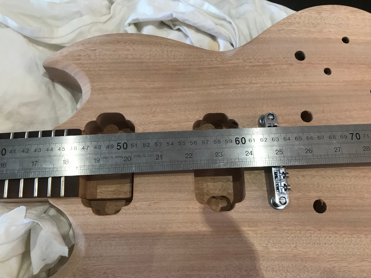

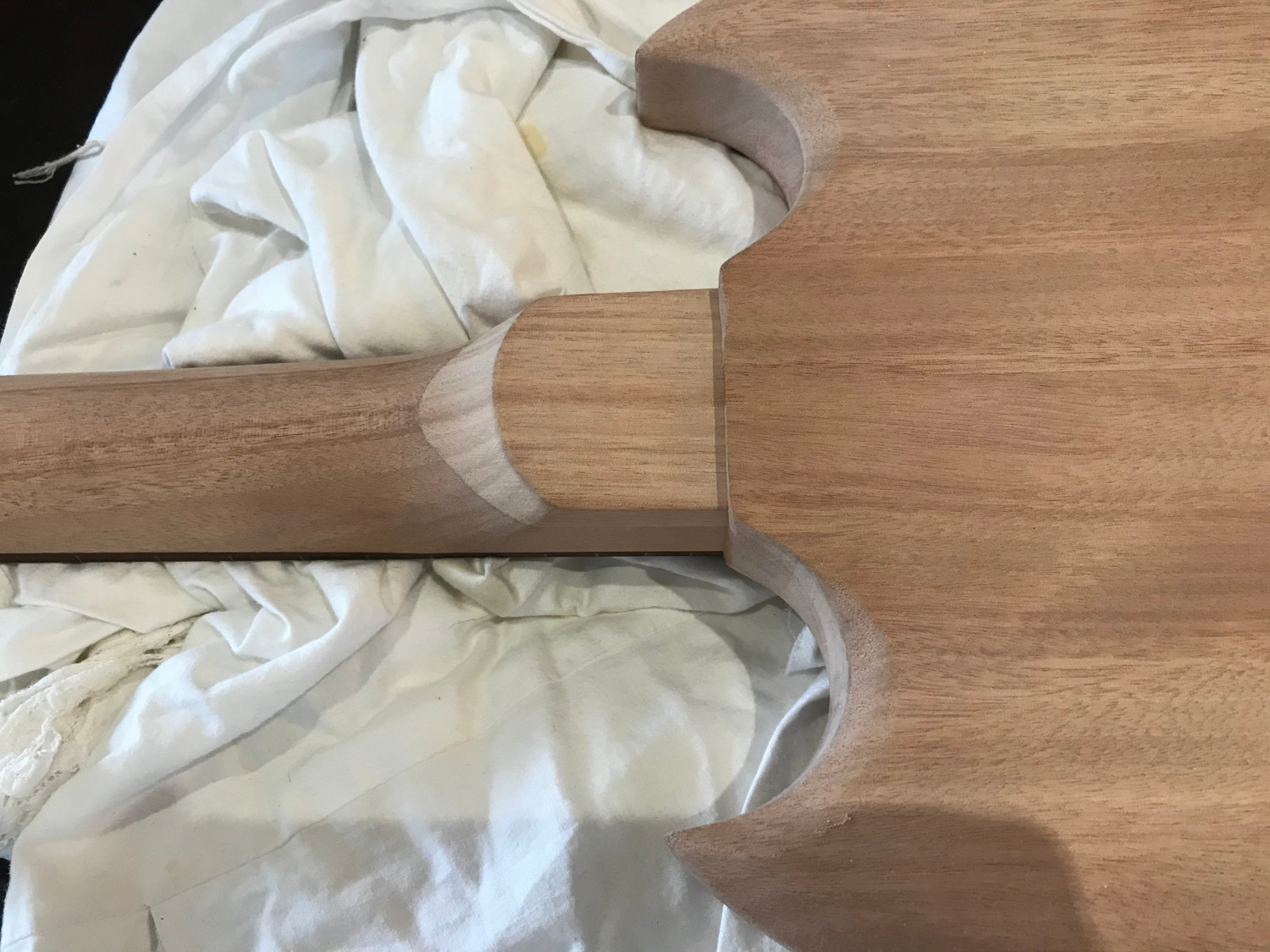

    Now the guitars had a week to acclimatise, I've tested the neck fit with the scale length measured. Looks good to me. It does, however, leave the heal protruding from the body quite a long way. Would it be safe to shave this down? If so, any tips on how to do it other than go at it with a rasp?!

    With mine I had to move the neck out about 6mm to get the intonation right. Would had been a lot further if I had stuck with the original bridge. Bought a Gotoh bridge that has more adjustment. I made up a shim to go between the body and the neck heel so when I went to glue it I knew I had the right measurement for the intonation.
    The bridge and tail piece holes where out about 2.5mm as well. Plus there was no earth wire hole to the bridge. The fretboard needed a few cracks filled plus 2 frets needed gluing down. Other then that it went well.
