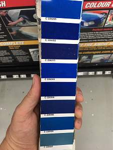

    Welcome Andrew. What Sonic said is sound advice, and FWIW, my local SCA has a swatch booklet (for lack of a better word) that I used to compare colours with. Like SM mentioned, you could use that to do a visual comparison to your PMS book.
    I don't know if all SCA stores have these or not old school books or not.
Name:	blue blue blue.JPG

    Thanks McCreed, problem is that I'm in Melbourne and stores are closed so it's only click and collect ATM
