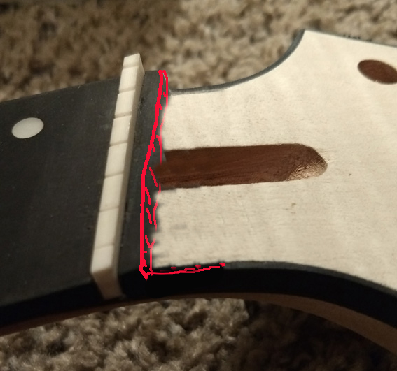

    From a design standpoint the end of the fretboard is kind of disappointing. It would have been nice if the top of the fretboard was angled and the headstock veneer went down to it. But, it's a $220 USD guitar kit, that's probably too much to ask for. I'm likely going to leave it as is, I considered rounding it off or something but chances are anything I attempt to do will look worse than leaving it as-is.

    On that bit of the fretboard past the nut I'd definitely be taking a file to that to angle it down the headstock. So that there was a triangular facet with one side that ran parallel to the nut, one side that went from that parallel point at the lower side right to the headstock, and the third side heading back up to the current end of the fretboard.
    I don't know if that made any sense at all.
    Like this?

    But note that will really require a custom-made truss-rod cover with the fretboard-end angled and sloped to match the slope of the board end. Just leaving a standard truss-rod cover end sticking up vertically against the sloped rosewood will look odd - though the current arrangement looks just as odd.

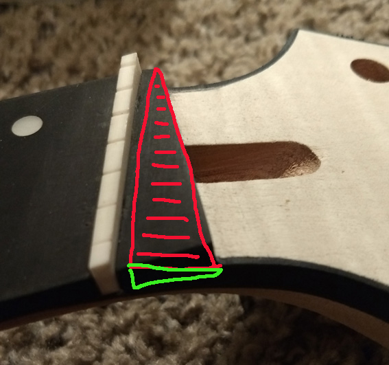

    The black binding to the headstock makes any other alterations to the headstock a bit more awkward. Without it, I'd cut away the excess board parallel to the nut, but not slope it, just cut it level with the headstock, then glue on a piece of suitable veneer to give a unified headstock face.
    More like this:
    But that does leave the black binding sitting below the veneer looking a bit odd in itself, unless you then paint the very edges of the veneer black to match.

    Yes, that was what I meant Simon, but I hadn't thought about the truss rod cover.
    Still, good excuse to make a custom TRC!
    In fact with either your or my suggestion, or even as it is now, a custom TRC might be the way forward and use that to make the link between headstock and neck.

    Any solution for that bit of fretboard seemed like a lot of excess work for little gain, since I'm not confident I'd get a result that looks any better than it does now.

    You could turn that area above the nut marked by Simon into a bit of a signature by dropping the level a bit and maybe insert a piece of timber contrasting between the fretboard colour and the headstock or a piece of pearl.
