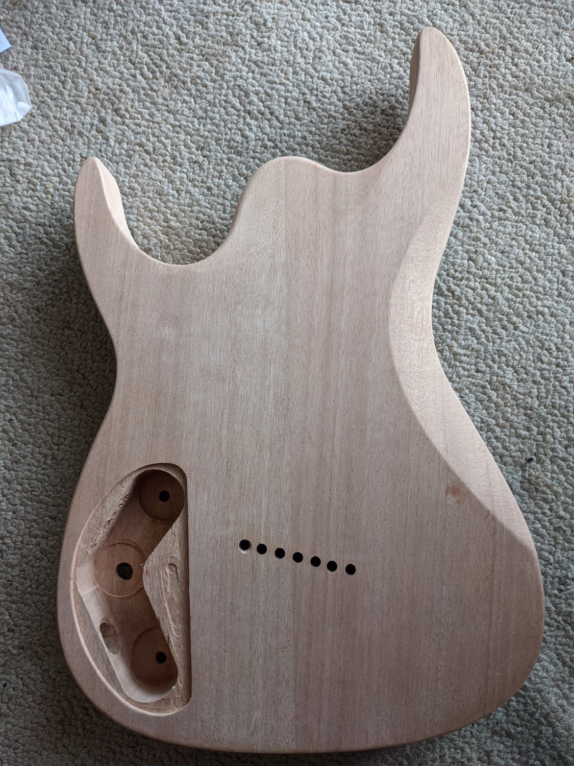

    Honestly though, this time it was pretty fortuitous. I'd been wanting another 7-string for more Metal stuff (since my other 7's dialed in more like a Hybrid for fingerstyle), so I guess it all came together nicely.
Name:	PXL_20201019_030630594 (Custom).jpg
Name:	PXL_20201019_030658065 (Custom).jpg

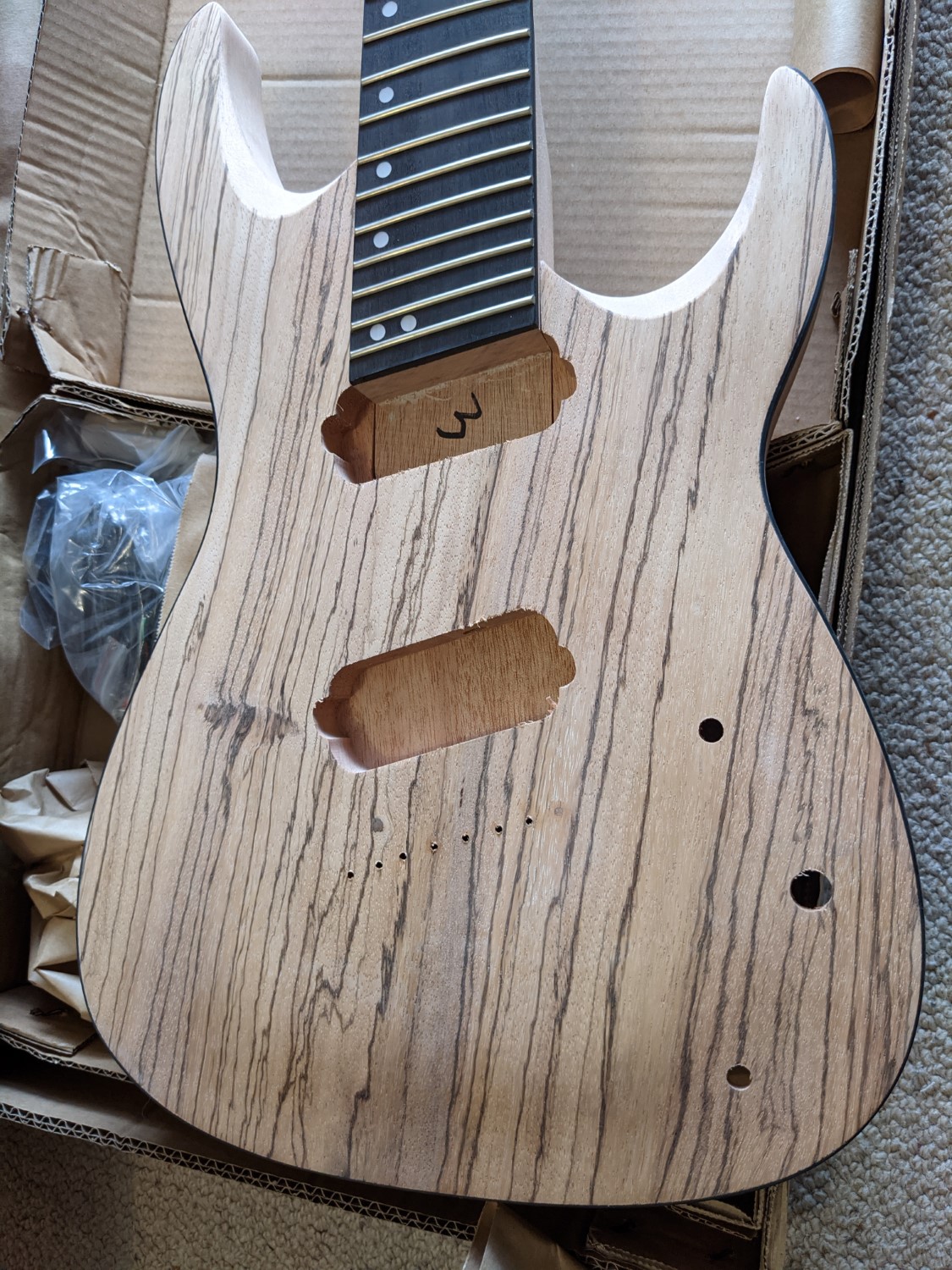

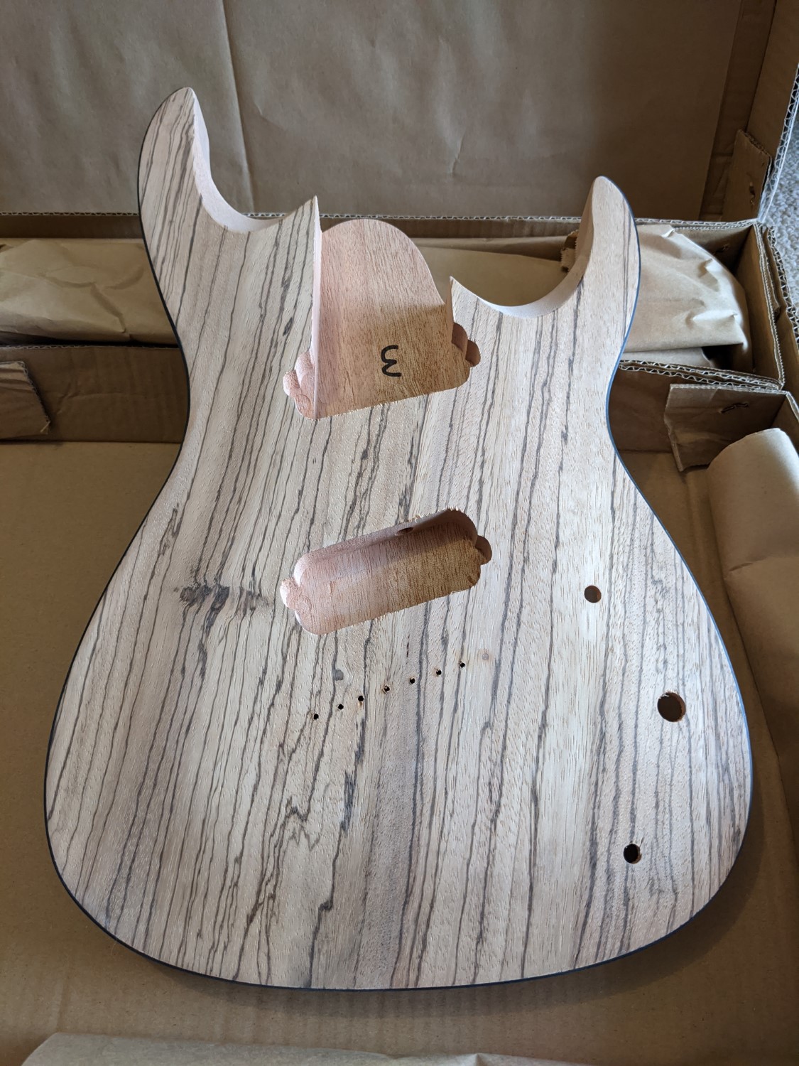

    The grain running on a bit of an angle may mess with what I had drafted for my initial plans, but I'll see how that goes.

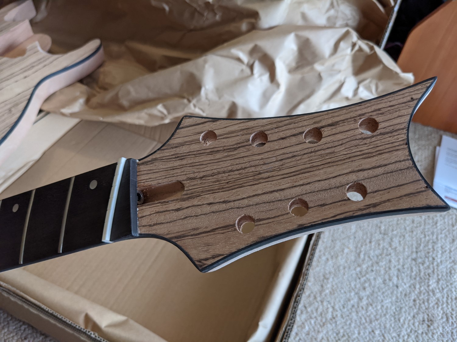

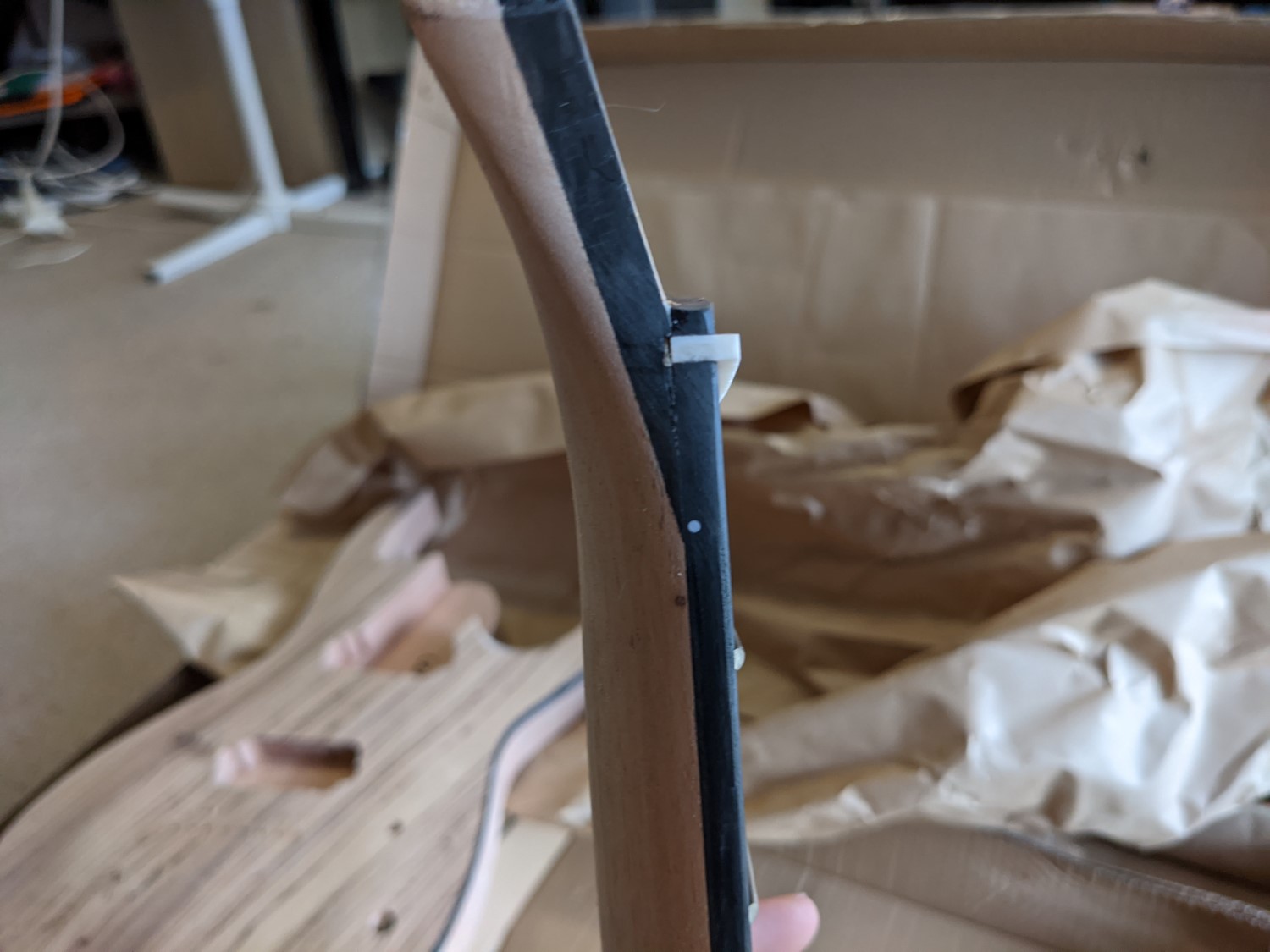

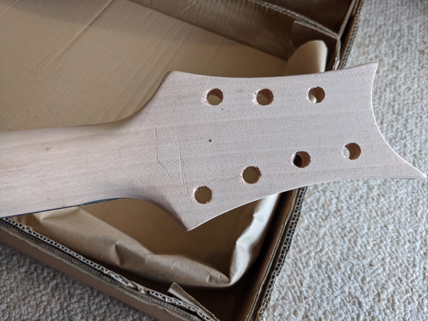

    Main thing I dislike with the kit is the straight fretboard end here, but eh, you work with what you can get. Bottom corner of the nut is also quite pointy. Nothing a file won't fix, but still worth mentioning.

    Ooops, couple dents in the back
Name:	PXL_20201019_030821330 (Custom).jpg

    Just a couple more of the body with the neck attached. I do really enjoy the grain on it.

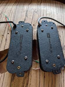

    Pickups are also different from the ones I've had on PBG kits in the past, which again makes sense because fanned. Got a hunch they're A5, as I've seen similar, unbranded ones before, but can't say with certainty. They're also 4-conductor, which I'd be much more hyped for if I was actually planning on any wiring shenanigans this time... Dang.

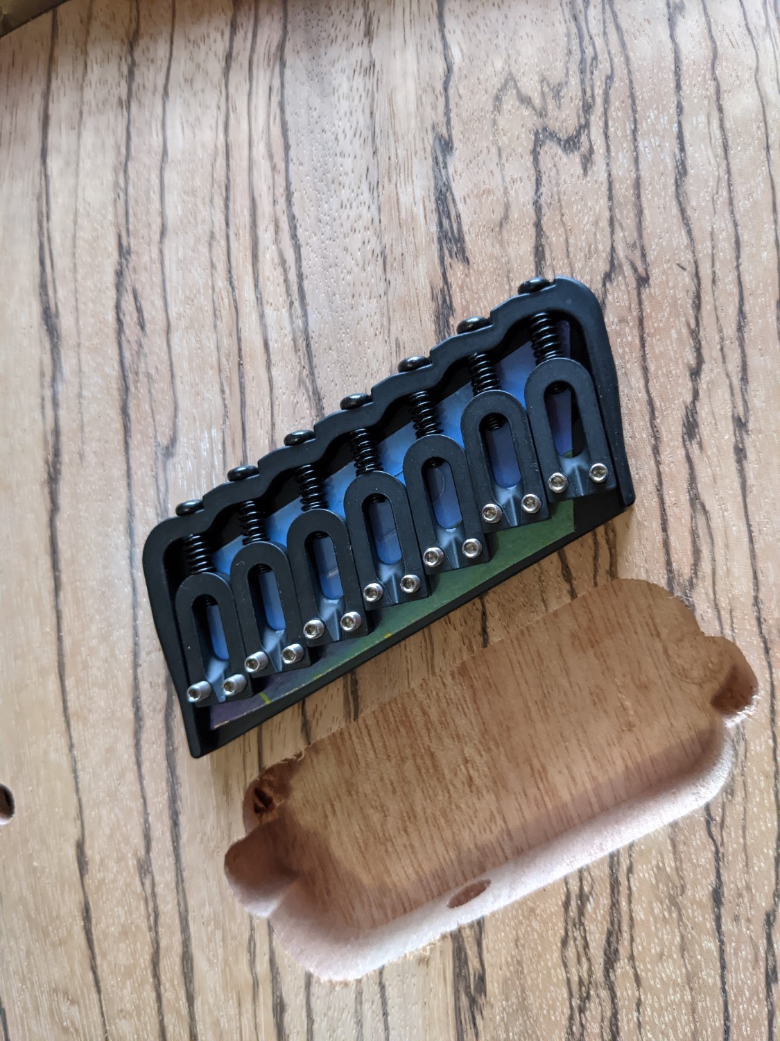

    Hipshot-style fanned bridge too. Probably the better option over the individual saddled ones. Feels solid enough at this point in time

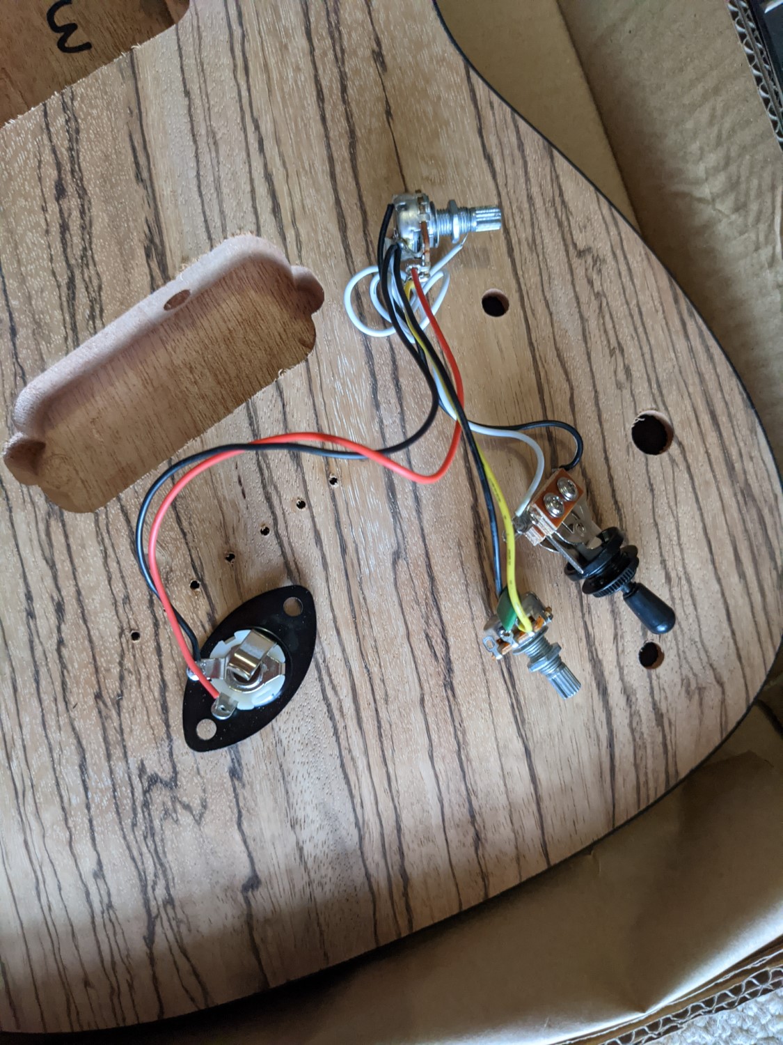

    Prewired switching. Am just gonna use it this time. Pretty neatly soldered.

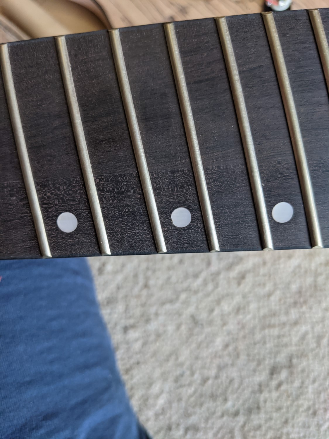

    For some nitpicking: Some of the frets aren't quite the full width of the fretboard further down. Not far enough to make a difference with playability, but it's visible. Fretwork is also pretty solid. They're all pretty smooth, but a couple of fret ends could handle a little bit of a tidying up.

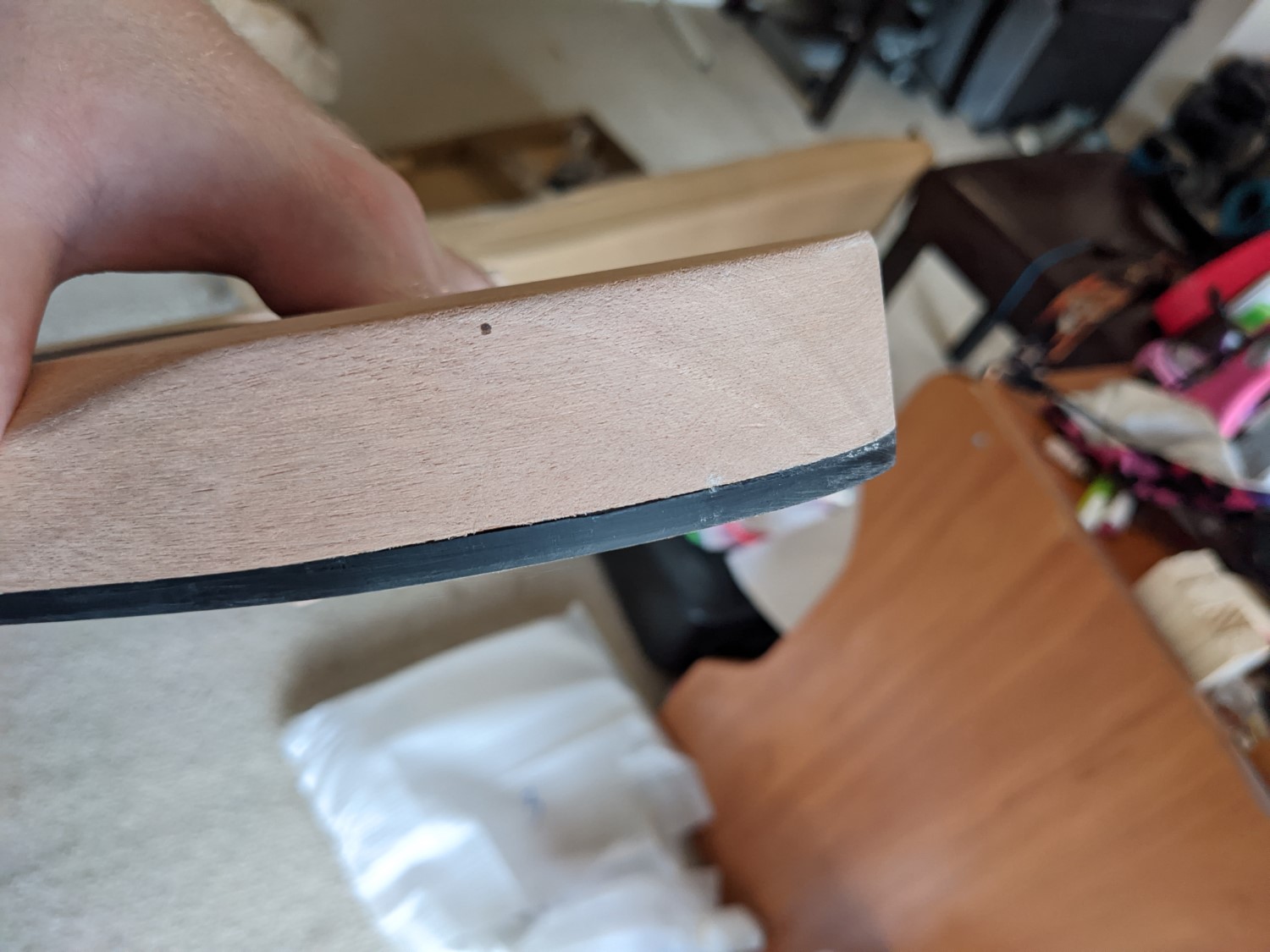

    One point as well where the binding wasn't set down in the rout quite properly. Not a big worry though.

    Uneven fret lengths seem to be a common issue with this kit. On your one, it does seem more like some are very slightly longer than the board width, rather than some are cut slightly too short for the width. Some careful filing of the ends should level things out and get rid of any sharp edges.

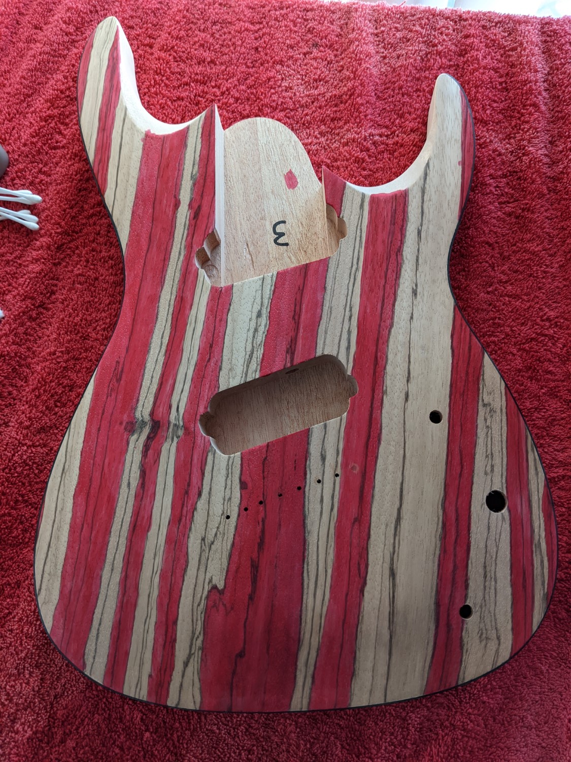

    So my initial plan for staining was to do even stripes, along the grain, but when I opened it up and saw how angled the grain was, I realised that plan wouldn't work. But, I was discussing with my partner and they suggested staining along the rivers of the grain, which I loved the idea of. I'm using Angelus Leather Dye (Rose, specifically) this time around.
