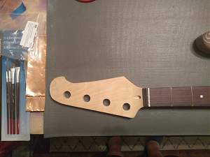

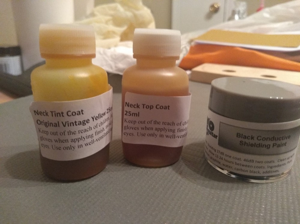

    For the neck and headstock I'm going to use the original vintage yellow and top coat from Wudtone. The idea for the headstock is to use a coping saw to shape it like a reverse Firebird headstock shape. I may not have enough wood to work with though, so I'll update that idea as needed. I added the copper shielding tape too, but I think I'm going to use a shielding paint this time. I may end up swapping the white pick guard for a clear pick guard, the paint would probably end up looking cleaner. Thanks everyone!

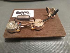

    Thank you both for the information, that was extremely helpful! Simon, thank you for the extra information about the pickups, I may try the white pick guard first without shielding and see how it sounds. I like the idea of a clear pick guard to show off more of the stripes, but I'd prefer it not have shielding on it. I tried to think ahead on how the wiring will look in case I went with the clear pick guard. Wiring is definitely not my specialty, so I got an upgraded wiring kit.

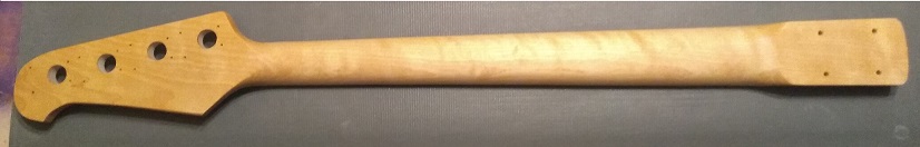

    I worked on the headstock and roughly got the style I'm going for. It will need more sanding and a little more off the top, but not bad for day 1

    Got the first two coats of stain on the neck, I think it's looking pretty good!

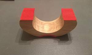

    Just a quick side comment, I have to gush for a minute over a recent purchase. Below is a Rockin' Neck Rest from Crimson Guitars. I know these rests can be found just about anywhere, but this is my first project using a neck rest while working on the neck, and it's so much easier! I love the ability to use either end of it based on how the neck needs to be supported. It doesn't hurt that it looks gorgeous too!
