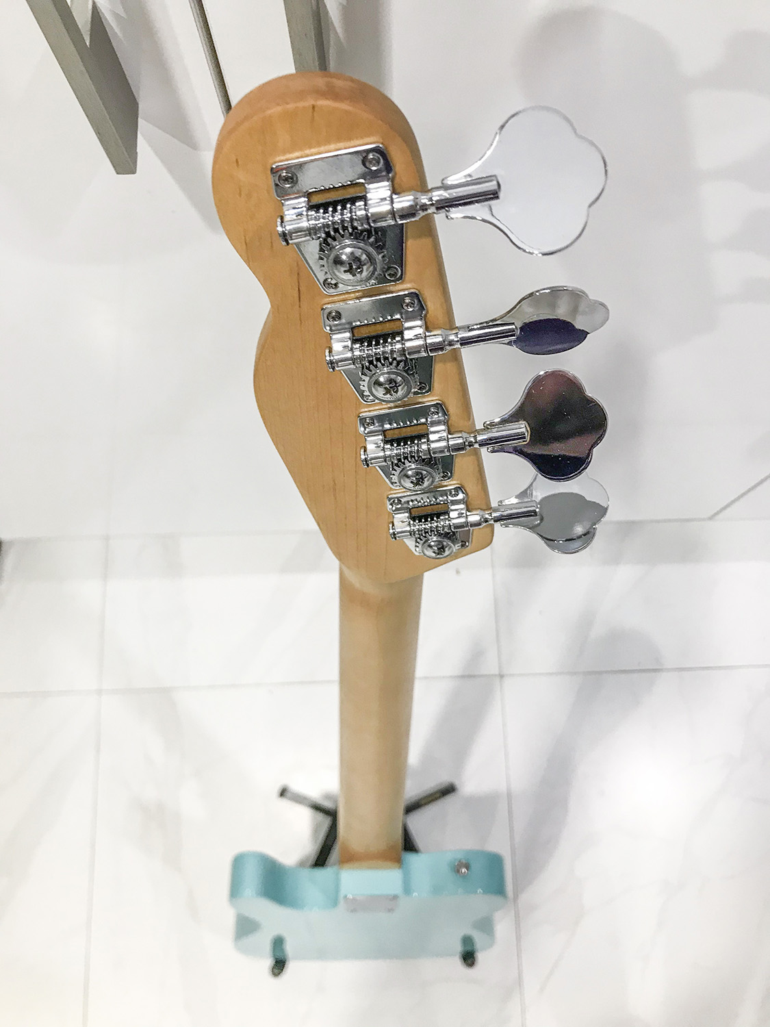

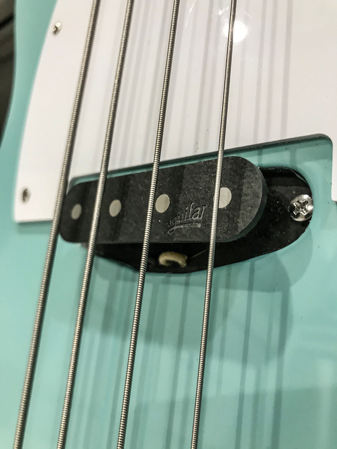

    Here is my entry for GOTM, please go easy it's my first ever build.
    I've just completed the Telecaster bass kit and I'm pretty stoked for how my first build went.
    My brother who is an automotive painter took care of the paintwork starting with a high fill primer, then 2 pack direct gloss in a custom surf green, cut back to flat with 2 pack clear to finish, and it is shiny as hell!
    The neck has been finished with a natural linseed oil and beeswax and is smooth as smooth gets.
    And for some extras thump I ordered an Aguilar AG 4P-51 50's Era P-Bass Pickup which has exceeded my expectations for a clear punchy tone!
    Really enjoyed my first build and keen for more!

    That's a very nice looking bass

    Cool result, don't think I've seen one of these done before.

    Really nice job. I can only hope my first build comes up that pretty.
    3,095
    That is a really fine looking bass

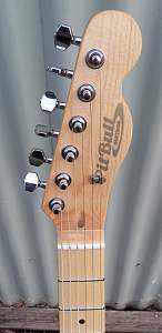

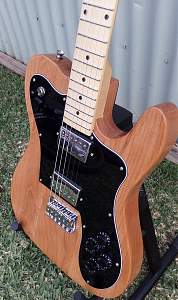

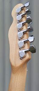

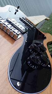

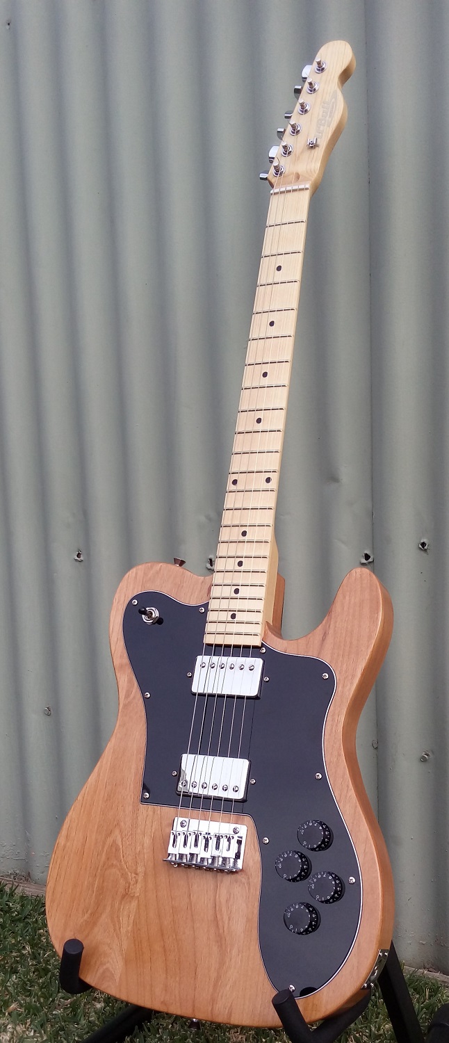

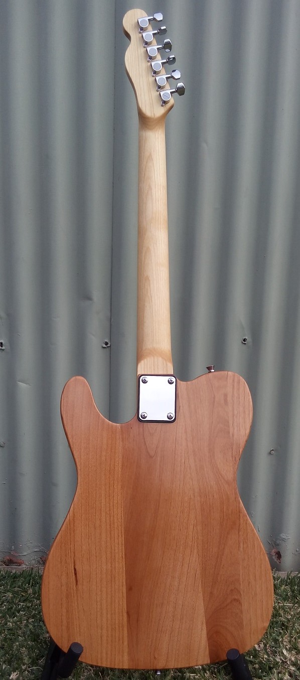

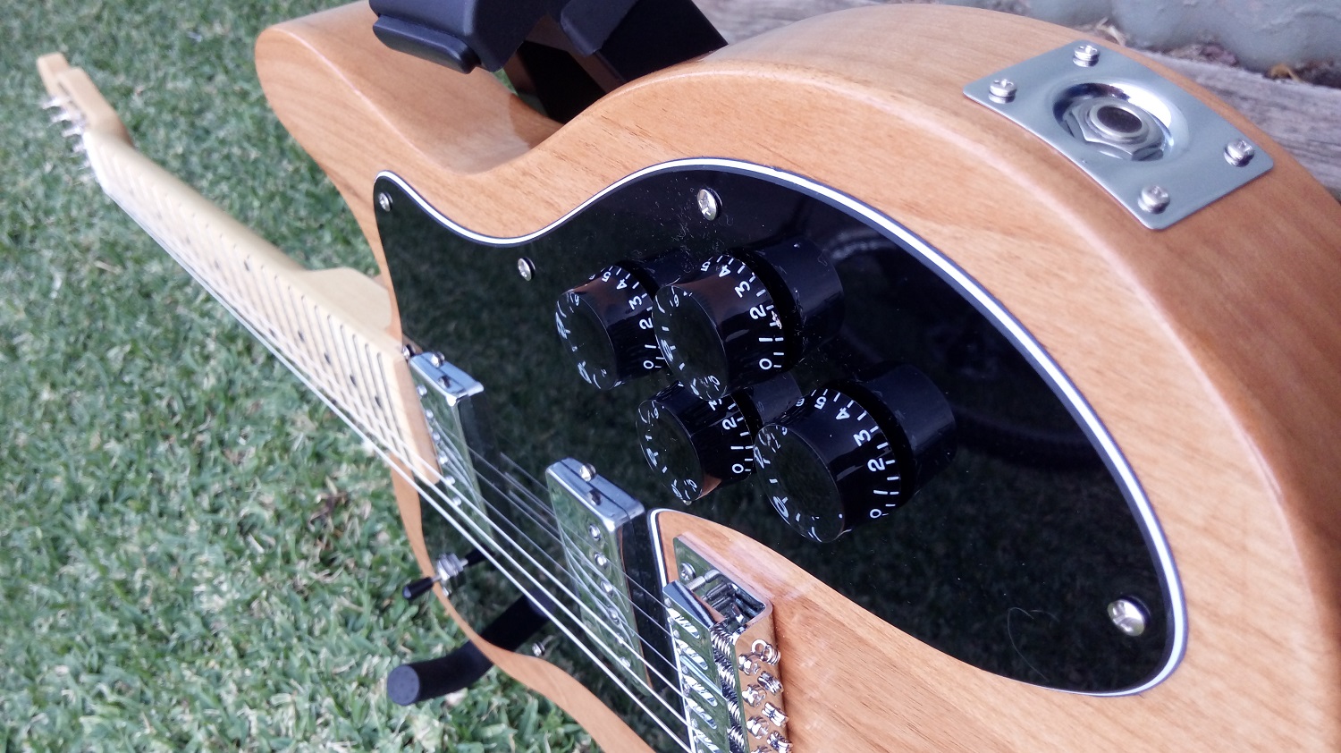

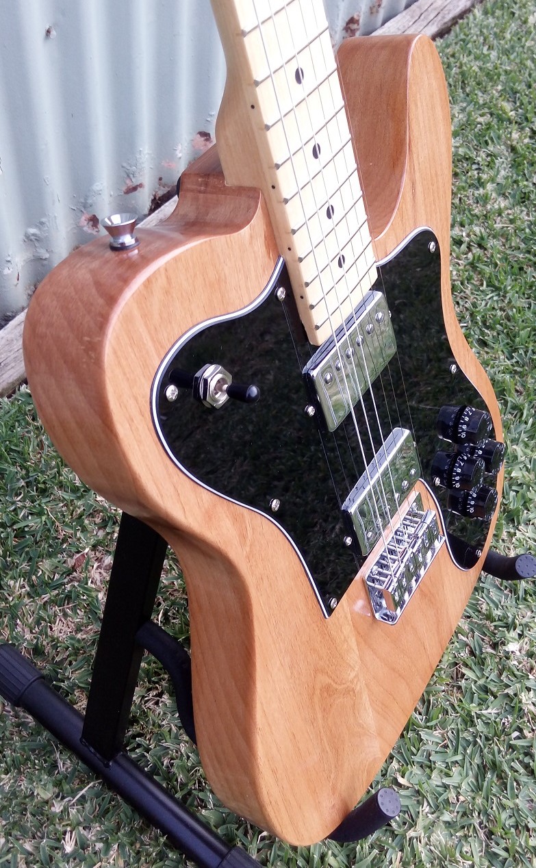

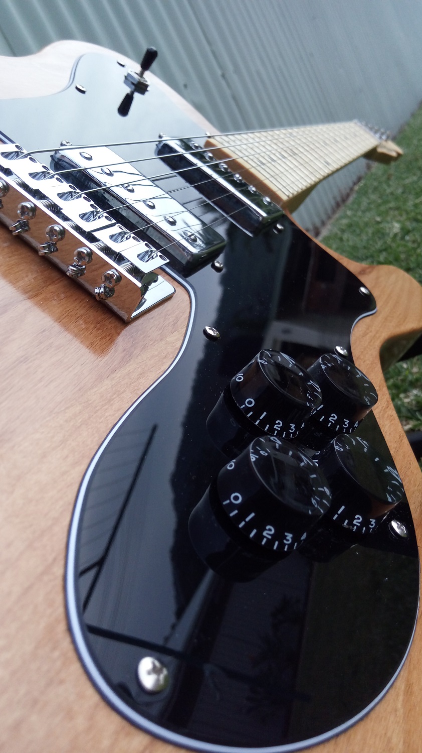

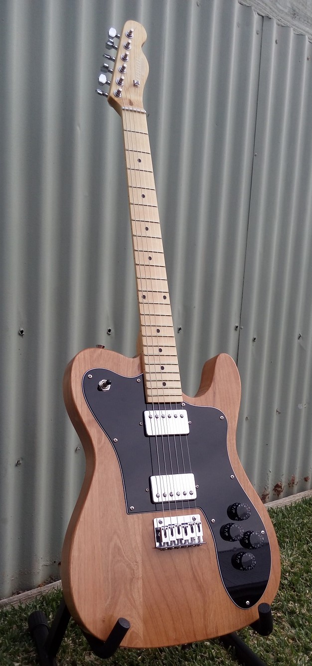

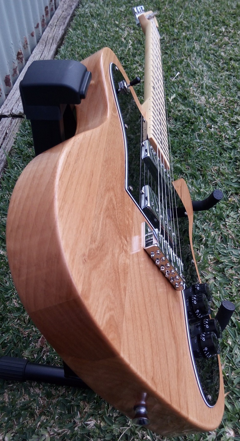

    This TL-1HA is my first ever and the build diary is here TL-1HA first build
    I was after the look of a natural finished F tele along the lines of the '72 Deluxe and American Shawbuckers.
    I went with a home made recipe of wipe-on Boiled Linseed Oil, Gloss Poly and Turps over a tinted grain filler. The colour turned out to be pretty close to what I was hoping for.
    For the neck I just used a few coats of boiled linseed oil, then finally lightly wet sanded with 1200 grit dunked in turps and a few drops of BLO. So nothing fancy but should seal the grain and it feels nice. I can always re-coat as it ages.
    All stock parts. Just left off the pup mounts to give it a cleaner look.
    I don't take very good photos, so making up for it by posting lots of em!

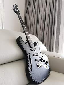

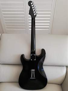

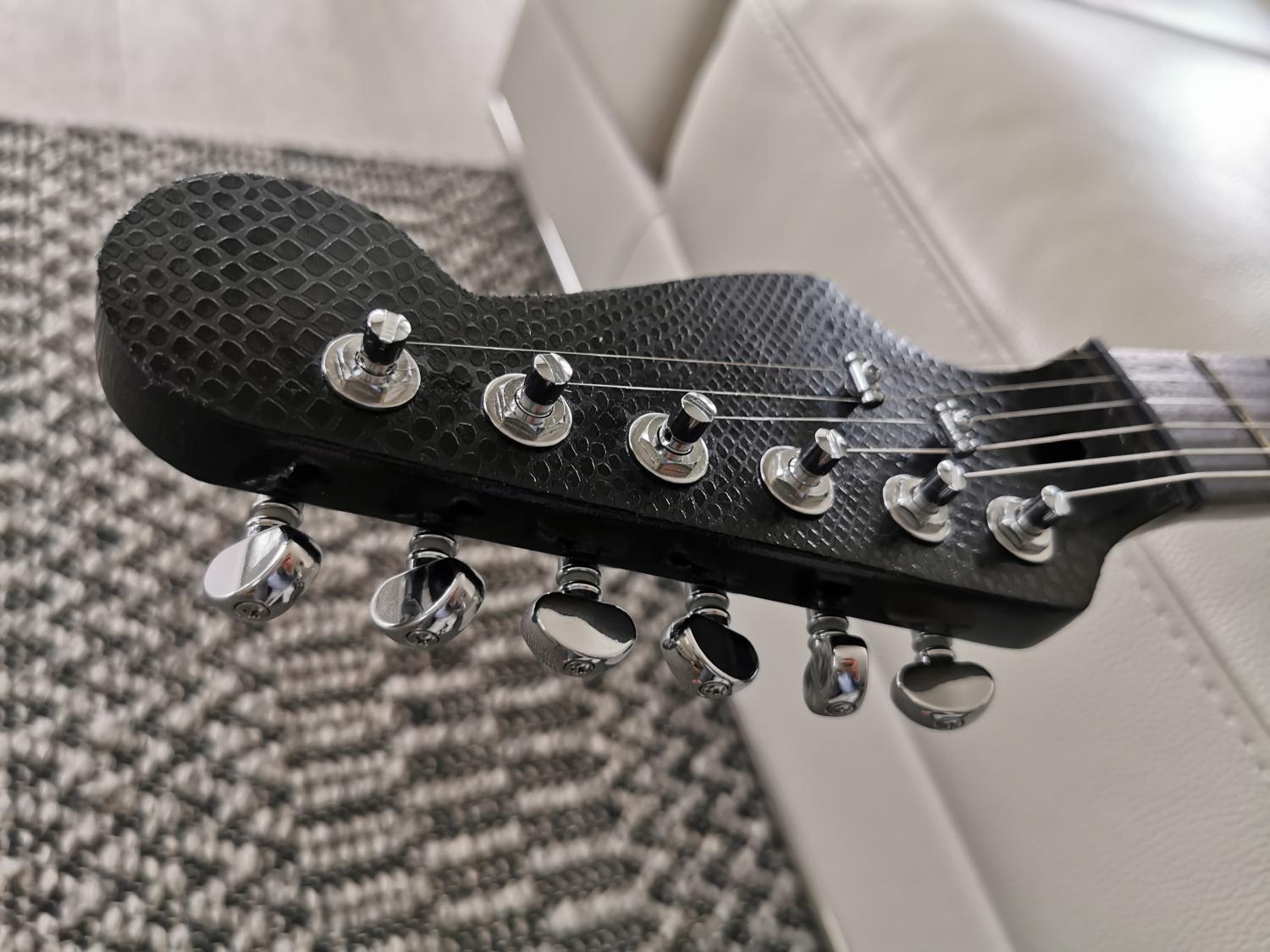

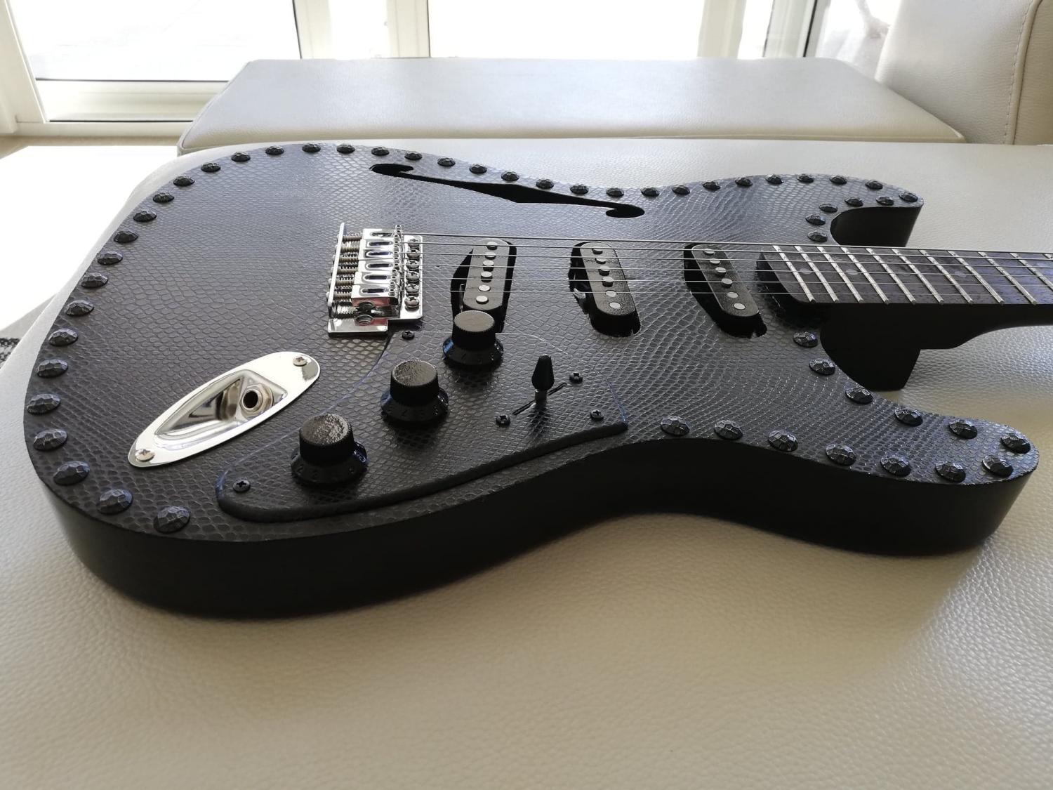

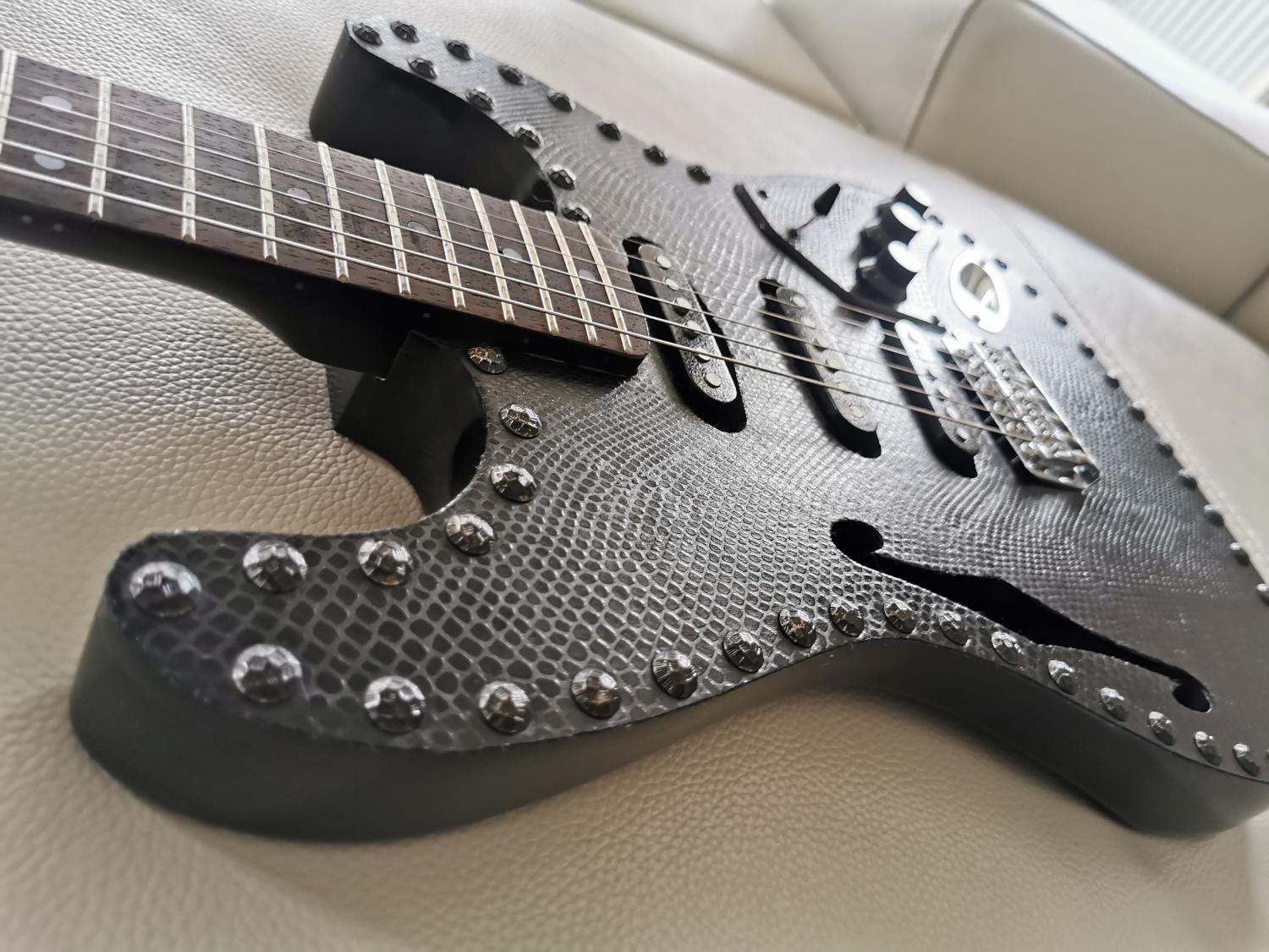

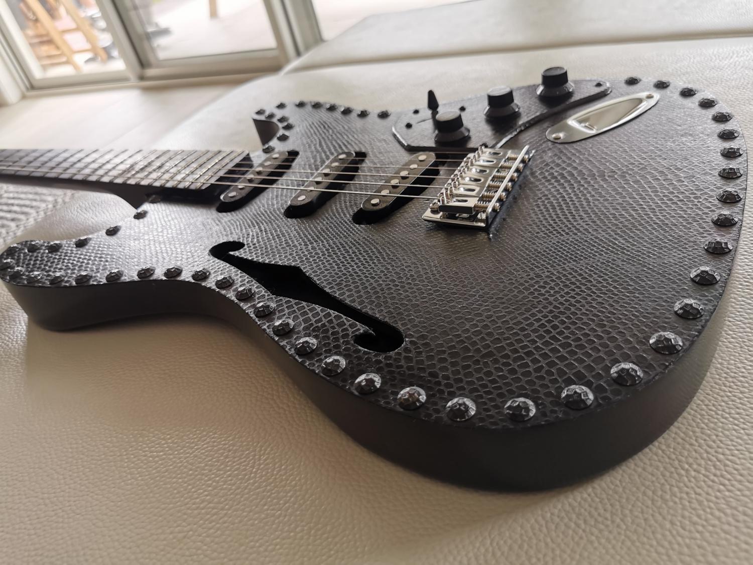

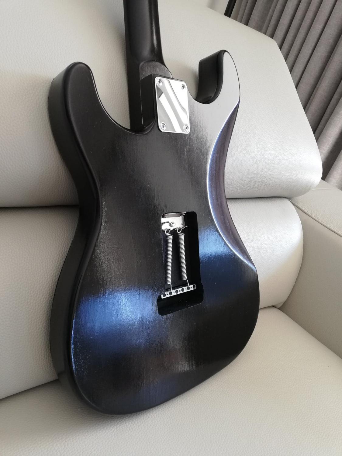

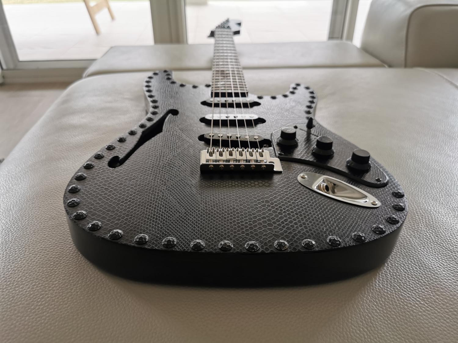

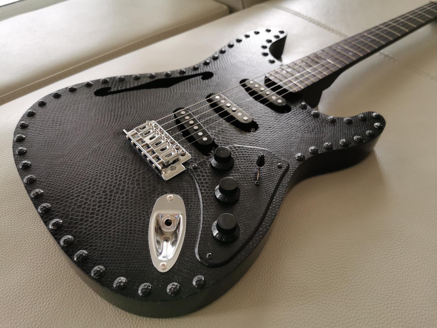

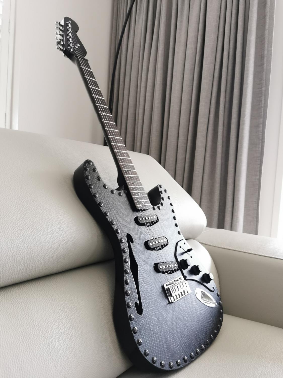

    This is my second build, a thinline strat kit.
    Thanks again to Adam and PBG for their great products and awesome service.
    Body - alder/maple
    Neck - maple/maple
    Finish - snakeskin (embossed leather) & brass rivets (front), black Keda dye & tru-oil (back/neck)
    Hardware - standard kit hardware, Grover mini locking tuners, Corian nut
    Electronics - Alexander Pribora "Custom Hot", Gotoh pots/5-way lever & Sprague orange cap, 1V/1T/1Blender, treble bleed mod
    Kit was a joy to build.
    Kit neck and fretwork is great (with a little elbow grease), action is 0.2mm at 1st fret and 0.5mm at 12th fret, super-smooth super-fast and no dreaded fret buzz.
    Personally, I like to leave the back cavity cover off and let the trem mechanism show - I think it's a nice detail, not unlike the complication of a watch.
    Thanks for looking
