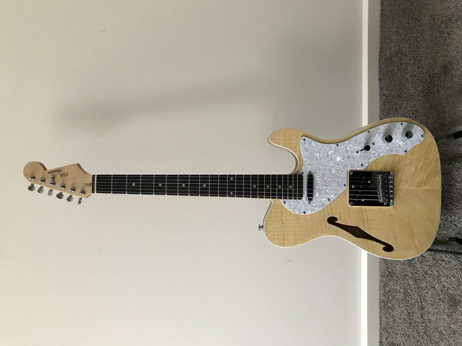

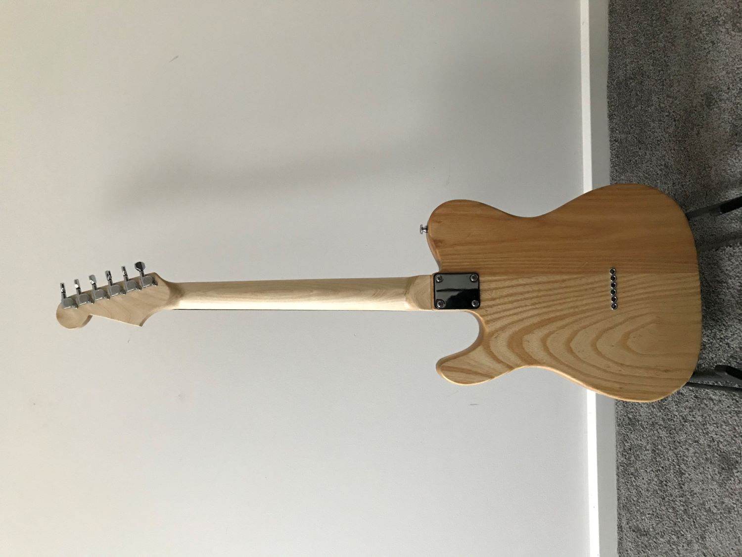

    The above pic shows the guitar put together after I had shaped the headstock and started taping the f'board ready for a fret dress. The frets weren't too bad (only a few high spots) and the actual f'board was quite smooth although I did still sand it. Edges were a bit sharp so filed those down a bit.
    While working on the neck the body was sanded down and first coat of Dingo oil (natural) applied. This process took about 9 days (three coats of each, one per day). The body came up nicely given the two pieces are not perfectly matched but it adds character. The neck was fished with tru oil and decal applied.
    When body was finished and put back together did a setup (after filing the supplied nut) and only had to shim the neck slightly to get a good neck angle. I would point out at this time that the strings supplied with kit are really only any good for setting up. Next changed out the plastic nut for the bone nut ordered with the kit.

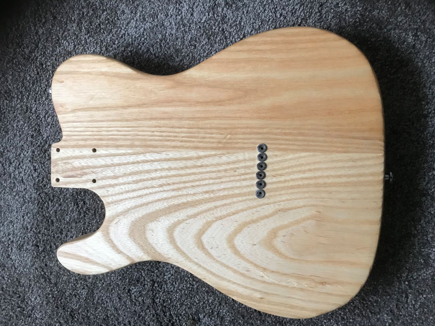

    Had a slight issue with the bridge in that the intonation screw was touching the bottom E string. Looks like I may have put the bridge plate slightly too close although it did intonate ok. Any way it seemed like this was causing the saddle to lift slightly so I decided to do a string through.
    Pulled everything apart again (got it down pat now) and took it it up to a cabinet maker I know and used his drill press to drill for ferrules which I'd ordered from Ace guitars parts. This came out ok but extremely nerve wracking.
    Also wasn't happy with the thickness of the neck so shaved it down to 20mm at the first fret and 21.5mm at the twelfth. Re-applied tru oil which blended nicely.
    Re-assembled and finished product as per photo. All in all a fun project which ended up in a playable guitar. I will play it for a while and decide whether to upgrade the pickups. Also nice and quite so didn't bother with the shielding I'd ordered. Might put it in my real tele which is noisy (go figure).
