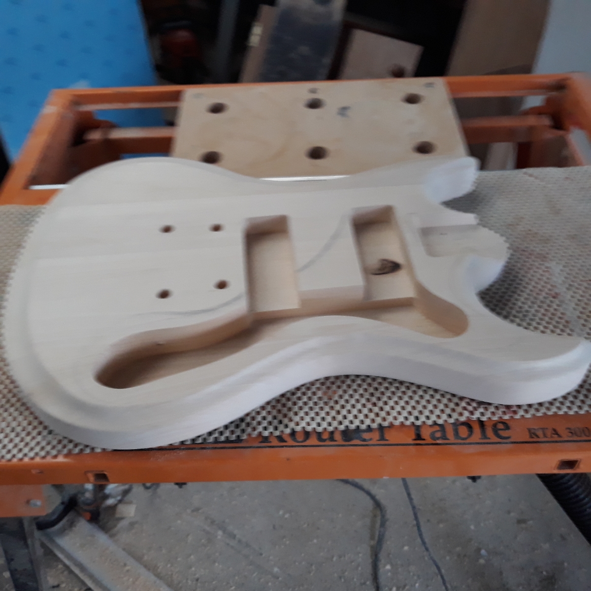

    Thanks Mark, it should be alot of fun. Just finished the German Carve today.
