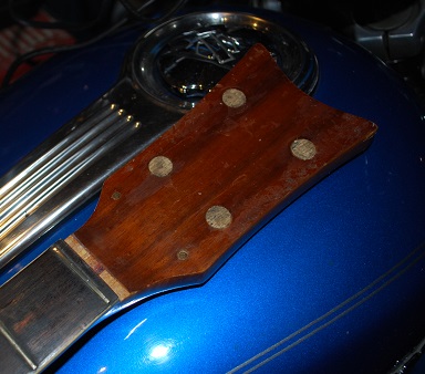

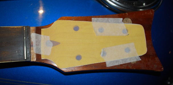

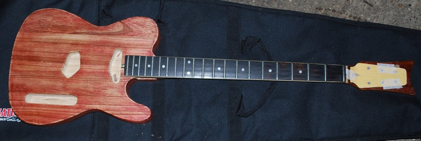

    While I am settling the current builds and with work rearing its ugly head, I thought I would post the next one in planning as I collect parts etc. A donated Tele body (that I will probably have to fill then rout) a salvaged Kay 30" scale 20 fret bass neck, 42mm at the nut and 56 mm at the heel and various bits of hard ware is where I am at this time. I have plugged the 12 mm tuner holes and laid a rough template of my headstock on it. The neck originally has a zero fret which has been worked for action. It is my plan to dispense with the zero fret and fit a Gibson style brass nut in its place, using the zero fret wire locator as my zero point. The truss rod adjuster is at the body end, but no big deal there. I plan on using a Strat type fixed bridge as the smaller size will make the proportions look better where it will sit closer to the edge of the body due to the scale. Through the body stringing with my usual brass ferrule block. I am undecided on pick up/s at this time, we will see what turns up. I have no idea how tenors should be set up but initially plan to use 10-42's and tune to B, I guess about halfway to bass? Its another learning experience

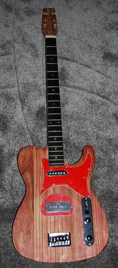

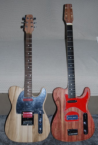

    I made a little progress on the baritone, I reshaped the headstock, removed the zero fret (currently have a plastic Gibson type nut held with ds tape so as to check centreline etc) Sorting through the bits and pieces box, I found an old single coil neck pickup and a P90 clone, a Strat hi-density fixed bridge, an unused Strat scratchplate (which was split at the middle pickup) and a standard three way control plate. Routed out for the P90 with my trusty Dremel and modified the broken scratchplate into a two piece affair, a little work still needed to make the curves a touch more fluid (if I'm not careful I will find myself in the ugly guitar thread! Maybe my next builds will put me firmly there!)
    I was expecting this 30" scale guitar to look and feel unwieldy, but prior to test stringing it actually feels OK. The second picture shows it next to the 24,75" currently resting and settling, not as drastic as I had anticipated. The 12th fret is actually in the same place (Doh! of course it is! if it wasn't I would be in a whole world of do do! ) When strung and playing, well that's yet to be discovered. As always I live in hope!
    Still to fit the string through back plate, brass nut, tuners and veneer (or something else for the headstock) Not decided on the finish yet but considering a black stain and oil

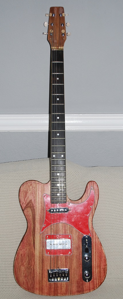

    Anyway, a pic of the Baritele, my daughter does love naming things (sounds like a Brazilian F1 driver) as is at the moment strung and resting prior to finishing. I changed the weird P90 surround for one slightly less weird. An interesting point, going back to Simons comment about the place that I would strum, I actually feel most comfortable directly over the neck pickup, so the scratch plate, as is, serves its purpose. Plus when trying to make an alternative one my Dremel spiral saw decided to leap through it like a tsunami and totally destroyed my only blank. I may have another go, I wonder what tools you guys use to accurately cut pick guards?
    This guitar is a bit of a revelation now I've got used to it a bit, my lead playing seems more accurate, perhaps because I have more space? I am of the Tony Mcphee school of lead, hit a wrong note, hit it again and again it sounds like the right note. Open chords are dreamily deep and mournful. I think it will repay practice
