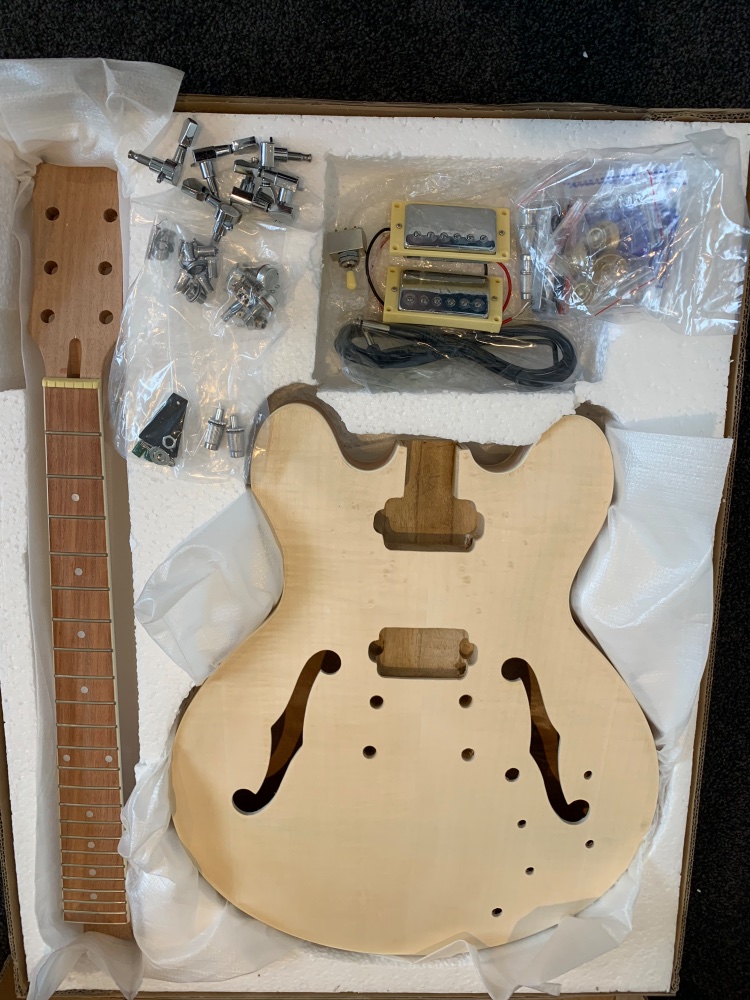

    So after finishing the TLA-1 build I really wanted to try a semi-hollow ES build to practice for making a ES-1TL kit that is on order. Thought I would try a kit from Stewmac just to see if there were any differences.
    So kit was ordered from Stewmac that was on sale and it arrived in 4 days (Friday night order, Tuesday afternoon delivery) from the US, during COVID lockdown! That part was impressive. It came well packaged in a foam inlay and no damage from the shipping.

    Picture of kit unboxing.

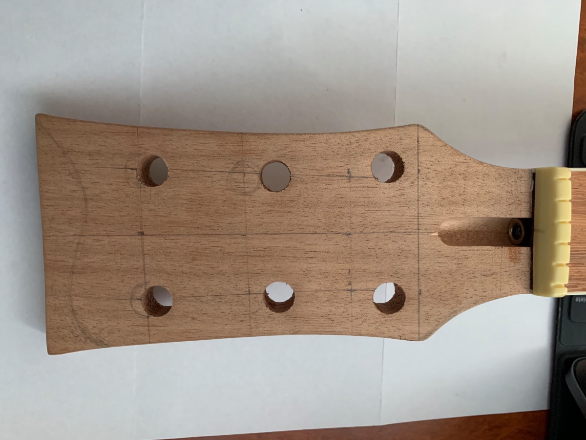

    Most of the kit looks really good with no bad router marks. There are some glue marks that I will have to deal with (Goof off is the way to go from reading other threads).
    One issue is with the head stock. Visually it looked a little wonky, so I dug out the dimensions of Gibson headstocks and tuner hole locations and lightly penciled them on the face. It was a long way out!
Name:	ES-335 kit headstock.jpeg
    None of the holes are in the right place <sigh>. None of the holes are in the right line. Left side is wider than the right side. I am thinking is was a headstock drilled and shaped after a long Friday lunch.
    Looks like I will have to plug a redrill the holes. The head stock is a little short as well to cut it to a G-Style template, no problem here really as I can adapt it. The plugging is not something I really wanted to do as it is hard to match grain and colour and as the holes are so far out the tuner hardware will not cover the plugs and redrill.
    So, Thinking I will put a black veneer on the headstock like a normal Gibson, just to try this as I haven't done it before. That will fix the front. The back which was going to be natural will also need to be veneered. I can't seem to find any mahogany veneer here in Qld or online, just maple or other timbers. I did find a reference that said Gibson used Holly in the 50s as the veneer and then moved to a composite fiber material in the 60s. Can't find Holly veneer here either. So maple it will be, stained black, possibly for both sides.
    Any ideas out there on how to hide misdrilled tuner hole plugs?

    They'll normally get hidden on the back by the body of the tuner itself.
    I've just ordered some fibreboard headstock facings from Rothco and Frost for my two SG kits. I haven't bothered about the slightly-out headstock tuner holes, as the control pot positions are too far out, plus the neck heel arrangements are all wrong, for the kits to be anything near an accurate replica.
    That kit looks very similar indeed to a mahogany bodied ES-1 kit. But then I suppose even if the bodies were slightly different, this sort of kit tends to get supplied with the same generic hardware and fittings pack, and the same generic shipping box.
