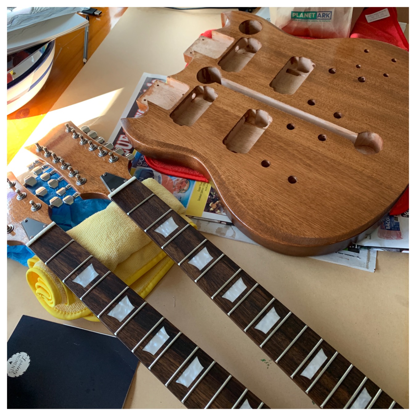

    Twin neck is coming along. Stained and Danish Oil done. Necks the same.

    Looking good. It might be the insomnia, but I had forgotten that one neck was a 12 string I don't know what I was expecting instead.

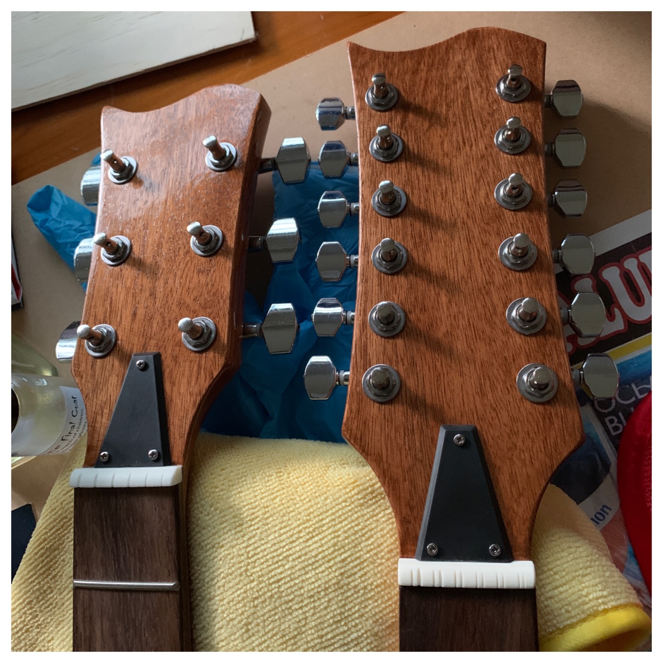

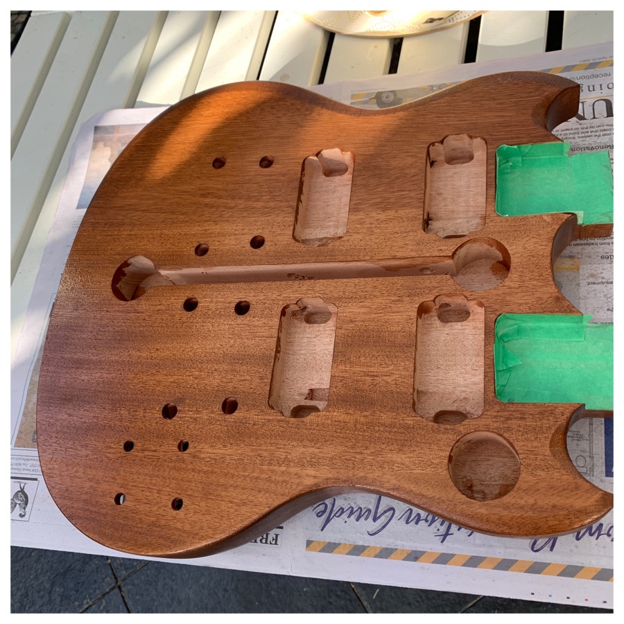

    Rockin' along with the AGD-612 build folk. The necks are just about finished, I cut a wave for the headstock end. Stained "walnut" and Danish oil for gloss. Conditioned fretboard and glued in the bone nut. put on truss rod cover and installed machine heads.
    Building up the layers of Danish Oil on the body.
    Looking glossy..

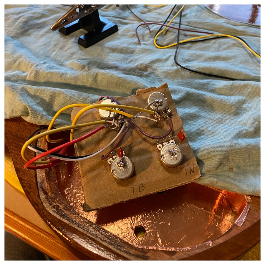

    Okay, got the pickups and switches all soldered in and working. Yes I now realise this was very ambitious for a first/second build, but wow, what a feeling when you plug in to test the pickups and they all work as they should. Necks go in tomorrow as it's now late. Here's some pics of it so far.

    Thanks Simon, I left the wiring as one volume for each neck. no separate volume for bridge/neck pickups.
