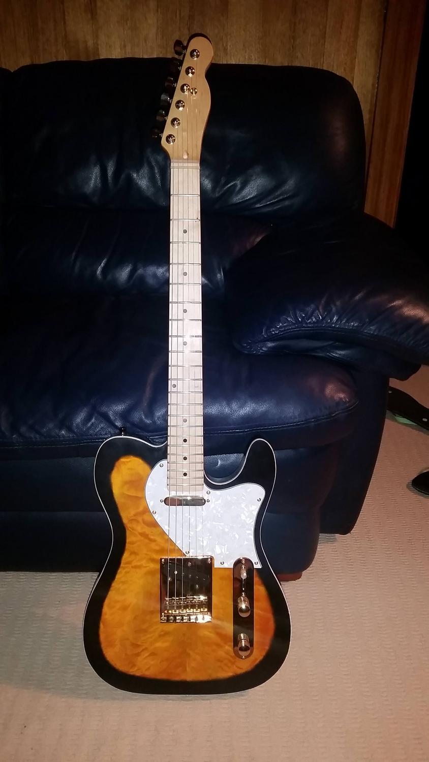

    I used Coolangatta Gold and black acrylic on my Tuff Dog, I tried the Black Stump but it wasn't working for me.
    I used a damp cloth to find the glue spots and then Goofoff to remove them, sand the veneer as little as is possible
    The burst line is a bit too sharp but I'm happy with it.
    The guitar is now christened Moet after my daughters Maltese that was mauled by dare I say it a Pitbull so badly that her organs were visible through the wounds, the story has a happy ending as she survived and is as fit and healthy as ever

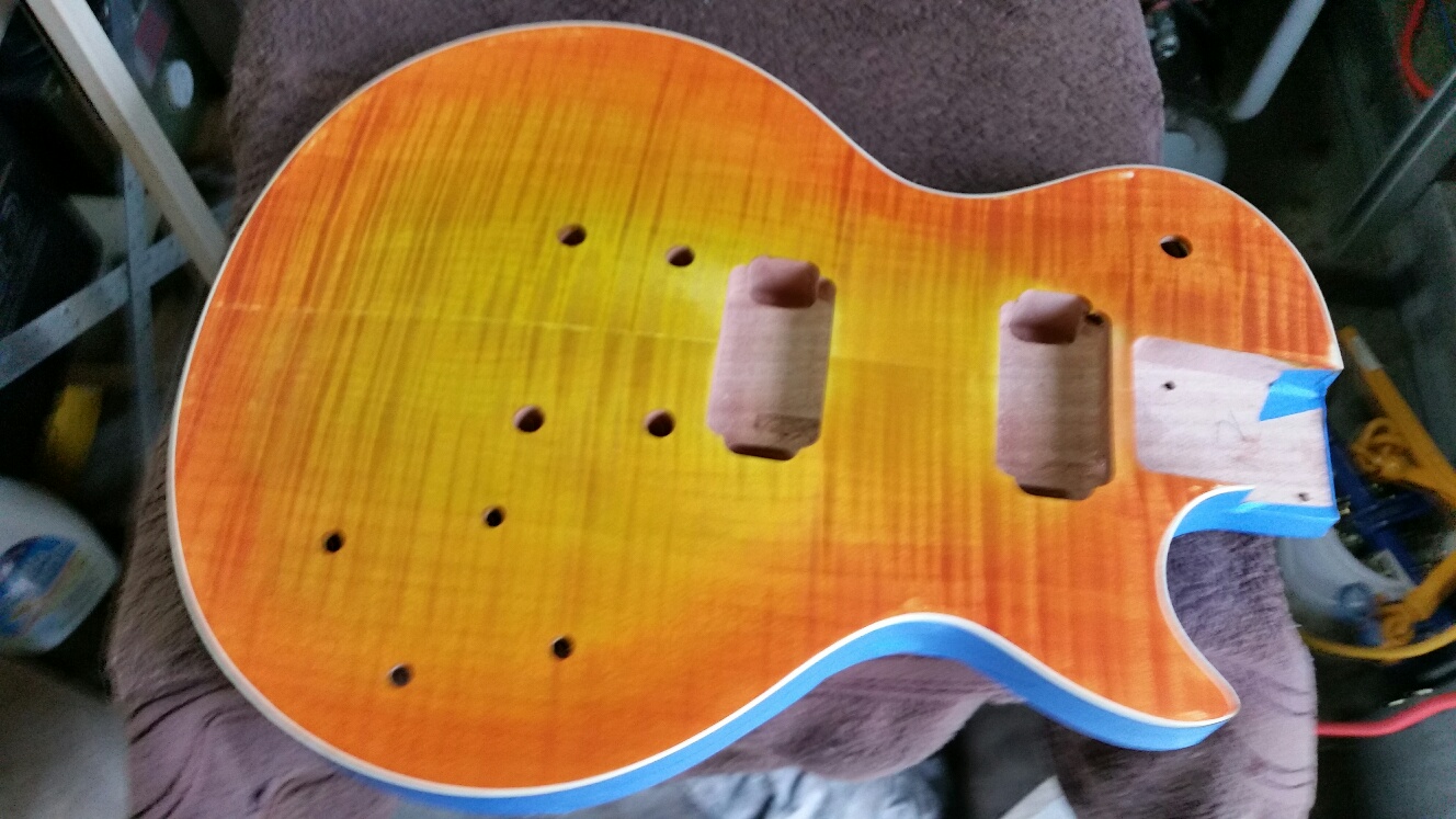

    For interests sake this is a Yellow to Red Keda powder dye burst using the 25% alcohol and water mixes onto a flame Maple veneer complete with unfixed glue spots. No clear coat applied.
    Yep, not much Red, just plenty of Orange that would not turn Red ....
    The very best way to do a burst is spray it. Whilst not impossible, it is very hard indeed to do a graduated burst just by staining.
    When spraying, you don't cover up the middle of the guitar otherwise you'll end up with hard edges in the finish. You simply hold the spray gun or can over the centre of the guitar and spray out towards the edge. Exactly where will depend on the width of the spray cone, so try out on some cardboard templates first. Start by aiming just beyond the edge of the body. The graduation is simply done by the edge of the spray cone, which has far less paint than the centre.
    You'll find that dark finishes get darker as they dry, so don't be tempted to go in too heavily to begin with. Much better to do two two three lighter coats than one really heavy coat (which is more liable to run).
    It's good to be able to rotate the body whist spraying. I spray with the body flat and use a turntable (made from a Lazy Susan) but I've also used a piece of cardboard underneath the body (generally necessary anyway when spraying flat to raise the edges off the surface). This allows the body to be easily spun around, which means that you can stay in the same place.
    If you want to fully copy a Tuff Dog, note that the burst isn't a teardrop shape (like on most Gibsons) but follows the outline of the body by 30mm or so.
