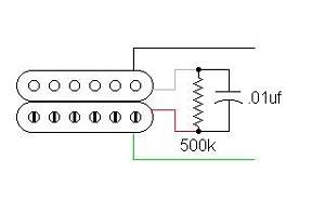

    As for the too "bassy" tone of the neck HB (one man's bassy is another man's muddy ) there is a solution.
    The way I've dealt with muddy neck HB's is adding a simple high-pass filter circuit. It's just a series/parallel capacitor & resistor, like this:
Name:	Arties_Too de-mud 4con.jpg

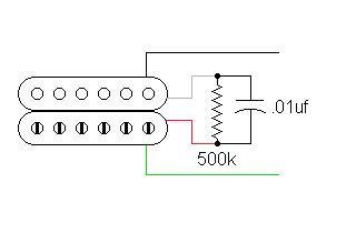

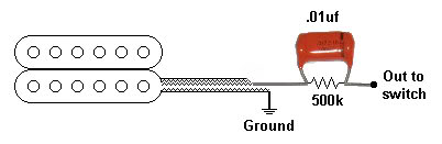

    You can also do it like this before or at the switch (treat HB as though it is 2 conductor):
    You can play with the cap value to effect how much low end is cut, but the .01uf typically works fine.
