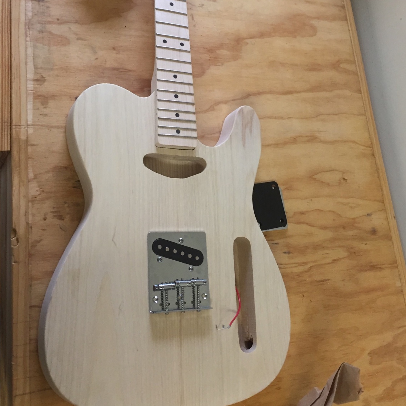

    My GTL-1 kit showed up today, just over a week after I ordered it. I’m pretty impressed with that.
    I’ve done the mock build, all seems good, the neck is slightly loose in the cavity but nothing a shim won’t fix and the pick guard is too tight but should also be an easy fix.
    I’m pretty excited to get into it and look forward to tapping into the collective knowledge of the community.
    I’ll try to attach a photo

    Ohh thats yummy town
    Nice 👍🏾 that’s going to be a ripper, what are your finish plans?
    Was tossing up between feast Watson prooftint maple or teak but now I’m pretty set on shou sugi ban, a hard scrub back, oil then wax.

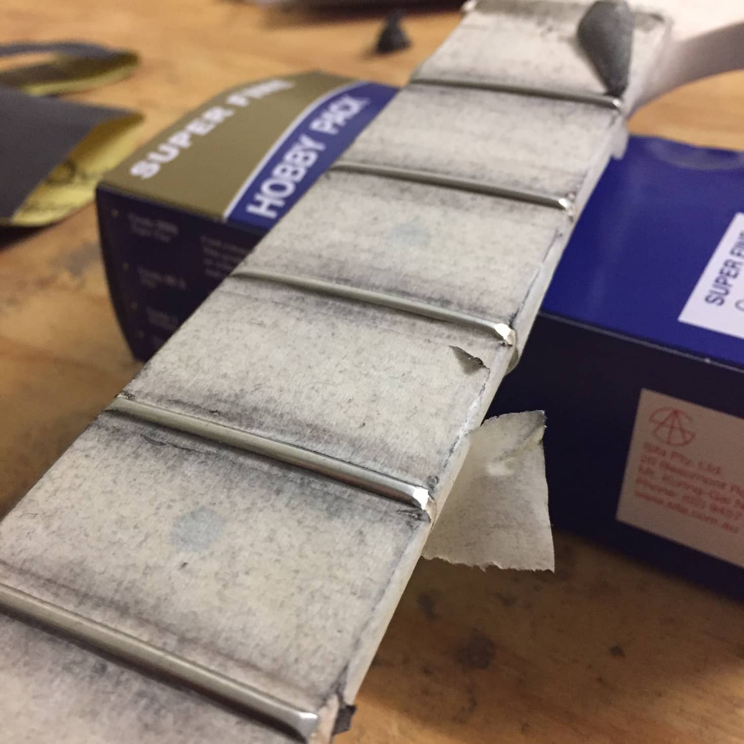

    I really wasn’t looking forward to the neck and frets but it wasn’t too bad. I got lucky with the frets, only had two high ones, they’ve polished up a treat with some 400, 600, 800 grit then 0000 steel wool.
    Onward and upward.
