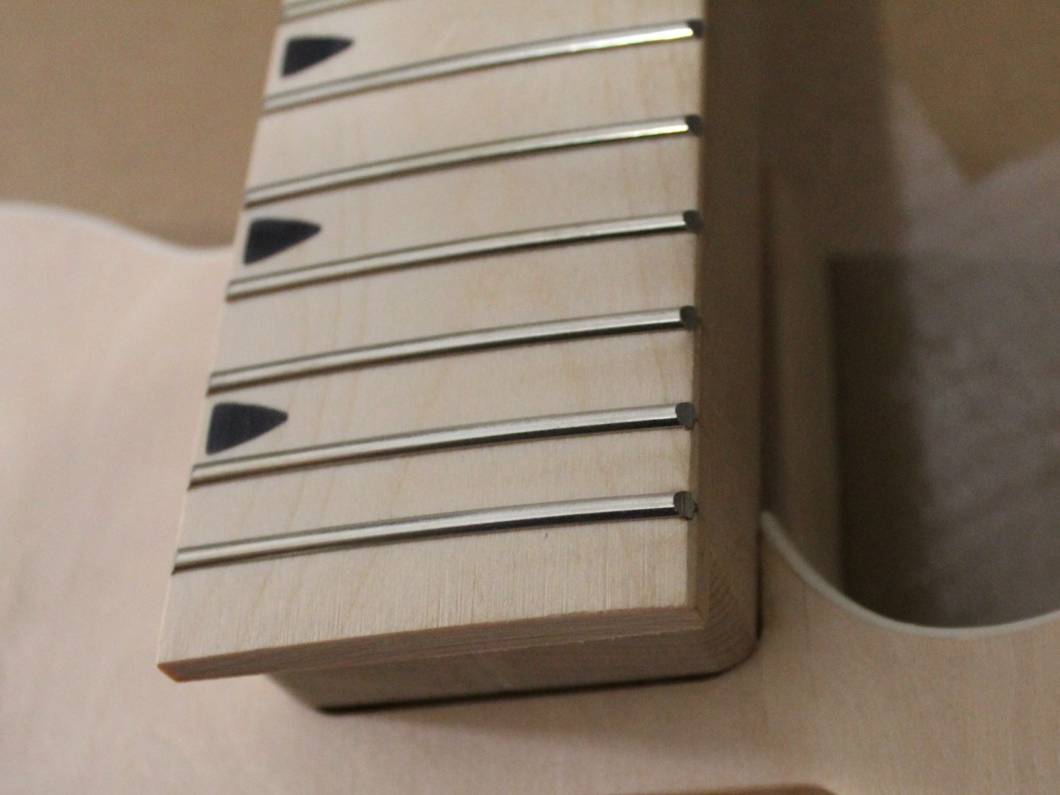

    Thanks! I am not a fan of the triangular fretboard markings are they easily sanded out?
    Not sure I’ve seen triangular ones before? But if they are inlays, the no they are not easily sanded out. They will be 1-1.5mm thick I think. Can you post a pic?
    here is a photo of the neck fit and the neck marker

    Yeah it does look like you’ll need to do a bit of sanding to get the fit right. Do it in small increments checking regularly.
    I don’t think you’d have much luck changing those fret markers (I think they are pretty cool actually). Someone else might be along with some advice for that.

    The triangular offset markers look great, I love mine. Anything but plain dots!
