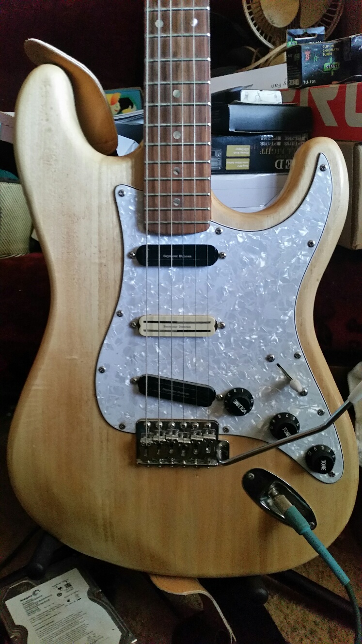

    Did a partscaster Alder HHH Strat in natural colour build some time back. Fitted it with a full set of SD rails.... Hot rails on the bridge, Vintage rails in the middle, and Cool rails on the neck. Push-pull on the 1st tone control for SC-HB switching on all 3 PU's, and an Oak 5 way switch.
    The 3 PU's cost more than the entire rest of the build combined.
    The axe has some serious output level. It spends most of its time in HB mode and position 2 that combines bridge and middle. And best of all it still sounds like a strat.... A VERY angry Strat....
