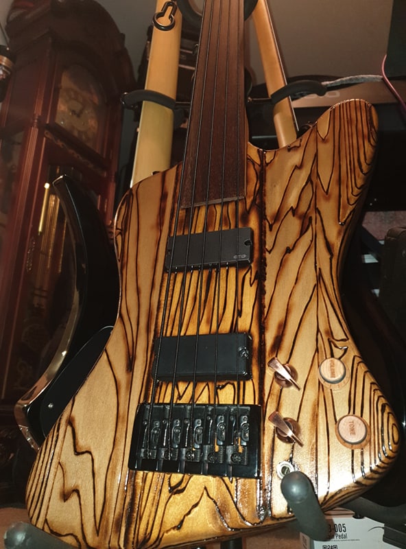

    Thank you kuanjb, fender3x, Fretworn for your advice, very much appreciated. I kept it simple and and installed 2 passive and 2 active pots with a pre amp for 1 passive and 1 active pickup in my TB-5 Bass project.

    Looks very cool

    Nice shou sugi ban finish there. I'm currently doing one of those myself which I haven't posted a thread for yet.
