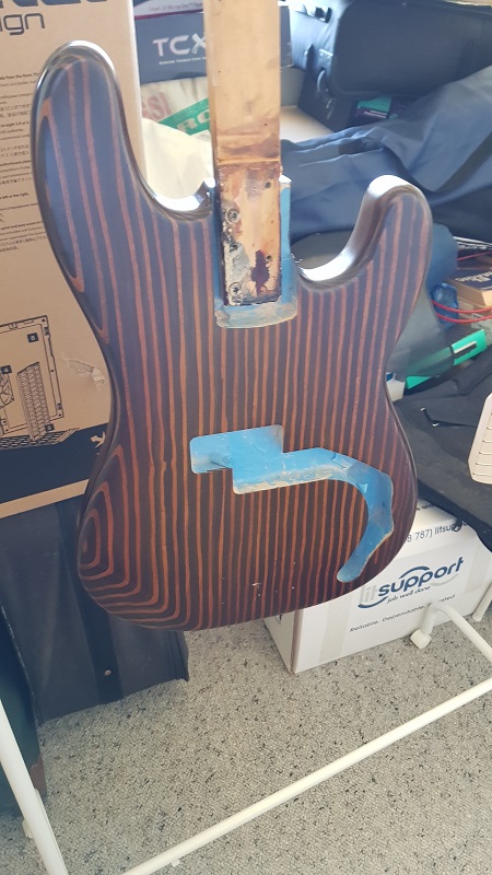

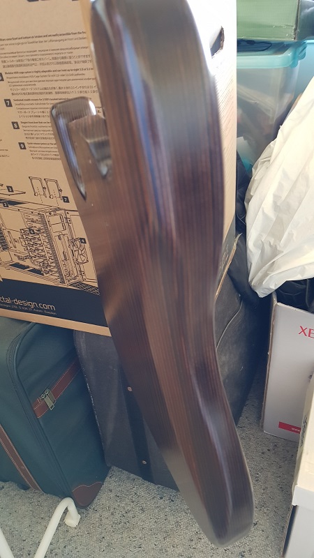

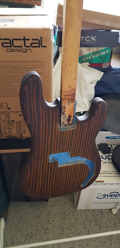

    Yesterday I sanded through to 180grit....then timbermate (Cedar/Blackwood) and then sand at 240 grit...then two coats of shellac to try and even out the stain that came next.
    This morning I took the plunge. Never ever had a good result with trying to make a burst finish. I have never tried it with alcohol based stains....always water. So this morning we have Golden Teak, Jarrah and Brown Japan prooftint alcohol based stains from Feast Watson.
    I have done one coat only...and tried to feather the edges of each colour.
    The zebrawood gives an amazing effect to the whole picture itself. I think the dark colours are looking great.
    Now the big decision.....Tru Oil or Fine Buffing Oil and Wax...which finish do I feel comfortable with? I always sand through the edges with Tru Oil....and the fine buffing oil takes a lot of the colour out as you apply it with steel wool.
    I suppose there is always wipe on poly....but when I wet sand the edges I get through into the colour often.
    Any thoughts????

    Truoil with its yellowing effect may reduce the depth of darkness you might want to highlight in the zebra wood... not sure if it’s open grain and buffing oil/wax sounds good.

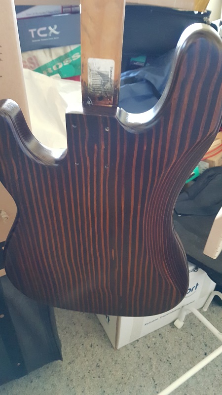

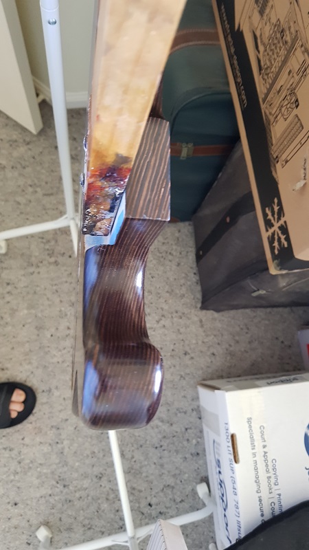

    The oiling for the win.
    I made a decision to try a burst with Feast Watson Prooftint and to use Fine Buffing Oil...which has become my go to...as the finish.
    Well only one issue...the application with steel wool does draw some of the stain colour out with each application.
    I have done two coats with 00 steel wool and then this morning a third coat at 0000 steel wool.
    I like the finish...but I do think the burst is really subtle now. Mmmmm....I don't know.
    I intend to complete the remaining coats with cloth and just rub the oil on.

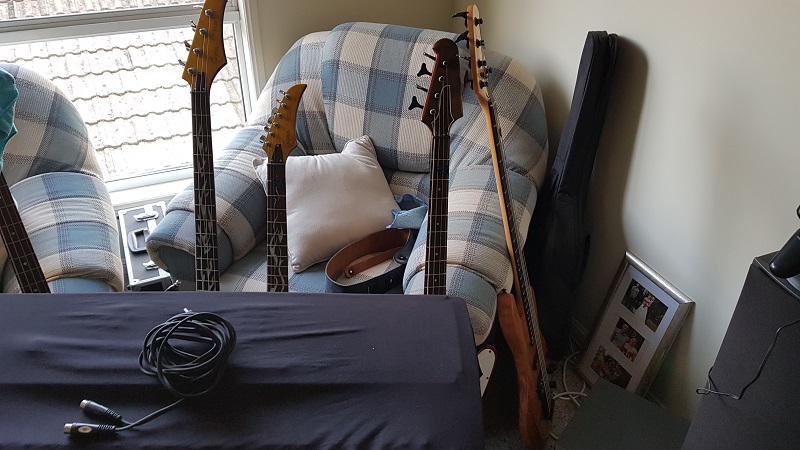

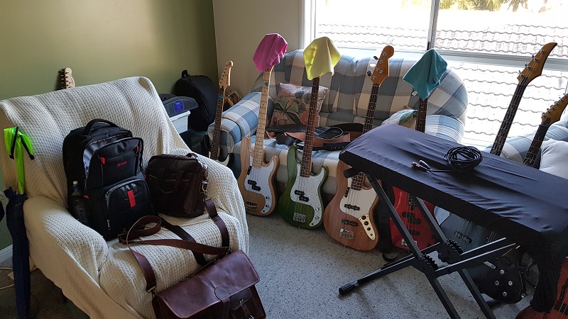

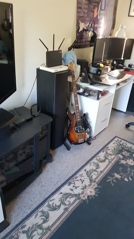

    The loungeroom this morning.
    Pick the bloke who does not live with his girlfriend.
    When she comes over she gives me heaps though.
    I have two more rooms upstairs that may or may not contain guitars in different states of construction.
    Grand total 30 basses and guitars, 1 keyboard, 1 ukulele, and 1 acoustic (steel strings).
