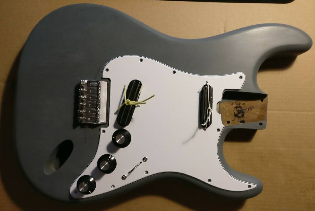

    Hmmm...second person to give this warning. Maybe I am missing something. It looks to me like the pickguard is OK, and that the holes on the pup match with those on the pickguard. Since I don't have screws yet I used some wire to test the fit. Posting a pic. I think everything lines up, but maybe you guys are seeing something I am not?
    When I ordered the pickguard I asked for it with a Tele neck pickup rout and standard pickup holes. Click image for larger version.

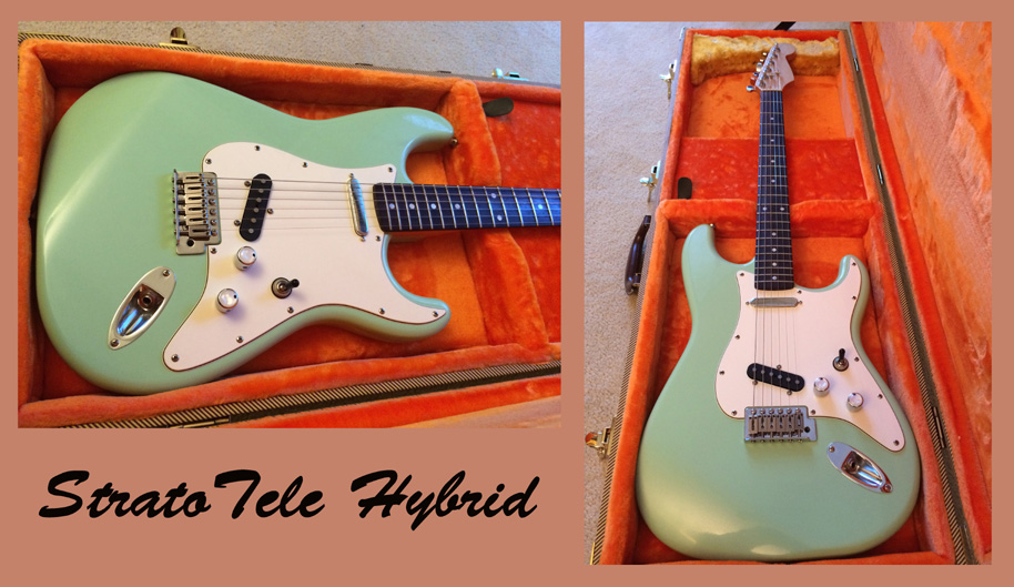

    I have a similar guitar, but with 1 volume, 1 tone. I bought a strat pickguard blank and cut the holes myself.
Name:	Strato Tele 15pc.jpg

    This is eerie, but I have paint to make mine the same color as yours. I even have a similar case for it.
    I got #6 and #4 screws, and as you predicted, the #4's worked fine. I did not need to enlarge the holes, but would have had to for the #6's.
    BTW my plan is to have just V and T pots. The middle knob is a 4 way rotary to switch humbucking and single coil modes. I thought the rotary would look more natural than micro switches. That's the plan anyway.
